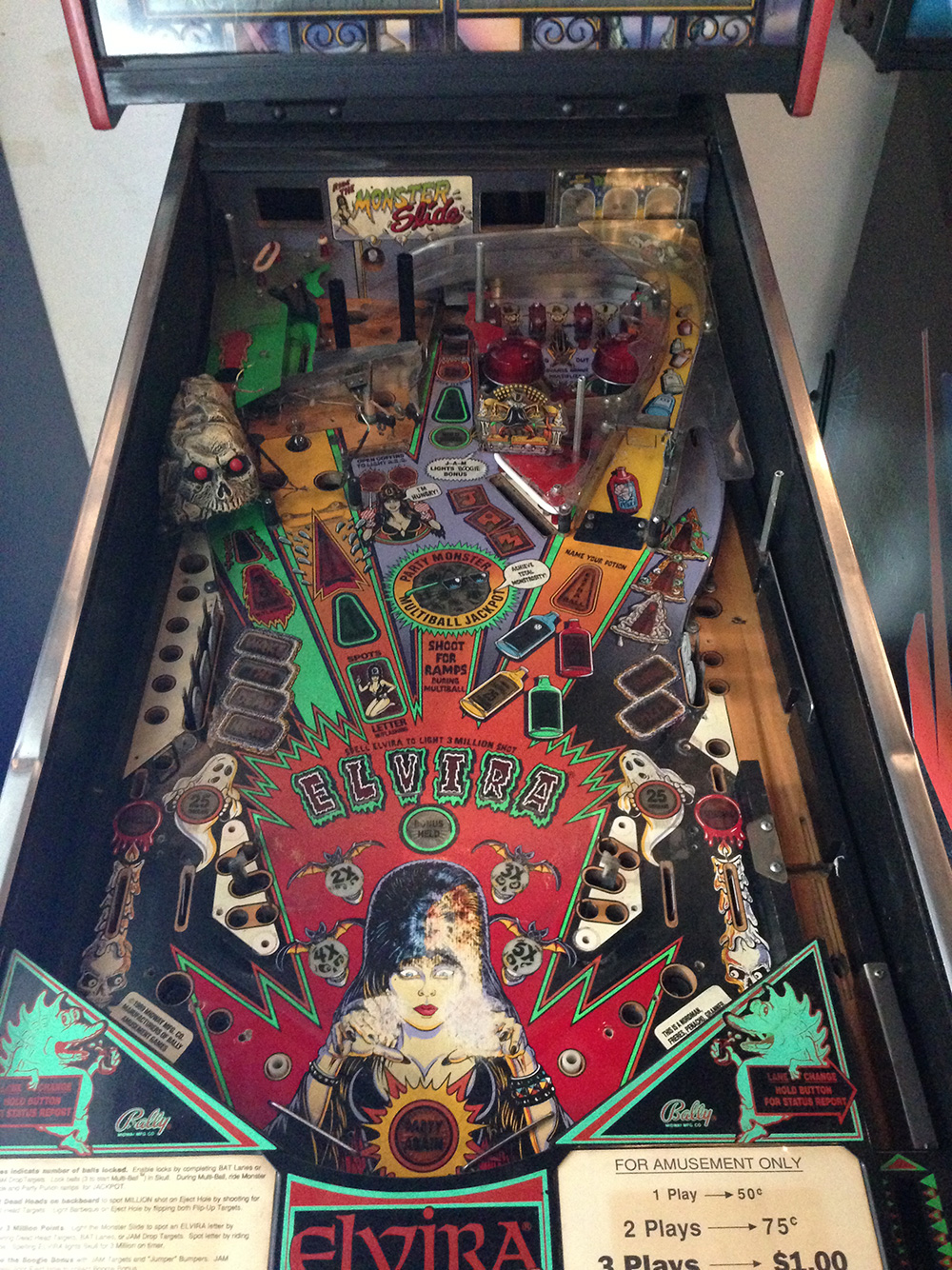

Hey guys, I finally finished my side project. :D It took 8 months and every part, even the screws, have been restored/cleaned/rebuilt, playfield touched up and clear coated etc. This was my first pinball restoration...
It was basically a junk before...
... and after 8 months of total restore ...

@Aurich I guess I've seen your restoration photos before since I remember the f**ed up face of Elvira :P
Yeah I documented on Pinside I think. I did a waterslide decal to repair that, worked great under the clearcoat it the end. I don't have the game anymore, so can't take pics of the finished result, but somewhere I have photos.
