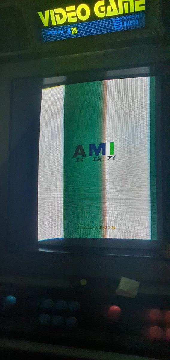

mahesak Student Joined Jul 29, 2020 Messages 17 Reaction score 5 Location Thailand Jun 28, 2024 #1 Hi My cab when start play, monotor is normal but when 5-10 minite pass, left monitor has bend. Anyone know how can I do for chassis? regards, Saad Attachments 20240628_205005.jpg 124 KB · Views: 63 20240628_204947.jpg 91.5 KB · Views: 55 20240628_204945.jpg 84.2 KB · Views: 65
aerobert Professional Joined Nov 9, 2019 Messages 295 Reaction score 225 Location Sweden Jun 28, 2024 #2 Your capacitors for geometry are old and wanders out of spec when they heat up. Replace them. If you haven't, do a recap of all when you have it out.
nem Immortal Joined May 29, 2016 Messages 7,701 Reaction score 8,413 Location Finland Jun 28, 2024 #3 You can try to adjust horizontal sync.
mahesak Student Joined Jul 29, 2020 Messages 17 Reaction score 5 Location Thailand Jun 28, 2024 #4 Thanks, will check cap for change. aerobert said: Your capacitors for geometry are old and wanders out of spec when they heat up. Replace them. If you haven't, do a recap of all when you have it out. Click to expand...
mahesak Student Joined Jul 29, 2020 Messages 17 Reaction score 5 Location Thailand Jun 28, 2024 #5 nem said: You can try to adjust horizontal sync. Click to expand... done already but when 5 - 10 minutes pass is same, bend.
