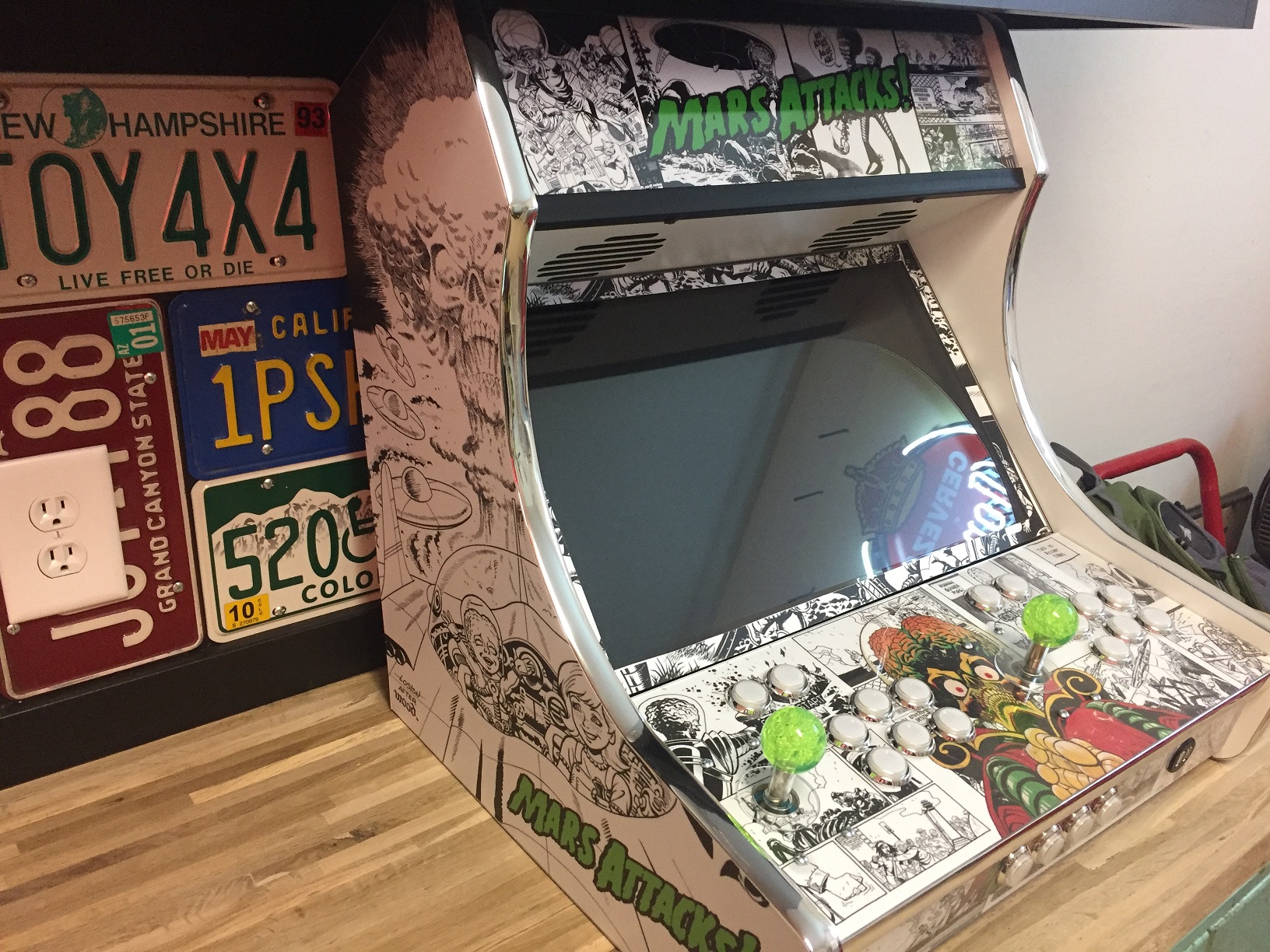

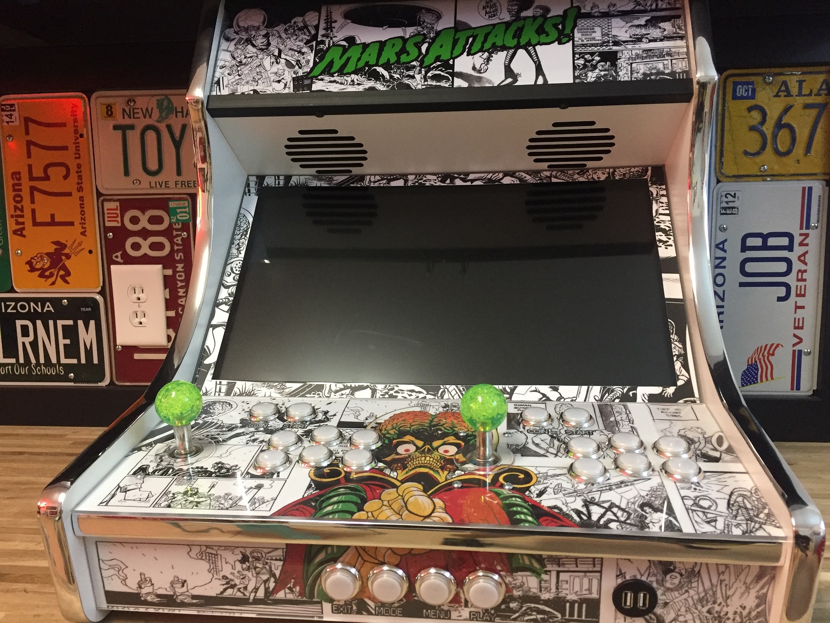

Here's an update, got the build finished and spent the last couple of days playing on it and tweaking it a bit. Had a few too many wheels for my liking so I hid some of them. Also connected a mini wifi keyboard and set up a search function to make it easier to find games. Before that it was nearly impossible to find a game you were looking for. Anyways, here is the build video condensed down to about 5 mins.
Here are a few pics of the finished Arcade!
