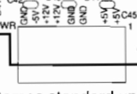

Hello, I'm having audio issues with a PR board, that appears to be related to a short somewhere. I'm looking for schematics as following traces for hours has so far been fruitless.
It may not exist, the image attached is all I can find. T-Mek uses the same board I believe, but I am running into the same issues there.
Essentially, I have no audio. The CPU passes its test (LED is lit as well), and ROM Checksums are good. I could push on the DIN 96 connector (ROM expansion connector in the image) and get sound, so I reflowed that part but now I can't manipulate things to get audio at all (though the DIN no longer wiggles). I've ordered a replacement, but doubt it will actually fix the problem. The board itself looks great, and I can't find any faults or damage anywhere.

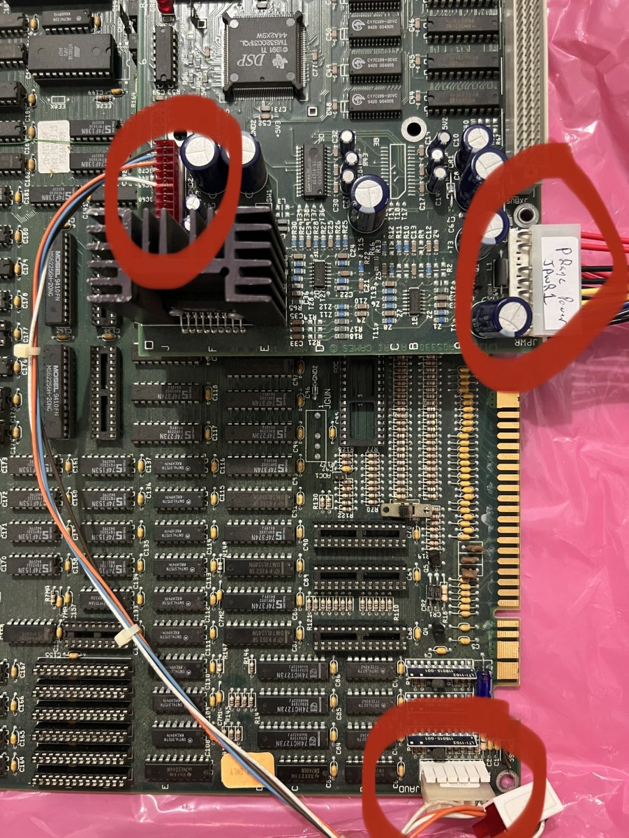

Are you just trying to get jamma audio? And is all the normal wiring correct (these two harnesses circled above)?
Yes, cables are correct. The audio was intermittent from pushing on connectors, but I can no longer replicate that. Everything is getting proper voltages as well.
My board.

I'll look closer when I'm back on a computer, but the tmek layout looks very different. The primal rage manual references a quad amp board for some reason.
The one in the T-Mek schematic is "quad amp" but I think primal rage is just 2chan. I imagine at least the ICs are similar, since part numbers in the manuals are

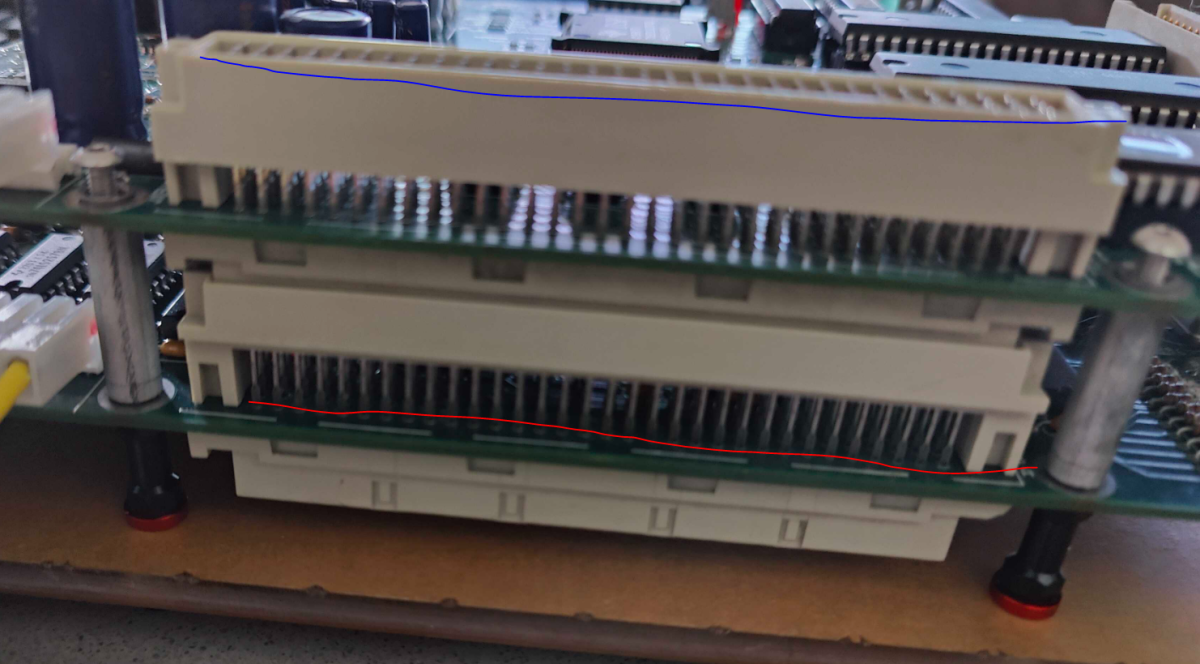

Attached are photos of both connectors. The one that doesn't connect to the main board is the unused expansion port, and is soldered to the sound board. I reworked this twice. I checked for continuity across all pins adjacent to each other, and the very middle 6 pins were all connected, but I assume via traces I can't visually inspect (under the housing) because there is absolutely no bridging on any pins. This is also the connector that when pressed on would give me sound. After reworking that no longer works.
The connector to the main board is press fit. I get continuity from the blue line to the red line, so I assume this isn't the issue.
I can't see or test anything wrong with either connector, but I can't shake the feeling the problem is with one of them. I ordered replacements just in case (I'd like to swap the one with the broken housing, anyway)

It’s on my bench now (barely fits...) so maybe I can help. You resoldered JROMBUS in PR_pins1.png? I don't think that goes anywhere, i.e. the problem is elsewhere. Maybe flexing it there was helping connect a trace on the nearby roms, or the clock.

Yes, JROMBUS is what I resoldered in PR_pins1. I think that header acts as a bridge of sorts. It has traces that go to pins. I tested continuity on all the ones I could see but think there are still traces under the housing.
MAME identifies it as a rom expansion which makes sense to me. Some games used headers like this so devs can pop on expansion boards and use cheaper eproms during development. Then they consolidate it all to a larger mask rom for production. Anyway I don't think it would bridge anything, i.e. you could probably remove the header entirely and it would function. However if there's a broken trace or via, or something bridged with solder, that certainly could goof things up.
That said, if your audio rom checksums passed, I don't think there's an issue. If your sound cpu reads OK, that's good too.

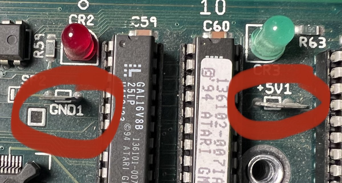

@ekorz Alright, dumb question -- where should I hook the logic probe leads to the Primal Rage board?
I'm guessing GND and +5 pins??
There are ground and 5v test points right on the sound pcb, next to the LEDs. For logic running at 5v that’s right. Set it to TTL if it has a setting (vs cmos).
For an audio probe you’d probably need 12v but I think you just have a regular logic probe right?
