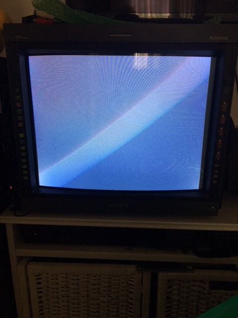

I just got my Muilti CPS2 kit set
I fowllow carefully to install it and copy all the game to SD card, after I put it back and select the game it shown nothing , I try a few game still the same.
Anyone can help, I'm new.

The screen is always blank at first until you load a game for the first time. After that this can be caused by a few things:
-The program rom pcb is not pressed firmly into the B-board
-The small interconnect pcb is installed backwards
-The B-board is not suicided yet and may need the EXC5 to be shorted (there should be no battery on the pcb)
-Incorrect files used for the games. Use the files provided here on the site.
-Bad or incompatible SD card. If it says you have successfully loaded a game try removing the sd card and then power the pcb. If the game boots the card is bad.
-B-board may not be pressed firmly enough to the A-board. Try connecting B-board to the A-board without the B-board case.
May I know how to shorted EXC5 ?
Another few step I will try to do it later today
Does it need short three pin and put back on the A board power on ? Or just take it out the b board short together there pin for a second ?
i Short the EXC5 after put it back to board try to load, it's work.
