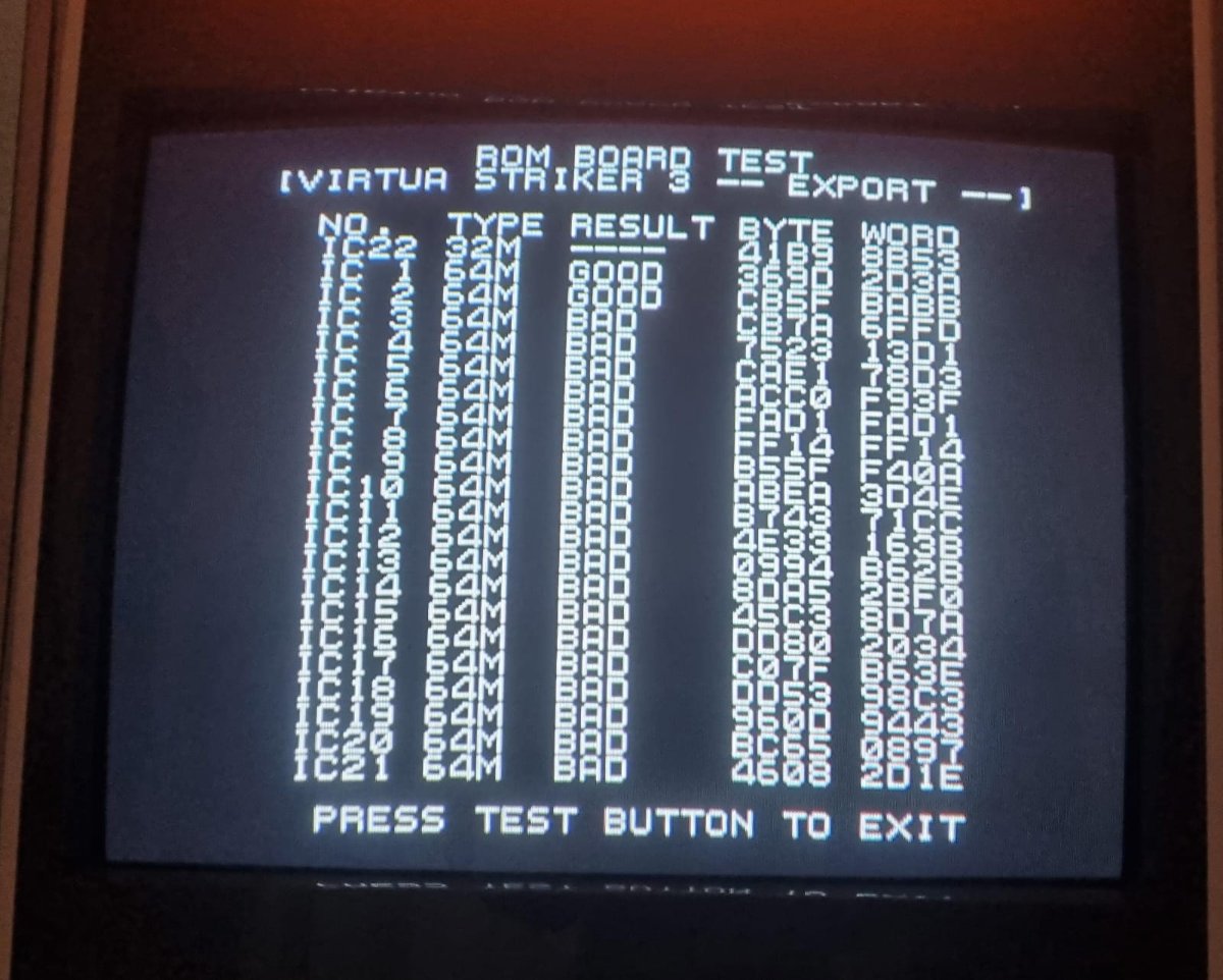

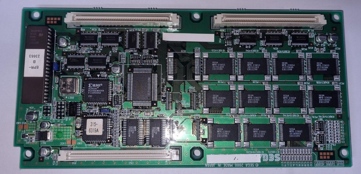

Hi everybody,
i have this game cart, virtua striker 3, in very good condition, cleaned, but doesnt work. It stucks in "system initialization" and when I do a ram test i get what you see in the pic.
Can this be solved replacing all lcx16373 and lvhc16245?
Thanks in advance.

Bad 16bit buffers, cost more to repair, than buy another VS3 sadly.
15€ 11 buffers i ordered, i suppossed was the buffers, but i dont know, i havent had this problem never.
