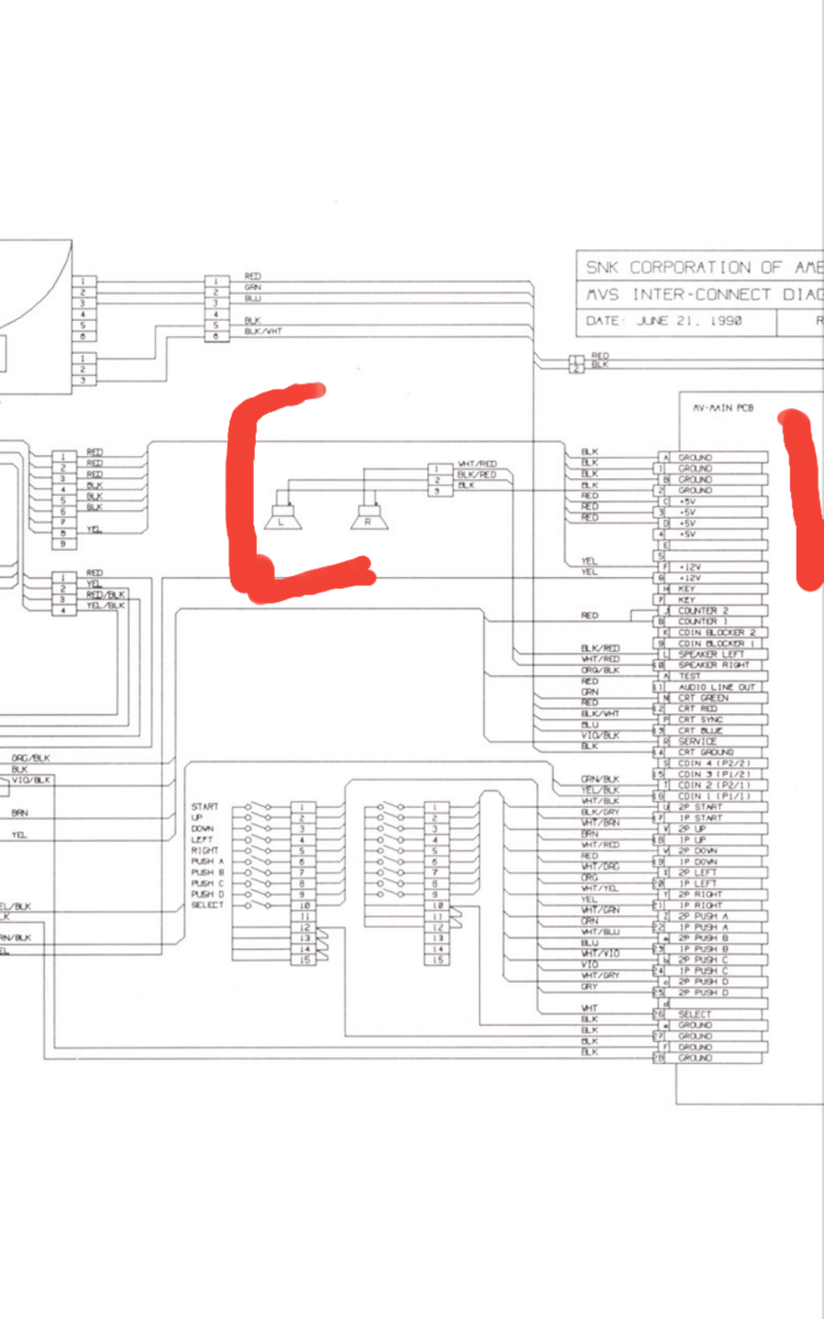

2.l noticed that on the jamma edge the left and right audio, l am accustomed to the mono connection (where the parts side is positive and ground is on solder side)
I checked the manual , from what l can tell the ground for left and right audio is coming from the 2nd ground (parts side position no.2) ls that correct?
(See attachment)

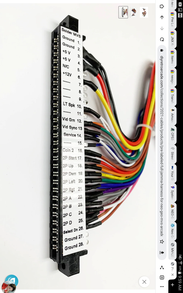

Hi, thanks for answering, l got a jamma harness which is preconfigured for the Neogeo 2,4,6 slot boards, which is known to be is different from standard jamma, eg, stereo instead of mono.
Attached is a example of the harness I'm using.l tested the test wire for with multimeter, it's working could it be something wrong with the board itself, tracing perhaps?
