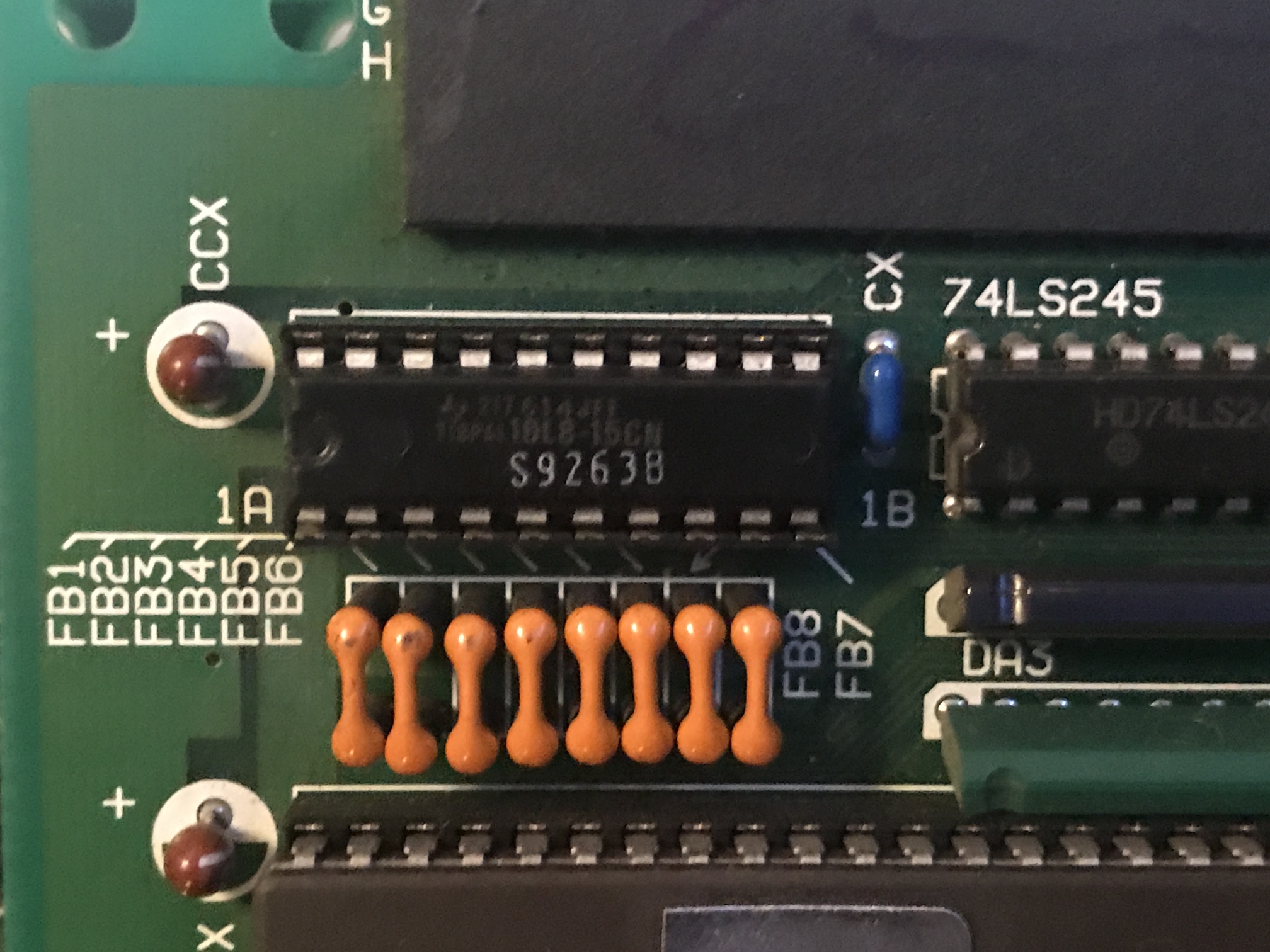

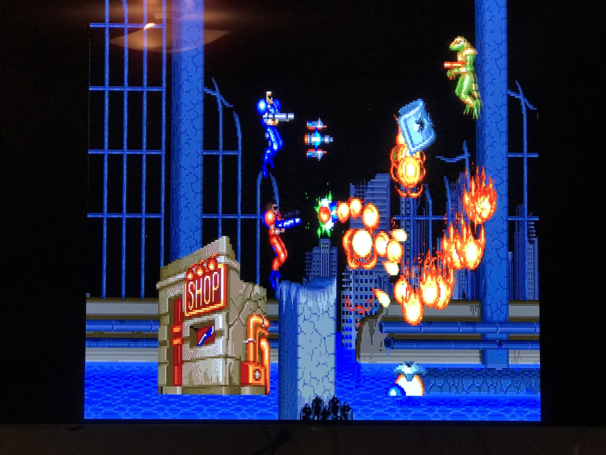

OK, with that said, here's Repair Diary #1. I purchased this Forgotten Worlds conversion board with a background problem - the character sprites would appear, but the background would only display scrolling vertical lines.
The culprit was the PAL chip at location 1A on the secondary B Board - this chip "engages" the background ROM chips. It was burning hot to the touch after the board had been left on for a moment, so it was the obvious culprit. I replaced the chip with a programmable GAL chip using the data from the equivalent MAME ROM set, and all was well.

CPS1 system is notorious for failures on two IC's : CPS-A-01 and CPS-B-21 (depending on the game).
These IC's had a high failure rate, especially CPS-A-01, so you should consider yourself a lucky guy !
The PAL@1A selects all ROM's (tiles & sprites) inteleaved , and it is possibble that only one output to one
/CS of some rom's to be bad.Also, PAL@1A is hot under normal operation, not burning, remember, PAL16L .... are bipolar in nature , not CMOS, so heat output is normal.
Have a good day, Dragos.
P.S. : looking more careful at your pics, i can tell that your PAL@1A = S9263B is from a SF2CE game, so it seems that the pal is just fine ! :thumbup:

@mr3xtraball I agree that I got lucky with this board. It helps that it was purchased as an inexpensive conversion board from Street Fighter 2 CE. Maybe the 1A PAL hadn't failed after all, and replacing it with the programmed GAL for Forgotten Worlds was the real problem all along. But the PAL that was in there got WAY hotter than the replacement-it was sizzling hot!

The PAL@1A is normat to get hot, again - its bipolar technology, as long it does its job on a SF2CE board,
leave it alone and move on.From my head, GAL16V/20V/22V uses mixed tech bipolar&CMOS, so its temp is lower, but not much.
