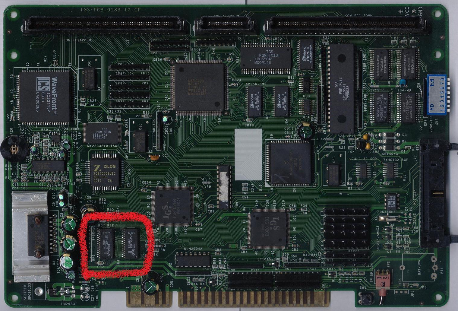

Just re-flowed the solder on these two chips and guess what......IT'S WORKING!!!
Cold solder joints all over these PGM MB's, figured what the heck. MB booted right up @5v.

Attached is the pic i was going to send you... the pic is of ram i replaced. It can be 15ns OR 12ns.. But 12ns is a better choice :-)
I was going to ask for a picture of the error before you fixed it :-)
