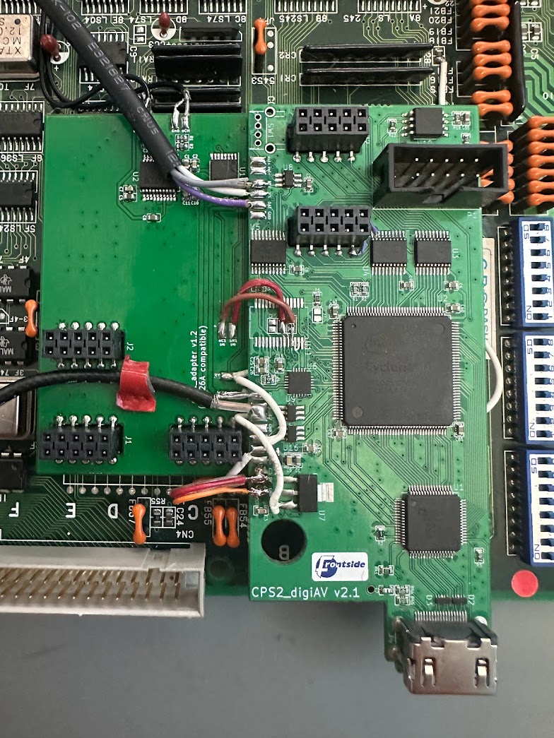

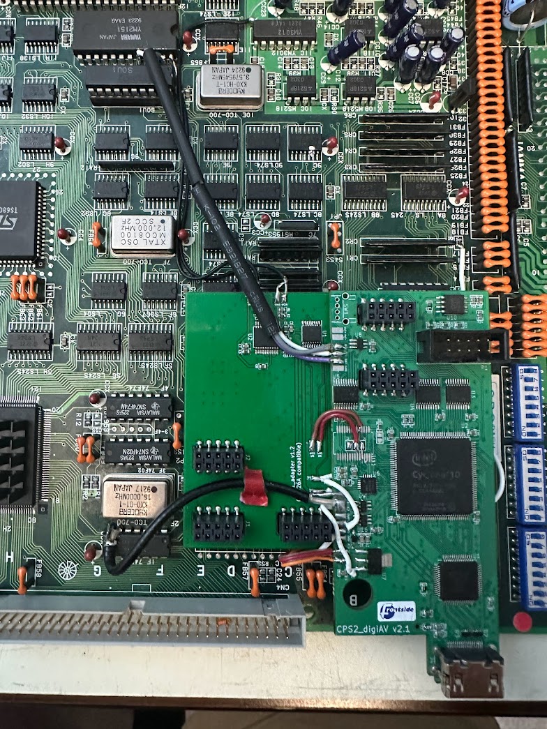

In for repair is a Capcom CPS1 arcade board with the Marqs HDMI mod already installed.

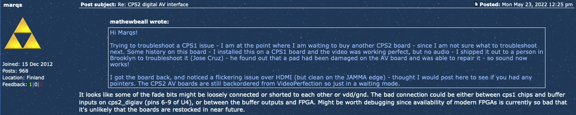

The board owner asked Marqs about the issue on the Shmups forum, and Marqs said:

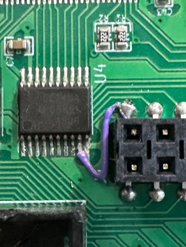

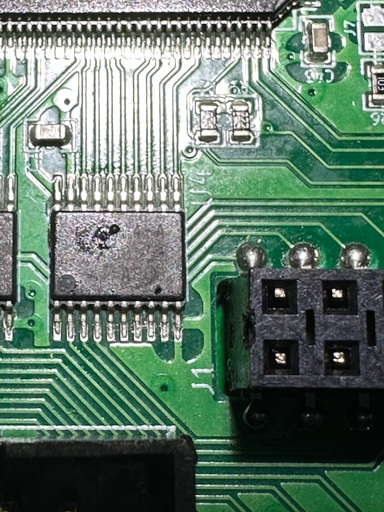

With that information in mind, I started my diagnostic by looking at Pins 6 – 9 on the U4 buffer chip.
The pin headers on the right side of U4 are connected to data lines on the CPS’s video frame buffer. The frame buffer lines feed into the U4 buffer, and from there into the Intel Cyclone FPGA.
I checked continuity on Pins 6 – 9 of U4 to the pin header with my multimeter and found a broken connection on Pin 9. I patched it with a small bodge wire.
This fixed the fading issue with the HDMI output. Here’s another video demonstrating the HDMI digital output and RGB analog output after the fix.

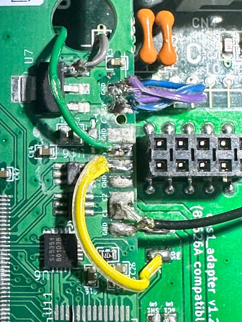

I would have been done with this board at this point, except that a good intention inadvertently ended up creating extra work for myself.
I wanted to redo some of the hookup wiring on the HDMI mod because some of the wires were fraying, and I was concerned that a stray wire strand could easily bridge over to an adjacent connection.
I redid the most severe frayed wiring with fresh wires.

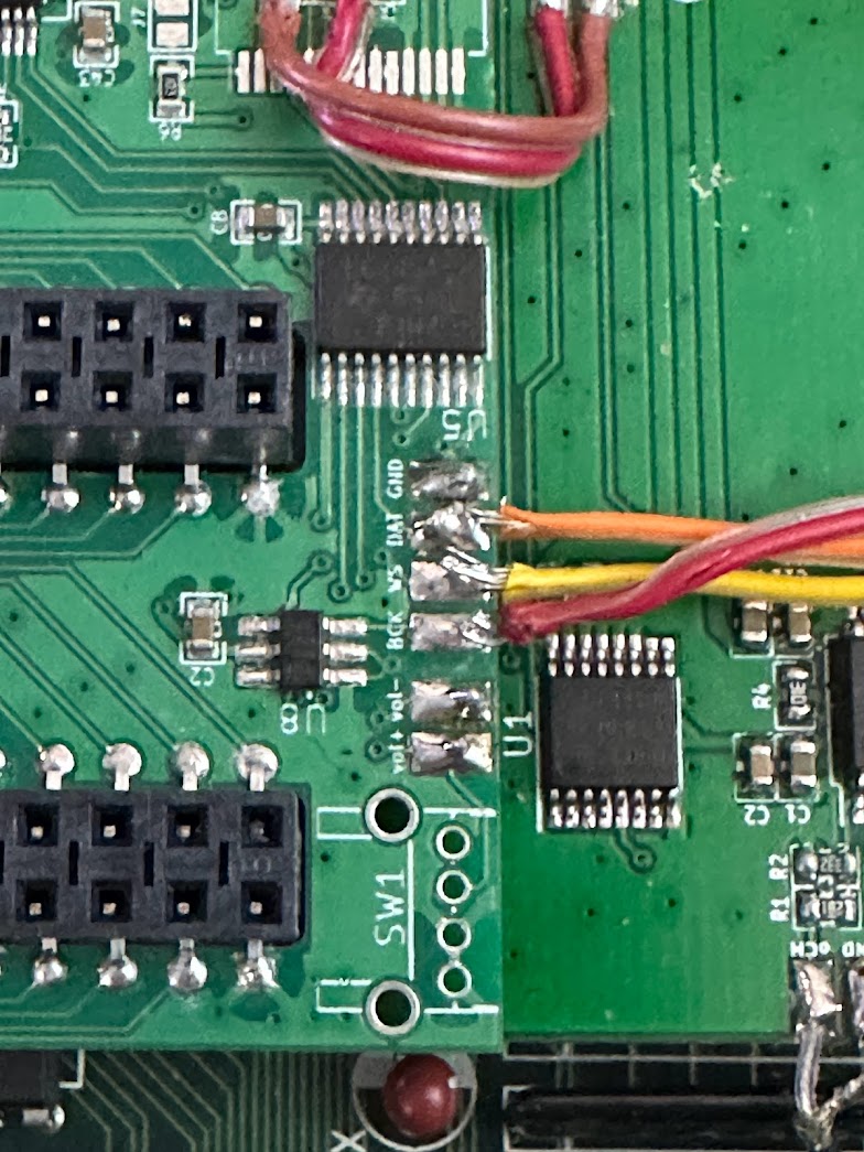

However, when testing the board again afterward, I noticed that while the analog audio was still functional as expected, the HDMI digital audio was silent.
This sent me on a run of research to learn how audio is handled with the CPS HDMI mod and which signals go where. Here is a summary of what each of the audio pins on the HDMI should read with an oscilloscope when checking for audio problems with this mod.

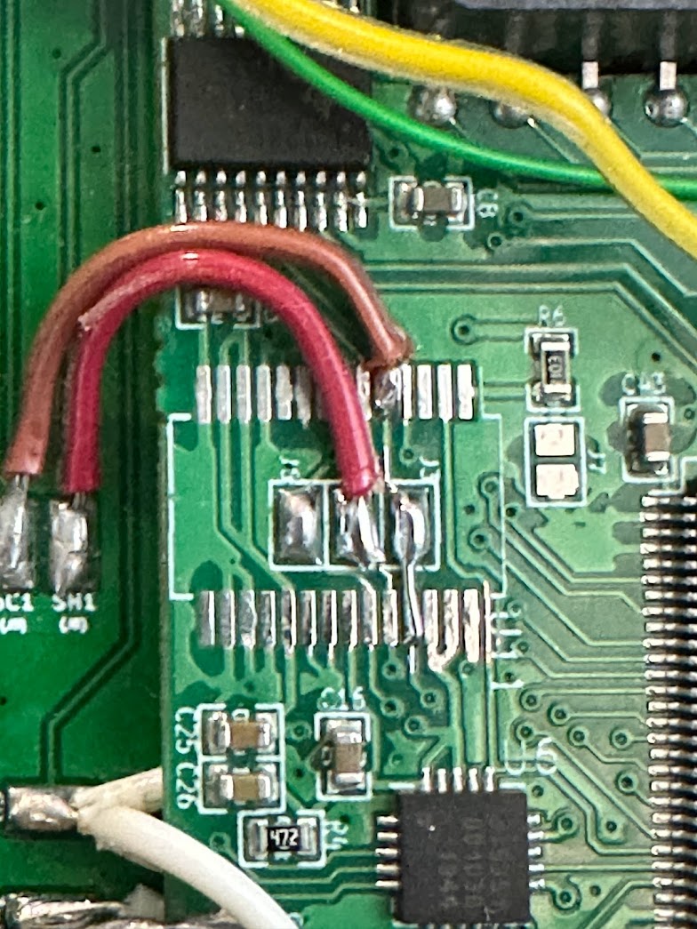

oC1 = Audio Interface Bit Clock (for syncronization) – should read 3.57958 Mhz.

Ultimately, the culprit ended up being the oC1 line – a connecting wire on top of the HDMI PCB was bridging over to an adjacent 5.0V supply pad that then pulled all of the clock signals High. Redoing the connection fixed the issue.
Final pic of the HDMI mod post-fix:
