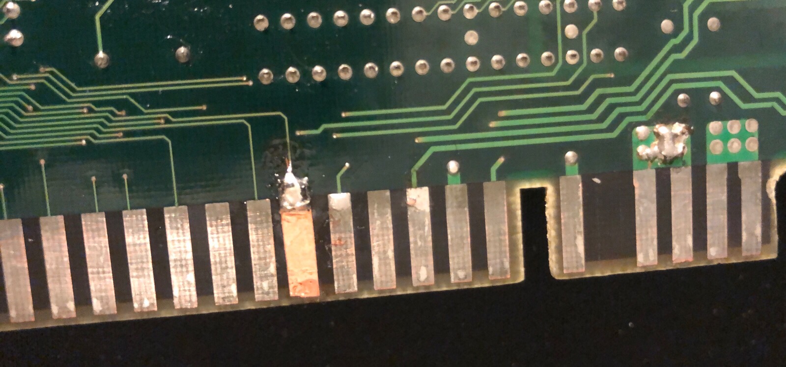

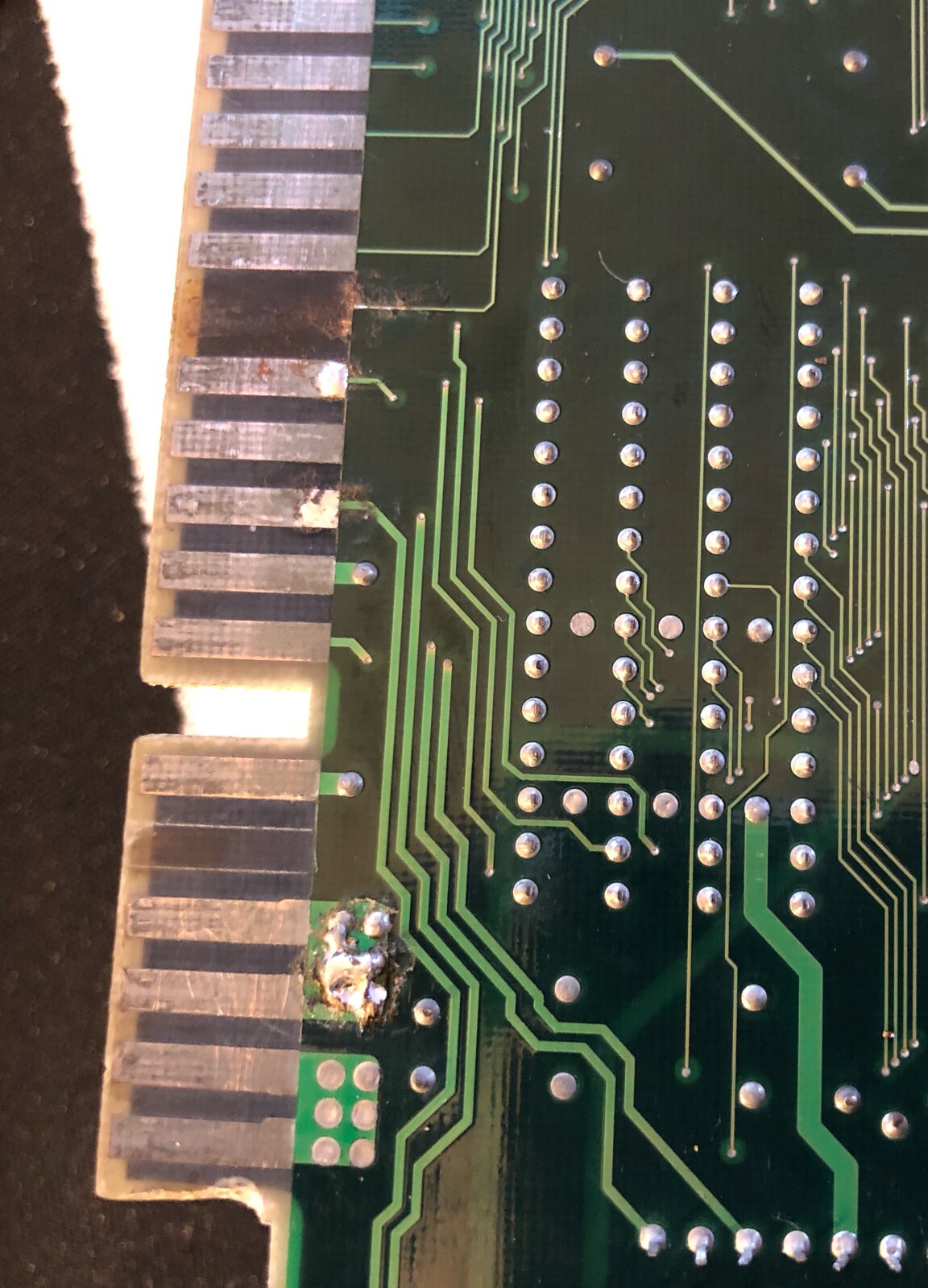

- The edge connector has a missing pad on the solder side, at the emplacement P where the Video Sync should be
- there is a blob of solder on the pinhole right beneath C and D where the 5V is (not sure if this one matters?)

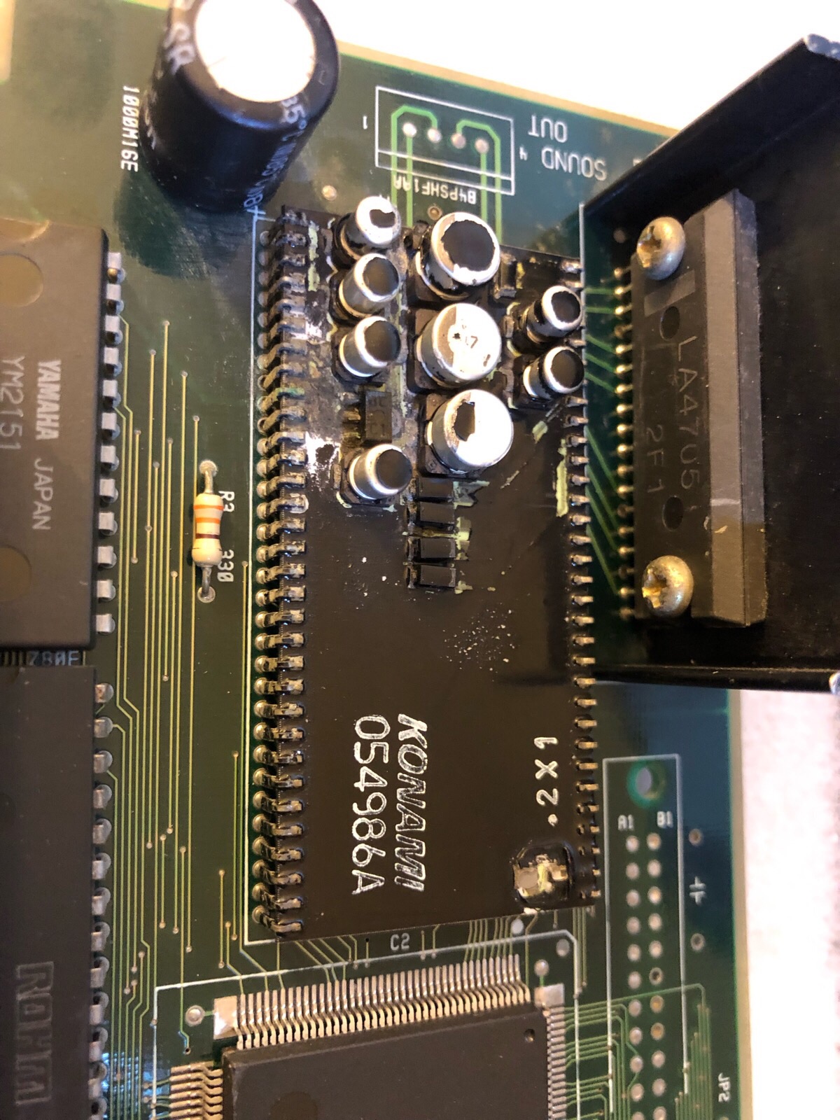

- The sound module 054864 seems to be out, probably the cap leaking as usual for those board

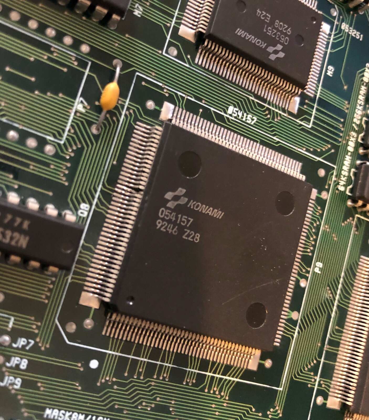

- one of the legs of the Konami 054157 IC seems to be bent inside, but a quick continuity check does not show that it’s broken or shorting with anything (seems safe for now)
My first step will be to repair the edge connector.
Any advice on connecting the metal pad to the super tiny trace? Usually it’s easy to solder on a bigger trace but that’s the first time I will have to do it on something so small
I’ve repaired the missing edge connector using conductive copper tape (cleaned the connector good, used epoxy to fix it to the board and get the very edge of it covered to prevent it to peel off).

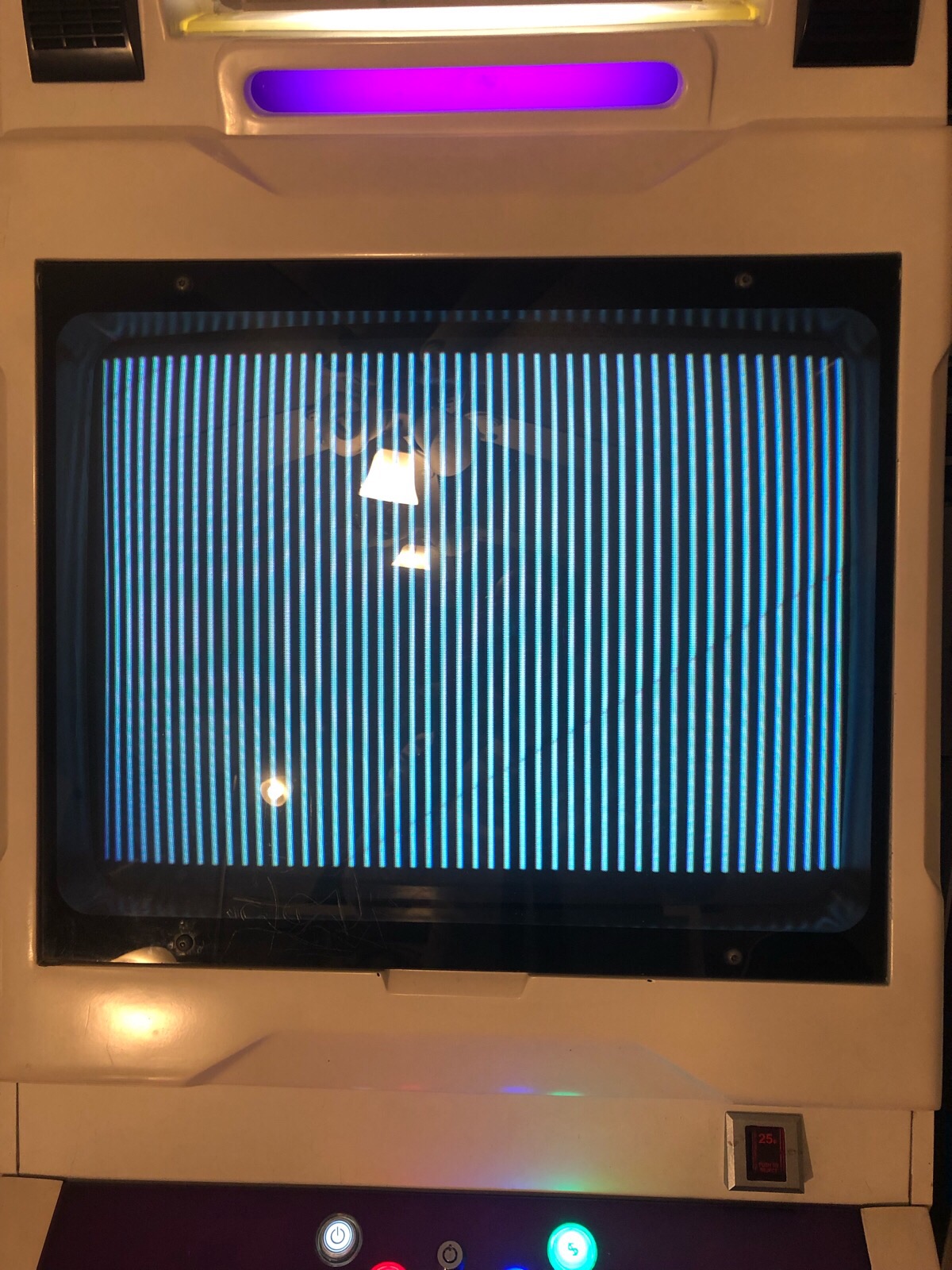

Now I finally have something showing up on the screen!
Unfortunately, nothing useful :/ just those jailbars, and eventually the board resets to the same bars, over and over again. Looks like the watchdog is doing his job.
I bridged JP1 to avoid it to reset while I troubleshoot.

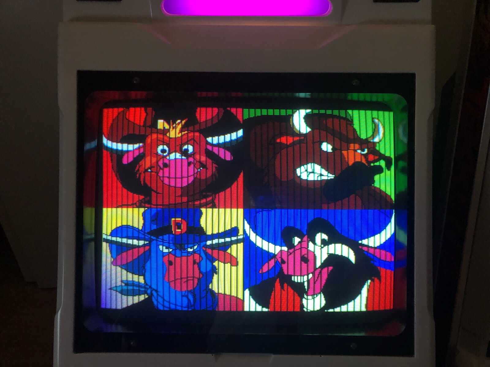

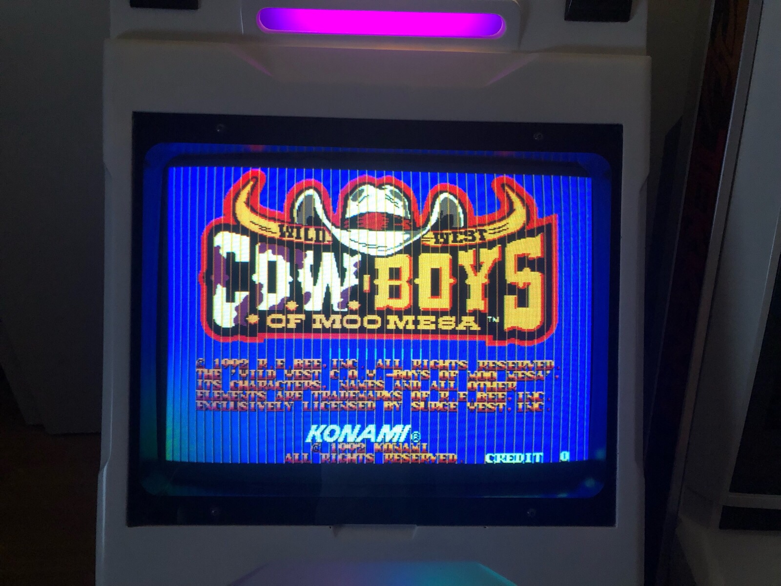

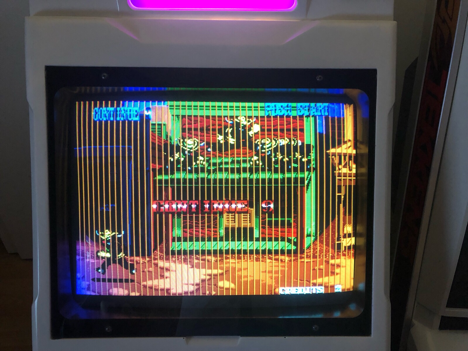

After programming an ST 27c2001 with the file, I replaced it and... progress!

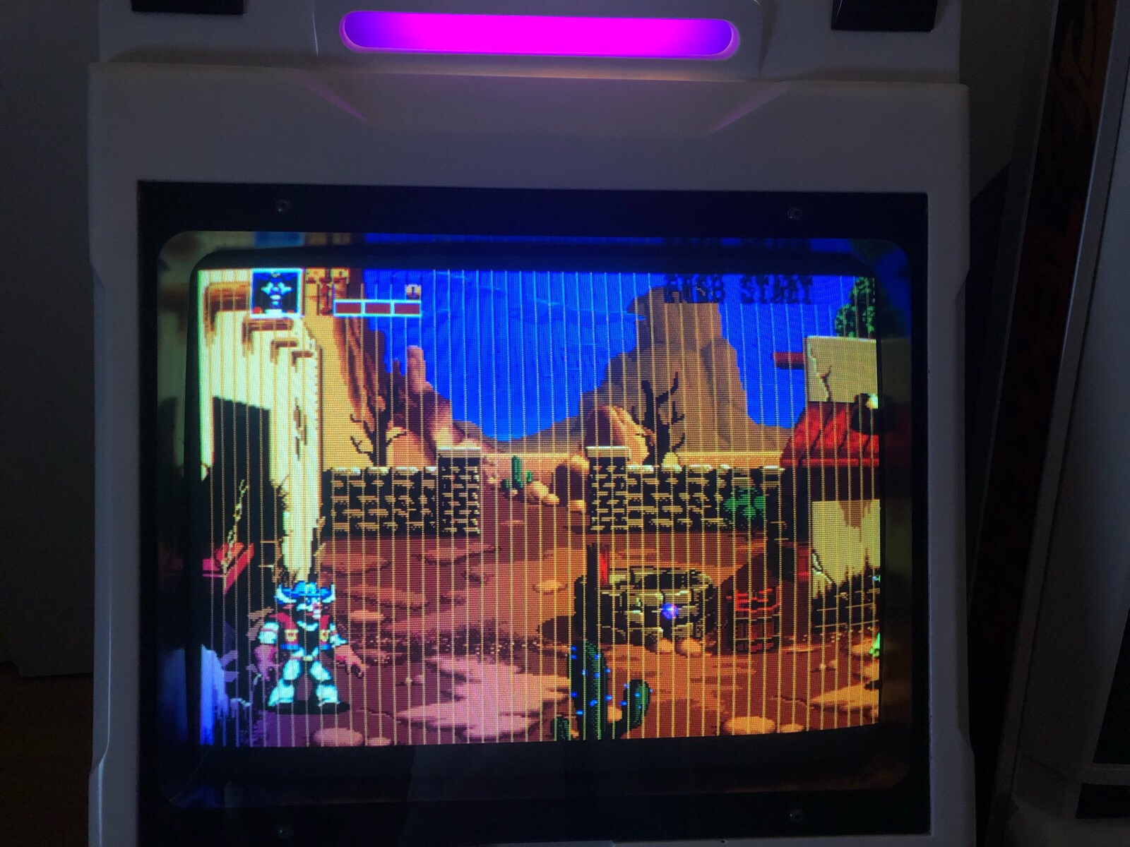

Now the jailbars are still here, and some colors are off. But the game is running and plays fine!
I assume that some ram might be faulty since the issue are with the sprites and color, need to dig deeper but still open to advice :)

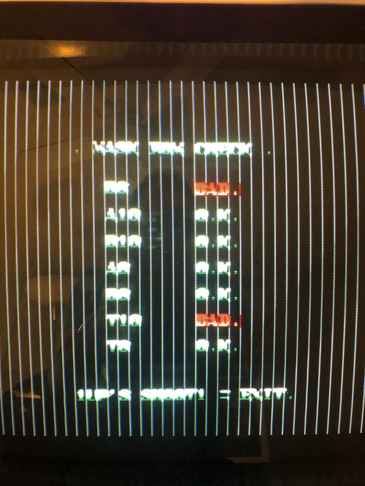

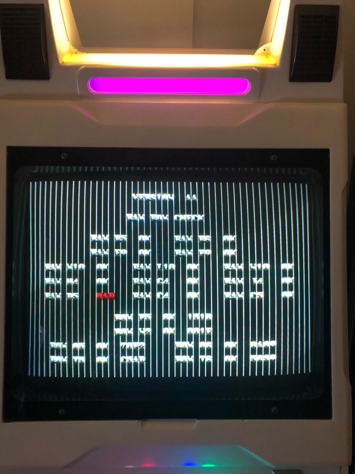

Investigation continues. Looking at the initial check and the Mask rom check from the service menu, I can see 3 reported issues:
  • B6 - Mask rom 8M/16M - ref HN624116P, the eprom equivalent is a 27c160-100.
  • T10 - Mask rom 8M/16M - ref 151A06, I assume the eprom equivalent is the same
  • D5 - 64K SRAM 150ns KM6264BL-7
I tried to program the dumps for B6 and T10 and place the eproms piggybacking on the Mask rom, but the game gives the same error during the check.
- Is piggybacking a good thing to do in that case?
I figure next step would be to try replacing the Sram, I will try to find some on ebay and see.
- Could the issue come from something else? Any advice on what I can check?

There's some repair logs for this board on JammaArcade.net written by @caius. One of the logs shows a RAM failure similar to the one you're seeing:
http://www.jammarcade.net/wild-west-c-o-w-boys-of-moo-mesa-repair-log/
So check the RAM chip at D5 for activity on all the lines with a logic probe, and try piggybacking another RAM chip on top of it if you have one.
As for the B6 and T10 ROMs, I can't speak to that specific board myself, but here's some general advice. As I understand it, I think piggybacking only works for mask ROMs if the original ROM is still storing data correctly but has failed internally on one or more pins. If the mask ROM is still active internally on all pins but is storing corrupted data, the data retrieved when the board asks for it will be scrambled with a mix of both the wrong data from the bottom mask ROM and the correct data from the piggybacked EPROM - resulting in a failed ROM test for the piggybacked ROM even if all the circuits are all working correctly.
I suggest that you use a logic probe and check each mask ROM for activity on the address and data lines - one of them may be floating (disconnected) or inactive (held high or low - note that ground is always low and Vcc is always high).
If you find a floating line, check the board for a break in the circuit trace between the floating ROM pin and its source - use the continuity setting on a multimeter to verify a good connection between the two.
If you find an inactive line, trace it to its source - it might lead to a TTL chip. Sometimes TTL chips are used to handle addressing, and a fault in the TTL chip can cause incorrect addressing and the ROM test will fail. If the inactive line traces back to a TTL, try piggybacking that TTL with a fresh one. If the piggybacked TTL works correctly, desolder the bad TTL, install a socket, and install the good TTL into the socket.
If a floating or inactive line traces back to a SMD CPU or graphics custom chip, try lightly pressing down on the chip and see if the issue resolves - the SMD may need to be reflowed.
If all the lines on the mask ROMs show proper activity, the ROM may have failed internally - very common with Konami mask ROMs in my experience. Desolder it, install a socket, and then install a programmed equivalent EPROM in its place.
Hope this helps.

  • I removed the Sound module that not only had leaky caps but was broken as well (kept a broken part with the asic from it, having a hard time to remove it from where it's soldered too though - might be useful for a replacement module later). I intent on replacing it by one from a faulty Martial Champion donor.
