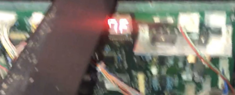

Hey guys just got my daytona steering FF boards and everything else that was requires repair
hooked her all up now not getting feedback on either before we took out had half assed feedback on one and none on the other steering works just no feedback
showing error 7F then once playing goes nuts like the matrix code lol anyone know this error?

This is Daytona 1?
So it semi worked before and now after 'repair' doesnt work at all? who did the repair, have you spoken to them?
You wont believe the problem haha we had a missing cog and the belt was off
I suspect we got charged repair for nothing ..
All good tho its running great now
I have the exact same error on my Scud Race Cab but its not 7F, its 0F ;) .
So you fixed it by disassambling the steering cockpit from the backside and a gear had a missing cog and because of that the belt was off ? How did you fix that ? Replaced the gear ?
