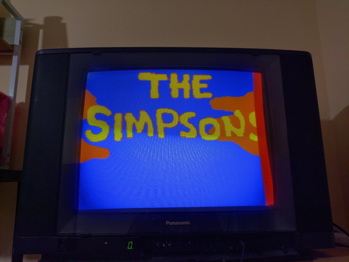

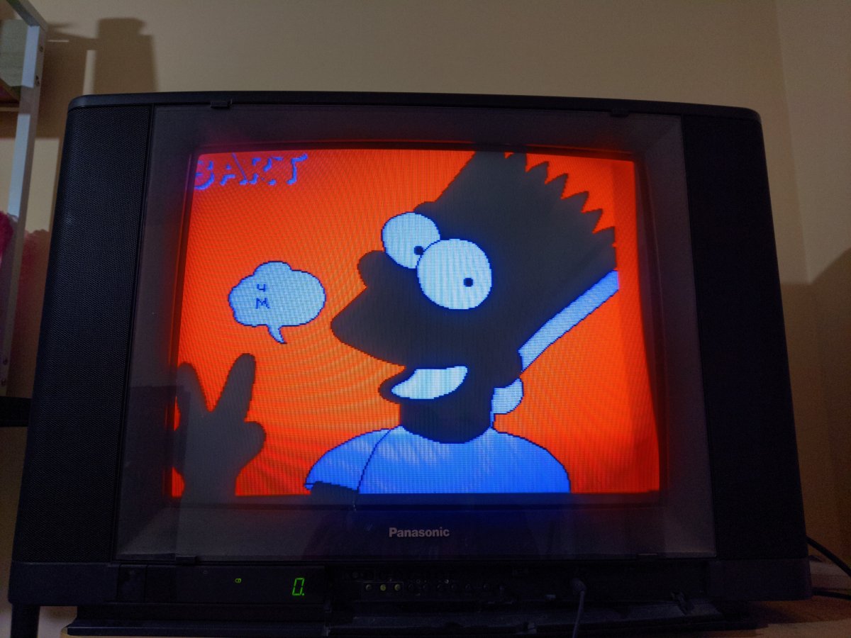

Hi, I am trying to repair a partially broken Simpson board. It has the error of not showing good the palette colors on tiles. The sprites are drawn correctly.
Checked the palette rams, the 3 x LS157 near the 053251 custom and 053251 itself replaced. Where should I go check?
Could they be the culprits the 2 customs in charge of the tiles' section?
