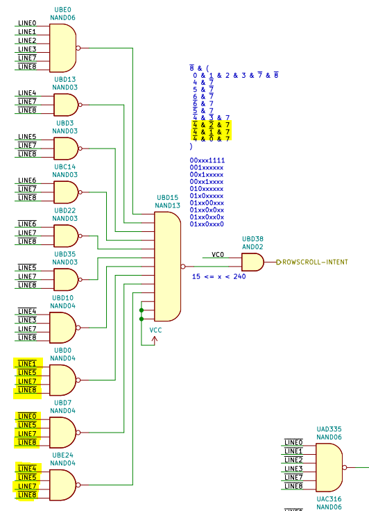

The real work was in fact converting the 83 page schematics provided by @WydD to Verilog (or any other HDL langage used by modern FPGA engineering tools).
And so it begins...
I'm only getting started, fully realising the mountain of work before me, but hey, you have to start somewhere.

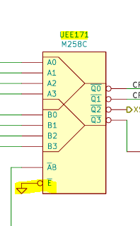

The schematics have been fixed. The comment and binary pattern was right, I have no idea how I made that mistake, that's weird.
I took the opportunity to finally fix the CI pipeline so now it's will immediately publish new svg/pdfs whenever I need to change something.

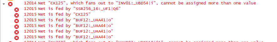

Upon first compilation I got this:
Turned out some cells used by Loic were missing from Jotego's library, namely L4LH, M175C, M175CL, AOI24, OAI22, MUX24GH, M175CLH, AOI32, HA1, FA1, FA2, MUX42H, SSR256_10 and SSR256_16.
I created them all and compiled again...
Got many, many more errors and warnings
