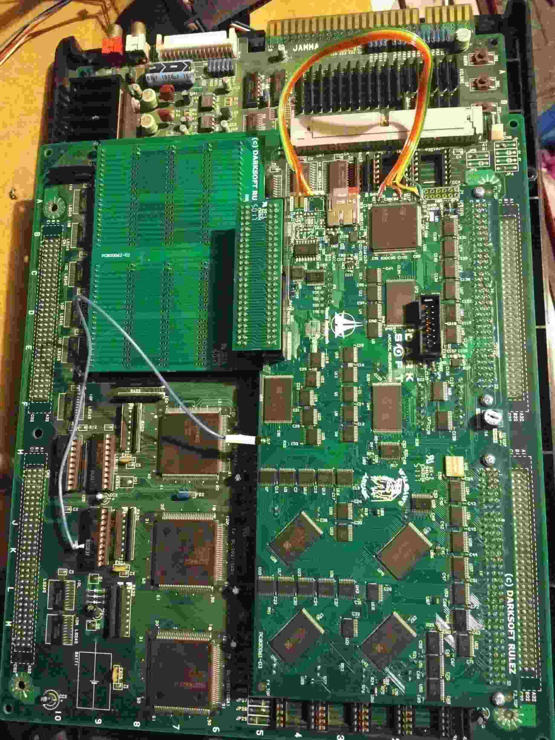

It could be the custom chip on the b-board that is bad. I had that issue. Test on the new b-board and see what happens. You should also post some pics of your current setup so that we can see it.

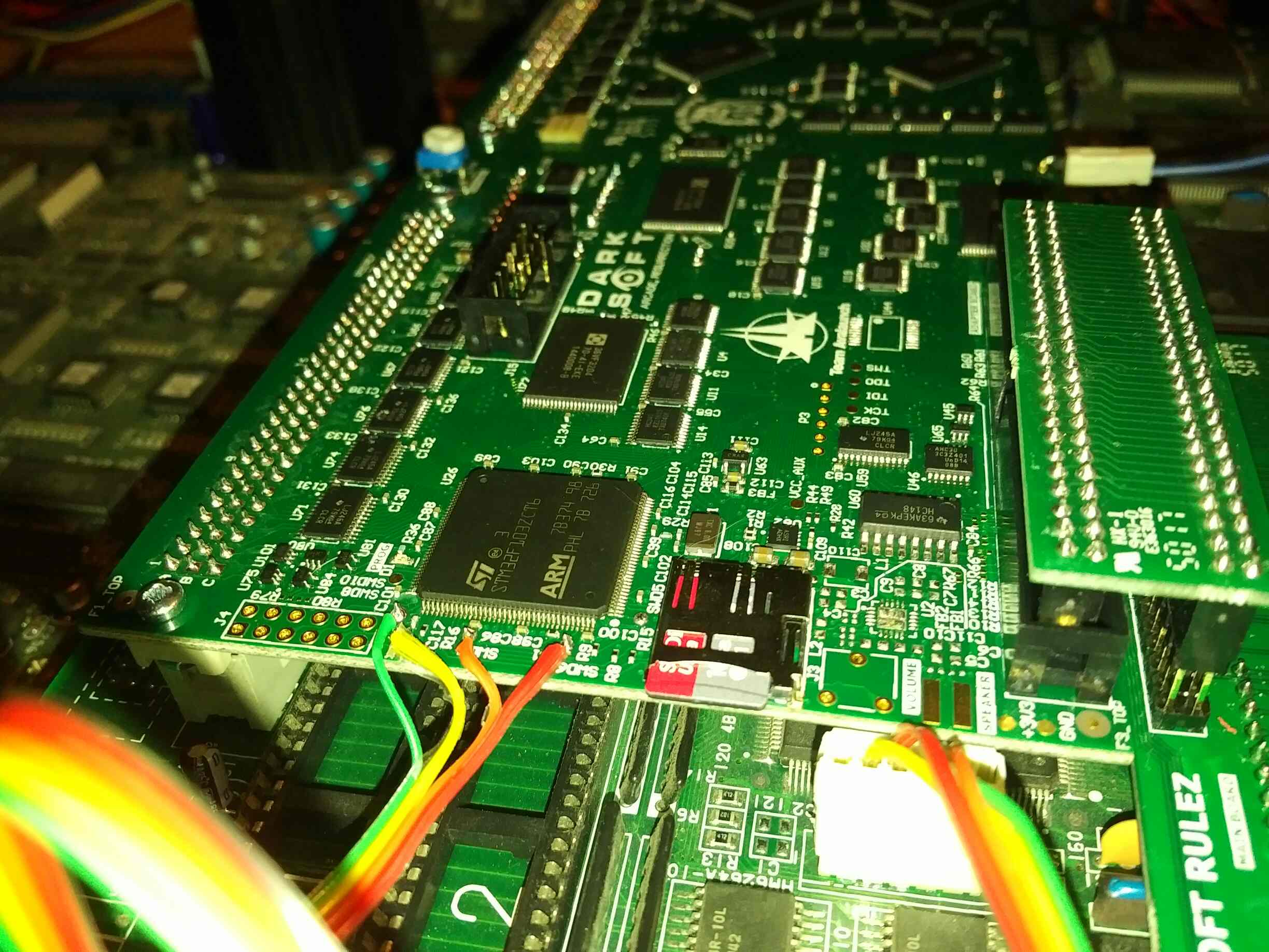

If so, just an FYI, some of the jumpers are bridged by traces from the factory... not solder, so you'll see the two half circles with a tiny hair-line traces connecting them and you'll need to cut that trace if the jumper is supposed to be disconnected. It's best to double check jumpers by actually metering them out because even a cut-trace could still be making some contact if it wasn't cut deep enough.
I see this trip up a lot of people the first time they install a kit as this often looks like an open jumper on first glance due to the lack of solder.
It is my first CPS2 and my first multi for it.
I have cut traces where needed and soldered together the jumpers per the instructions, and tested all with my multimeter. I even went back to all cut traces and dug them in a little deeper, even though they already registered as open.

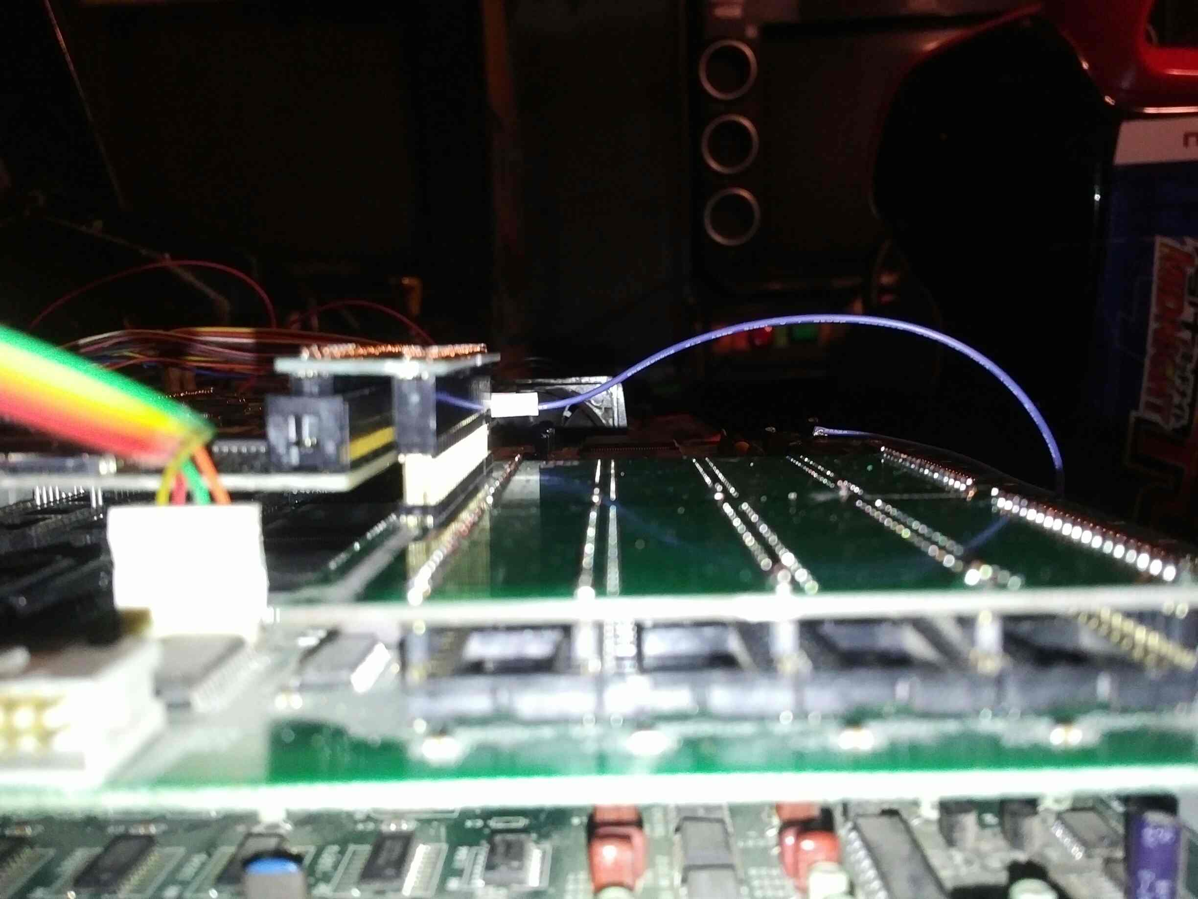

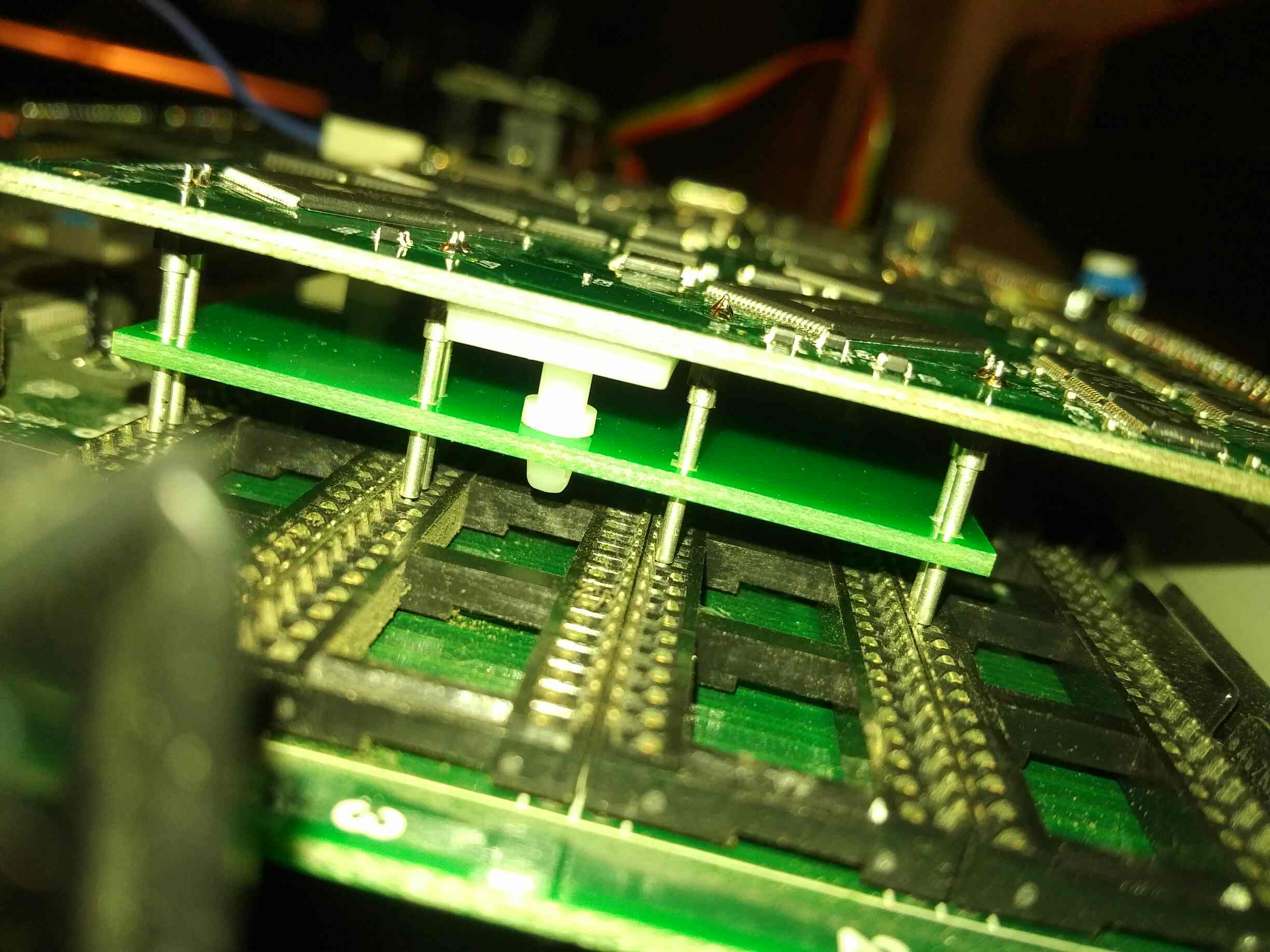

Here are a few pics.

Is the small bridge board pressed down securely? It's hard to tell in your photo, but it looks like it may not be seated down onto the pins sufficiently.
It did need to be pushed in a bit more after the most recent re-installation attempt, but the issue remains even after ensuring it's seated all the way down.
Let's see how it behaves with the new B board then. Your installation looks correct from what you've described and what I see in the photos. You may have had a bad B board to start with.
