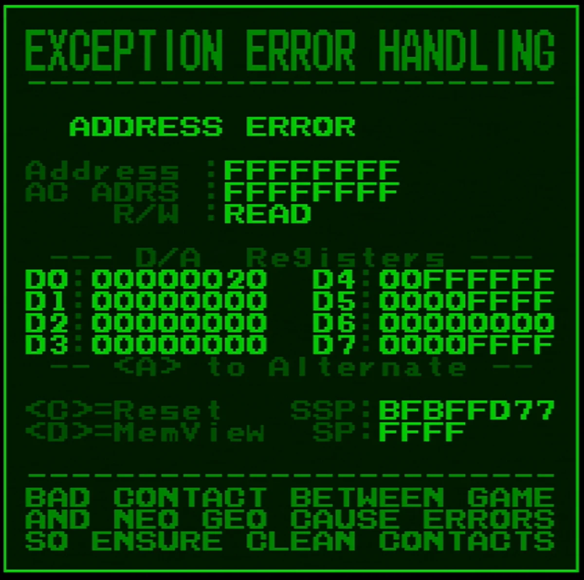

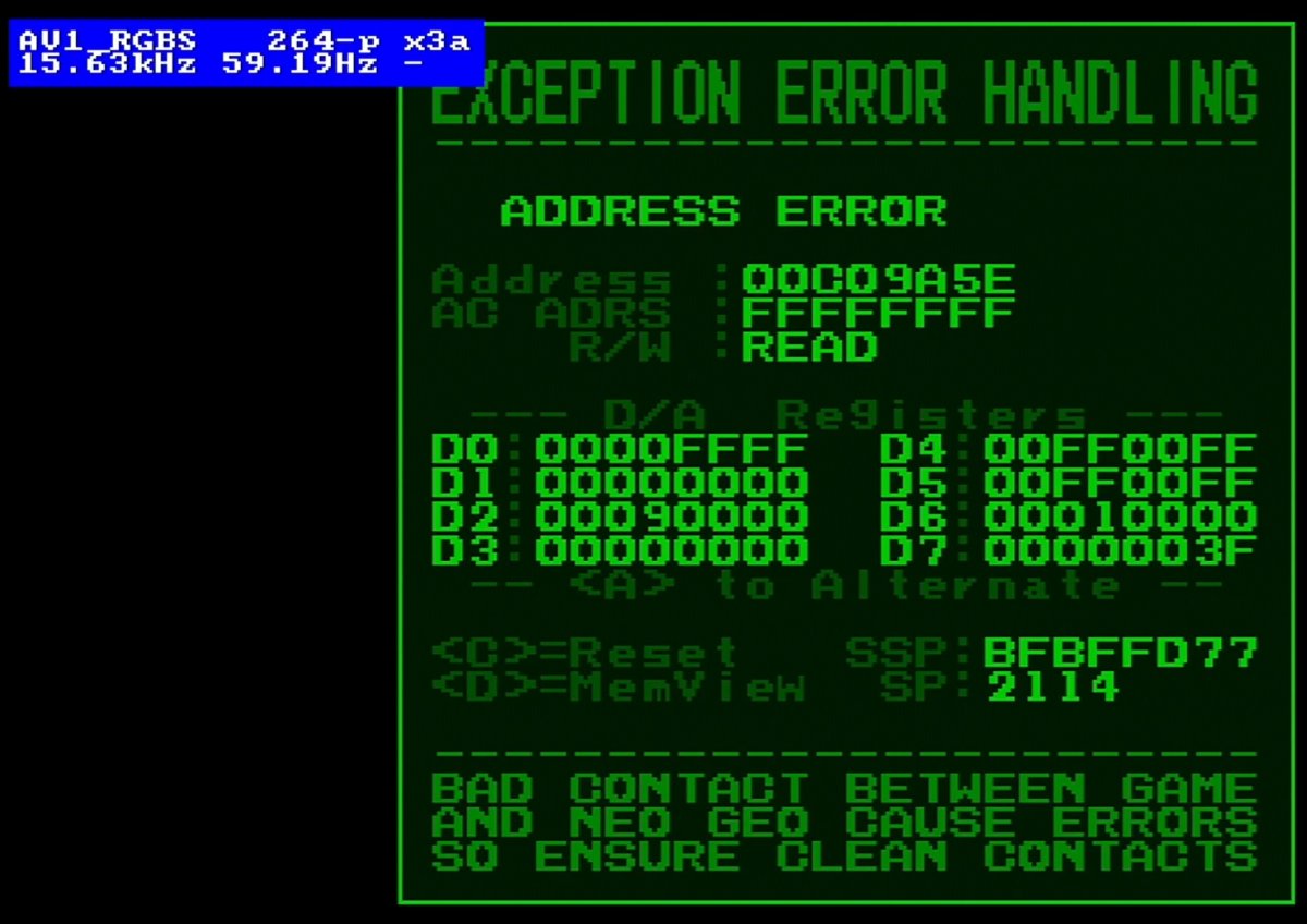

  • Without a game, the unit boots immediately into an "EXCEPTION ERROR HANDLING" error (attached, has the blue box from my OSSC pro still visible).

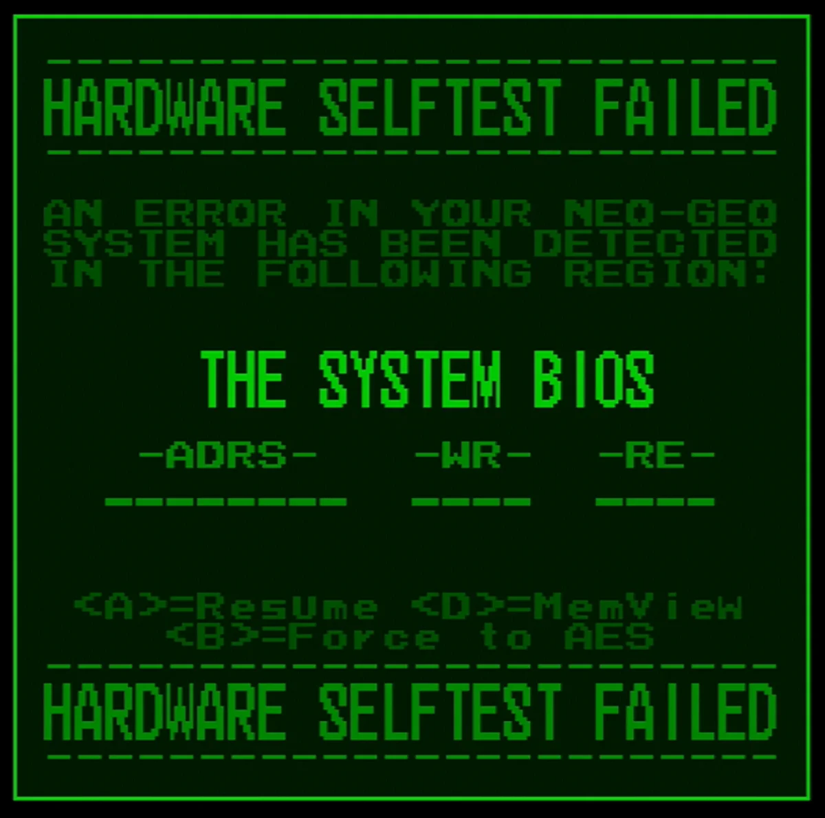

After seeing the error, I removed the top board and replaced the new BIOS with the original BIOS chip it came with. I then replaced the top board, and attempted to power on the unit. Rather than booting, I received an error (attached) indicating "THE SYSTEM BIOS" was the issue. I then powered off the unit, and I removed the top board from the system once more.
With the top board removed, I tried once more to boot the system, attempting to at least arrive at the system menu/test screen. It does not boot. The system behaves two different ways with the top board off, depending on the BIOS chip installed:
  • If the old BIOS is installed, it fails immediately to the "THE SYSTEM BIOS" error.
  • If a new BIOS chip is installed (I've burned off 2 different ones now, and verified them good in another unit), then the system black screens for several minutes and eventually pops the third error (attached, doesn't have the blue box on it.

The black screen is a bug in unibios 4.0 that can happen on multi-slot boards. In general I would advise against using 4.0 on multi-slot boards as there are other issues (ie audio breaks). I think most folks suggest using 3.2.
unibios does a crc check of its own rom at bootup, if that fails you will get the "THE SYSTEM BIOS" error. Given that and the other crashes I suspect you might have an address line issue between the bios chip and cpu. If you have a logic probe you could try probing all the address lines of the bios chip while the board is powered on and make sure none of them are dead. Additionally you should also try the diag bios as it has specific code for checking the upper address lines of the bios.
