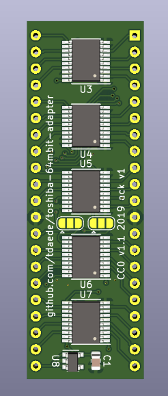

Luckily the awesome Tdaede considered this problem a long time ago and solved it with this adapter. Takes super-cheap 3.3v flash, adjusts the voltage, translates the addresses, its a technical work of genius.
https://github.com/tdaede/toshiba-64mbit-adapter

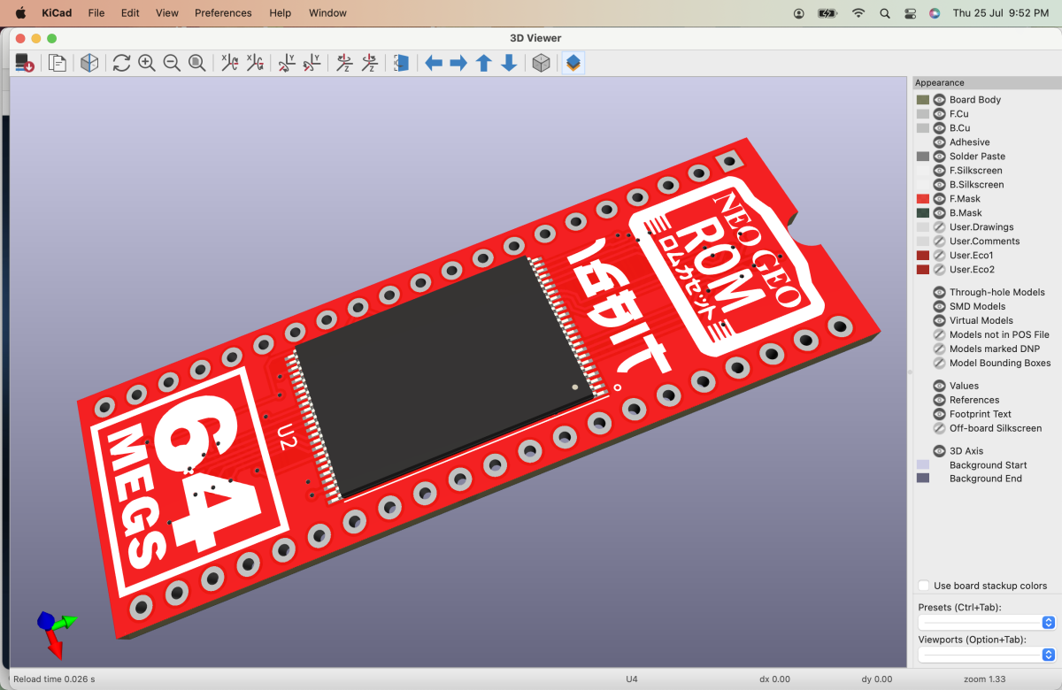

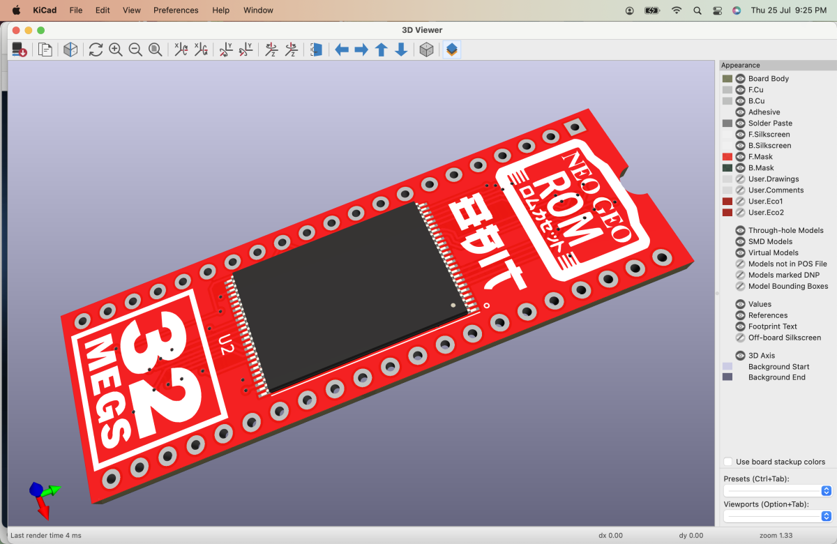

Before starting; the smart thing to do is waste several days drawing custom graphics (and redrawing existing graphics) so that we can make the boards look cool. Initially I was going to use Inkscape for this to test out the new Vector Graphics import functions in Kicad 8. but then I didn't. Importing custom Bitmap graphics into Kicad 8 is also less painful than it was in 6/7 (Image converter -> Save to file -> Footprint editor -> import -> save to library -> board editor -> place -> footprint). I'm guessing things like fully automatic trace routing are higher on the feature list that easy custom graphics, so time spent learning the current workflow is not going to be wasted.
The PCB editor of Kicad8 has some cool new features - one that I particularly like is "snap to" in the edge cuts layer even when holding control, makes it much easier to cut a notch out of the top of the board like the one here.
The 3D board viewer in Kicad 8 has had some great enhancements too - change the colour of the board or the silkscreen or the mask or whatever just by clicking on the coloured box in the appearance manager. Previously this functionality was buried deep in "preferences". Here they are in NeoGeo Red and White
So now that they look cooler, which is half the battle.

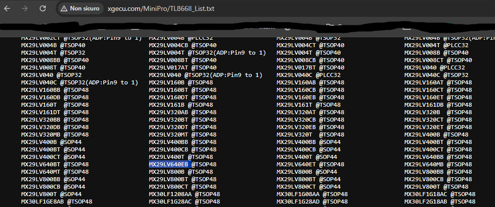

Are you sure that the t48 can't program those chips? They are listed on the supported devices in the Xgecu site.
No, not sure at all :-) now that I look more closely several of the "possible compatible substitutes" are supported. Definitely worth a try.

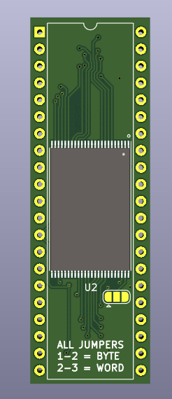

Checking /Byte pin on adapter, its connected to 3v so we cant use this as Vrom becouse need to be low.
But hey no problem check this mod for this adapter and byte mode:
https://www.reddit.com/r/PrintedCir...ew_request_32mbit_flash_to_8bit_toshiba_mask/

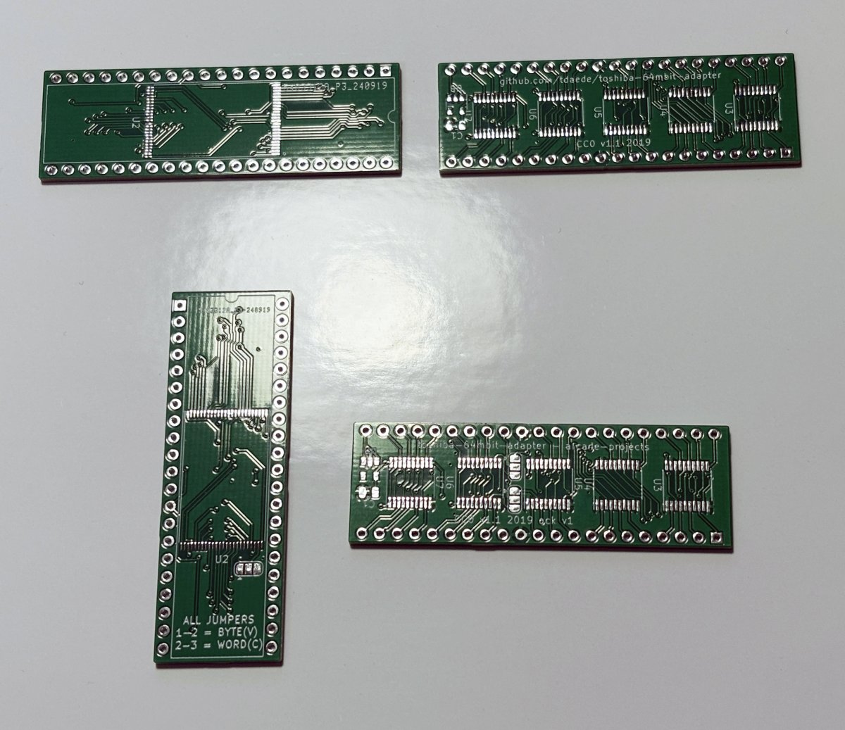

You are wanting 47 to be GND? or would a jumper that lets you selected between pin 47 being GND or 3.3V be better?
Yes, a jumper should be a great option to have all in one solution, but I’m not sure that it’s the only change on pin out between two version.
yeah it is a bit more involved then just a jumper. The ICs being used for level translation are uni-directional. When BYTE mode is enabled data line 15 gets switched to an address line, which means the signal needs to flow in the opposite direction.
Hey guys,
The developer of the original Vadapter version (the one without drill hole file) has replied to my question on FB and replied that the adapter does not work at the moment and that he does not recommend using it in its current state.
Unfortunately the project has been abandoned. :|=O FYI
