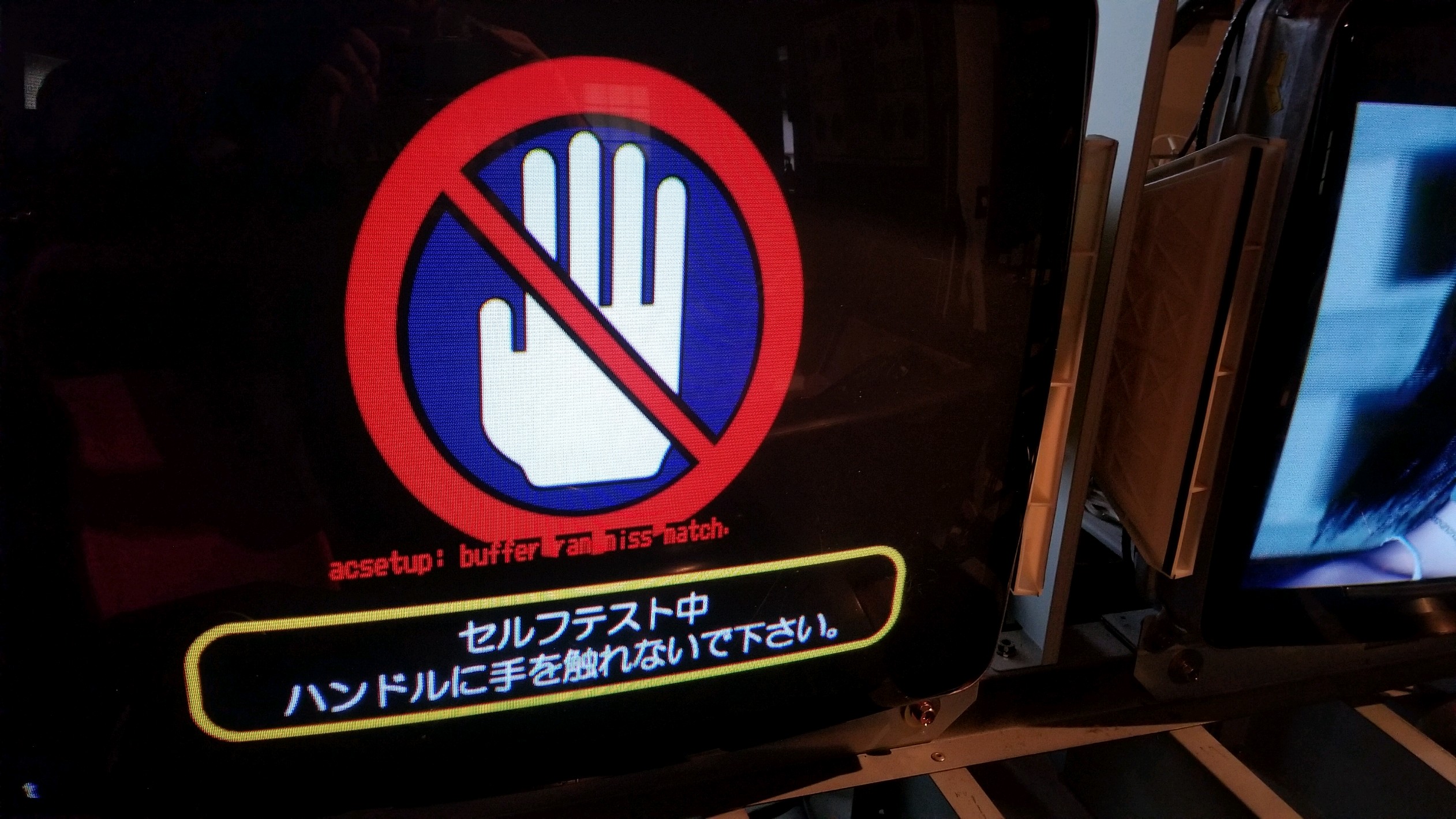

I recently started to get this error on boot when it gets to the initialization screen (pic). "Acsetup: buffer ram mismatch." Both systems were booting the game fine until now. One gives the error the other continues on to load the game fine. I tried swapping the ram between units, swapped discs, replaced the battery...
Any help is appreciated. Thanks!

Quick update - I swapped all PCB's (minus motherboard)/Ram/dvd drive between the working and non-working unit. Still getting the same error. I'm thinking it's a chip on the motherboard? Anything known to burn out/go bad on these boards? It's the 246a ps2/namco combo motherboard.
Thanks!

One of the ram chips on the board has gone faulty? Look for any pairs.
Thanks for the reply. Not entirely sure what you mean by "look for pairs"?

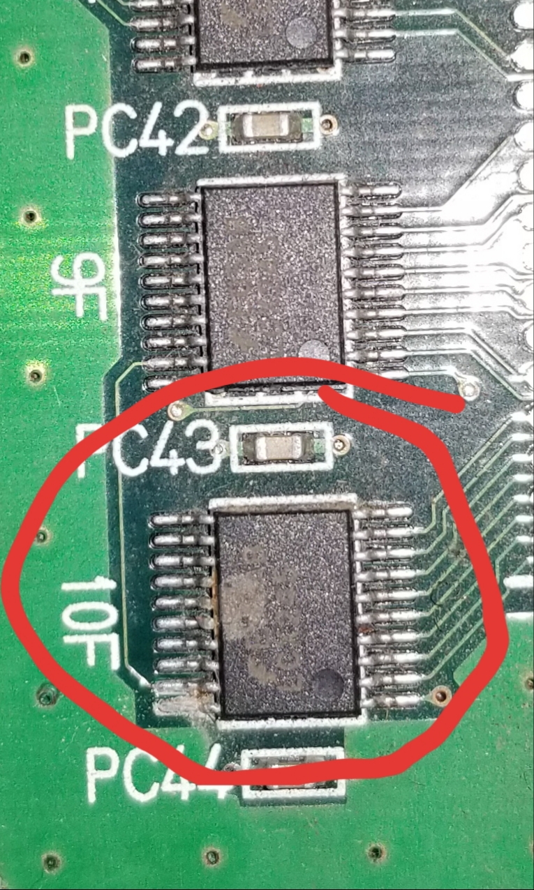

Also, not very versed in pcb repair but under visual inspection this transceiver looks like it has a pretty badly oxidized leg - not sure if something like this could cause the error I'm getting?

Pairs of RAM chips that is. Unfortunately, spotting a broken one is impossible without the proper tools.
