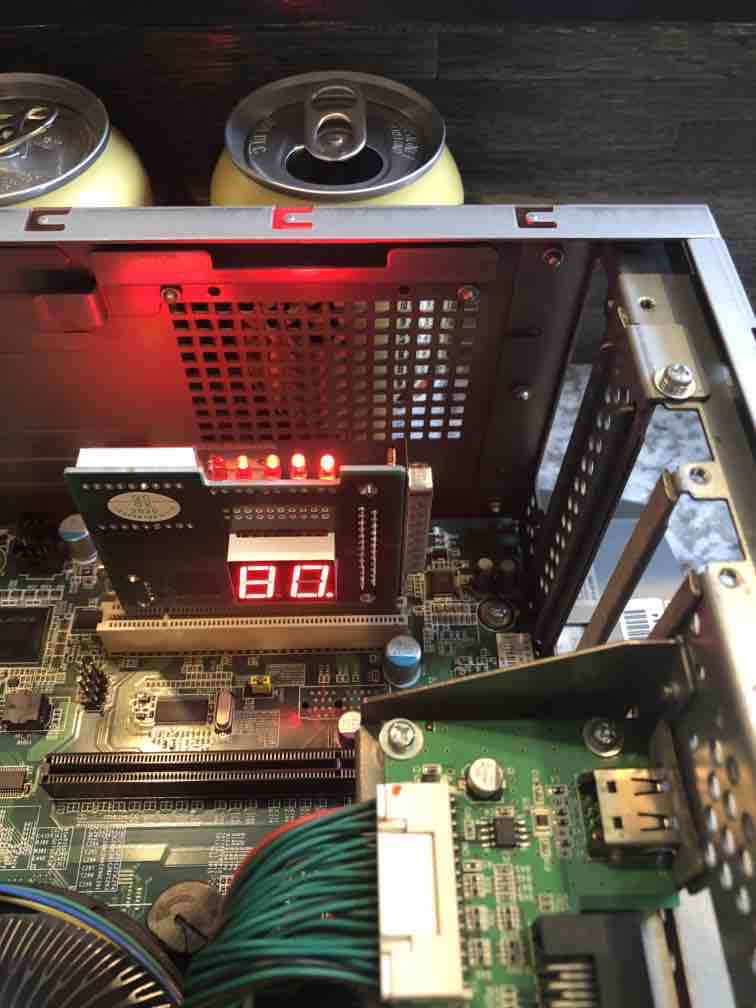

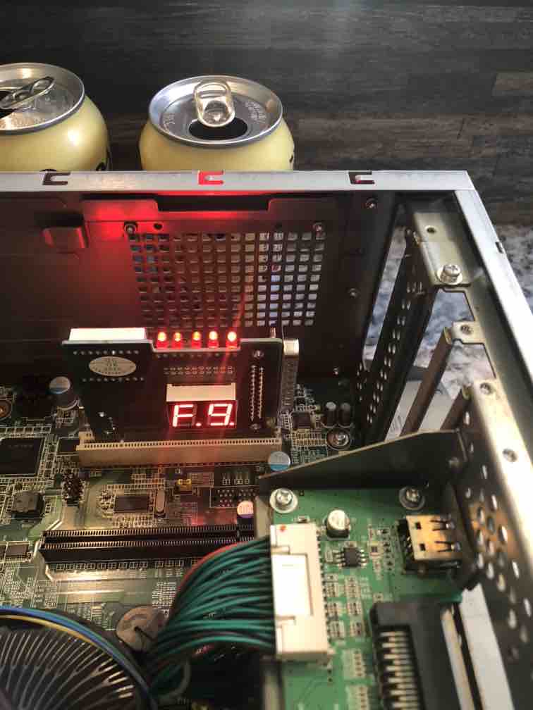

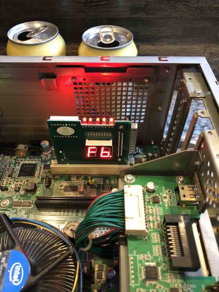

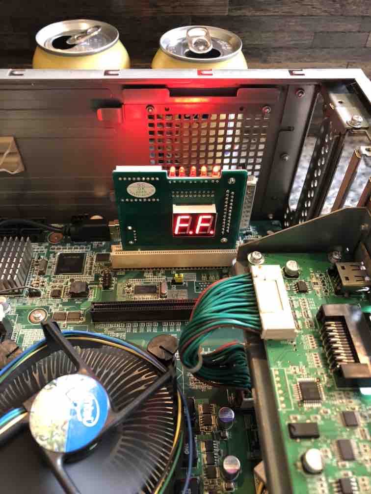

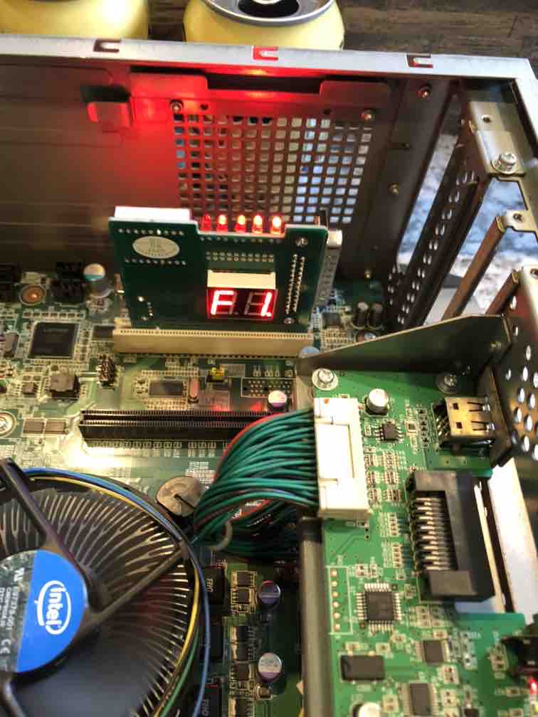

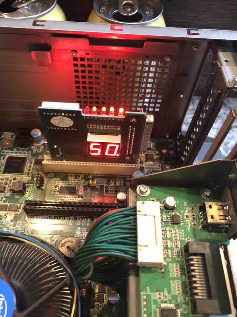

Installed a PCI POST error display card and came up with these errors
Need to cross reference to the the AMI 686 error list
Found that upon boot from power down FF is displayed and system goes Into standby, if I connect a momentary switch to pins 6/8 on header and issue a long hold,release, then press again these other codes display, each after doing this reset cycle
Code 50 the system only will reset if main ac cord is pulled.
I am going to try a bios reflash. Seems it has been corrupted somehow.

So the RE2 has a known issue where a controller chip fails , i replaced bios with a new chip (flashed with re2 .bin bios file) and still no post. So issue is elsewhere on the mobo.
Apparently this is a issue w/ RE2 and ringwide bit not RE1
Bought some RE2 motherboards for a low cost to try out two had bent pins on the CPU slot so were useless, the third would not post just like my original re2 mobo.
