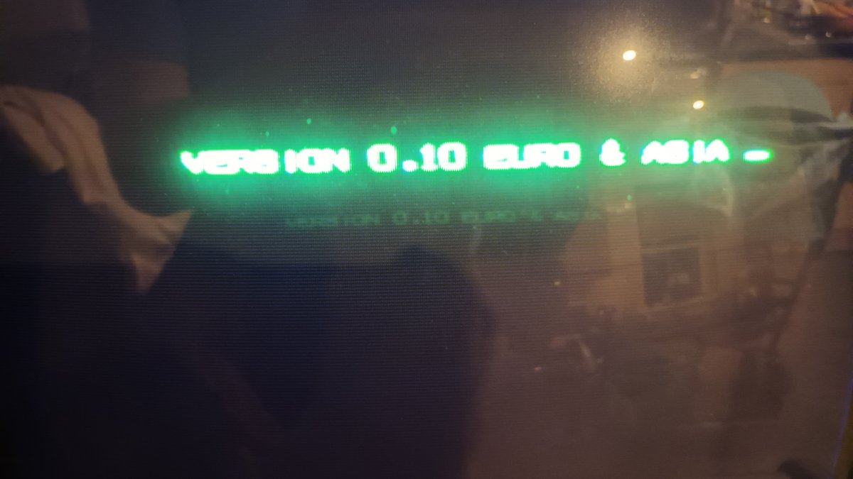

Also, I'm not sure what version I have, I'll have a better look now...
I just made a quick patch for Mame but I can make a eprom hack too. Just check the region and version as they mention on The Cutting Room Floor...
"Hold 1P Start + 2P Start before the game boots to see this version info screen."
There it is. That's really great that you could get it running so quick :)

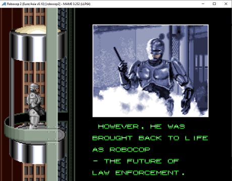

I have now made a patch for the 0.10 version and I got everything working. Adding the two extra stages, including the logo screen when stage 2 is finished, expanded attract mode to include stage 1 and enabled the level select. To make the attract mode like 0.11 was tricky ?( I had to do a lot of tracing with Mame's debugger and borrowing some code from 0.11
Now I started to make a patch for 0.11. It should be easier since I don't need to "borrow" any code from the other version like I had to with 0.10 . Just change a few bytes here and there and copy the English text from 0.10... (I hope :whistling:)

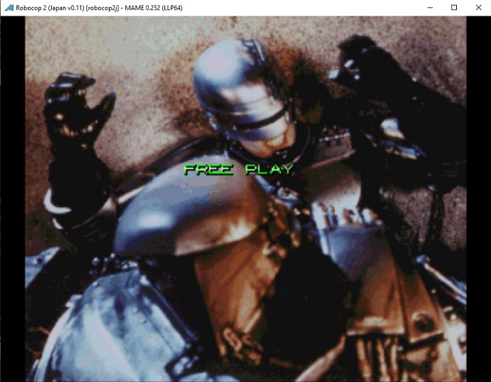

The patch work is still in progress, I plan to use the coin setting switches for free play so I can use Switch 1:8 for something else later. But you can help me with a "beta" test later on. After I have fixed a few more things.
