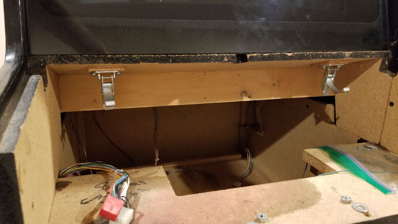

Can anyone tell me how this monitor glass should be secured on my Neo Geo MVS big red cab?
It came like this, and there's nothing holding it up. Looks like it could easily fall down when the control panel is opened.
The control panel is designed to hold it in when closed and latched. The glass is angled back so the weight holds it in when control panel is open. That little notch is so you can just simply use your finger to slide the bottom of the glass out. It can fall out for sure when you are working on things, and I have seen people use a small screw and washer to overlap the glass to add some extra safety.
Actually, I just figured it out. Someone put a metal L bracket there to hold the glass in place, but it must have fallen off when I was transporting the cab. I found it in the bag of bolts and stuff I pulled from the cab when I cleaned it. I'll try putting it back in place. Thanks for the input.
