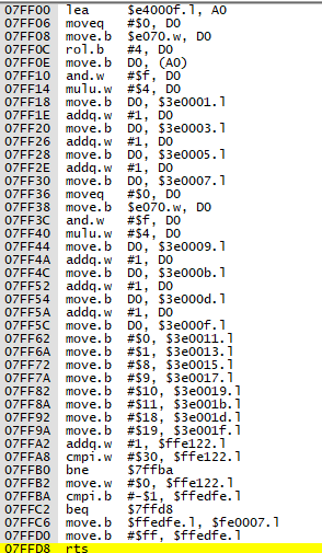

I found an old post from @apoc that says exactly what I figured. This fix is above my paygrade but hope someone has already done, or can take a look and see if they can make adjustments per Apoc.
Old post from archive:
Is it possible to run Shadow dancer (since it uses a 68k and no MCU) on 5987 using this ROM positions and jumper settings?
I knew this question was about to pop up.
Yes it is possible BUT game would have to be patched to send bankswitching commands to the 315-5436 custom chip. Original commands for the older romboard can be kept making patched program universal (just like I did for Moonwalker).
Patching is very easy, just copy what is done for Moonwalker.
and further response:
Sorry for the late answer.
Let me explain: games write tile and sprite banking registers every frame. What I did is I simply inserted a jump there and created a new subroutine located in the free space you have at the end of program ROMs. Then since they aren't conflicting I kept the original banking writes followed by the writes needed by the 315-5436 custom chip. This way code becomes universal (works on both romboards).
I still need to get Alien storm running on Clutch Hitter rom board so eventually I will peek into the Moonwalker anyromboard code and see how its done. Assuming those roms are public?
Found em.
I guess these two are the routines mentioned.
0x7fE80 (this one JMP's around 0x442)
0x7FF00 (this one RTS as it's called from JSR around 0x1DD0)
I'll need a decrypted set to compare against, but my storage is 'messy' to say the least.
Someone point me to a decrypted set w/ no MCU/ROM patches pls?
Found em.
