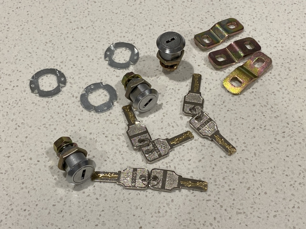

I’ve got some already and held them side by side with my drilled ones from a Lindbergh cab and I reckon they’re going to be spot on. I have the original tangs luckily.
