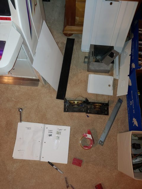

During my teardown, it looks like one of the mounts for the leveling feet broke loose inside the base, any ideas how to get in there or a workaround?
That aside, I've pulled everything apart and getting ready to get some quotes on a repaint.
I'm either taping the screws into the misc parts they match with, or labeling them and taping them inside of a spare notebook so my forgetful self doesn't lose track of what goes where.
setting stuff aside, I decided to clean up the marquee topper, came out pretty good, but there's some overspray from when the cabinet was painted last, all I tried was some simple green and a plastic razor, but that did minimal good, if any.
gotta figure out a better way to get the paint off.

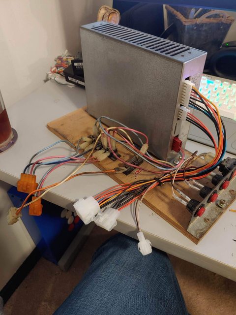

Today's project - rewiring the power supply unit to stock (or at least stock pinout)
also cleaned the original wires that were still intact since they were scuzzy.
tested voltages and all is well!
Next project is to rebuild the connector for the monitor power and degauss.
