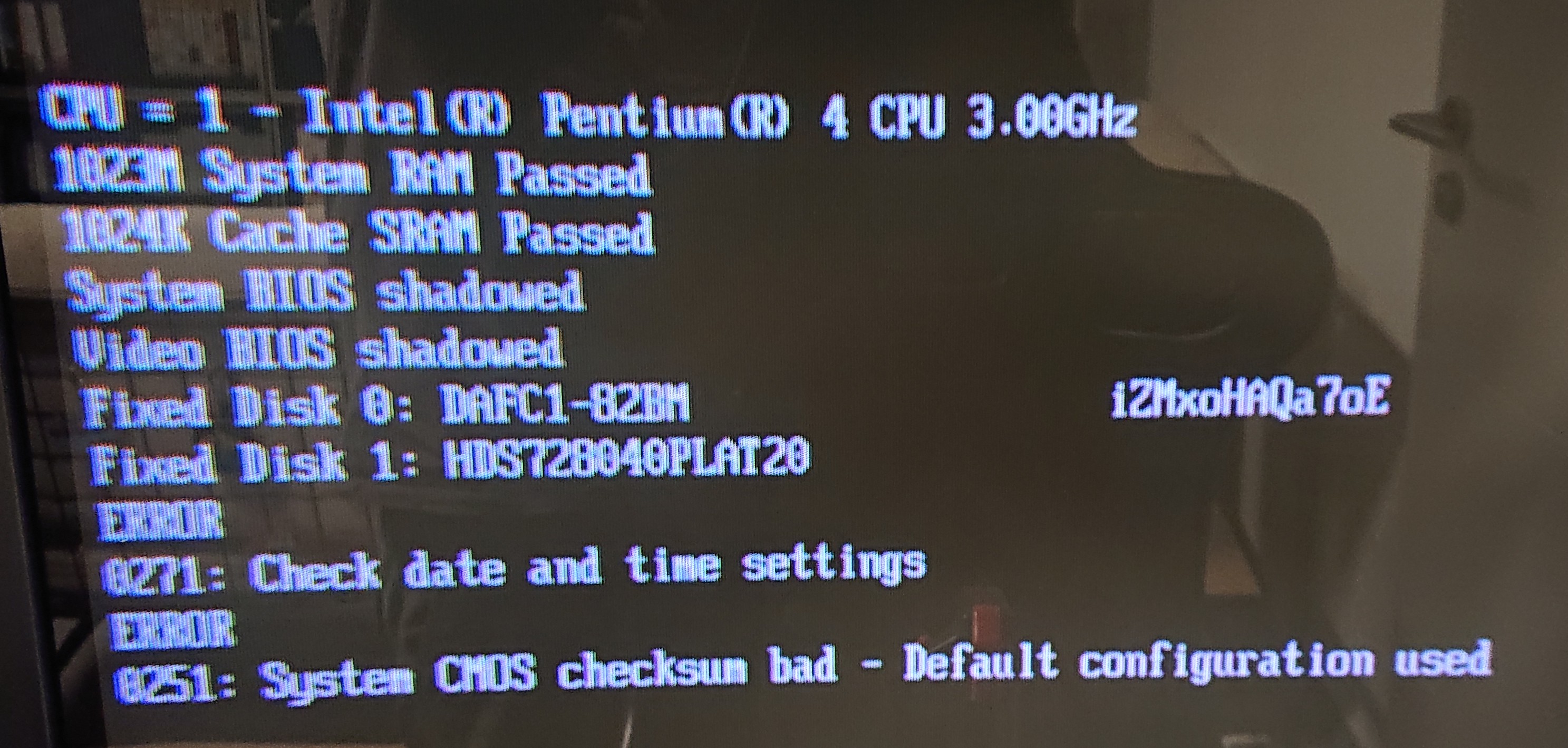

Hey guys,
I have an After Burner Climax cab which worked flawlessly until some weeks ago. I played it, switched it of and from the next day on I always receive this error screen. Completely clueless and depressed. Arcade could be such a shitty frustrating hobby... :(

Replace the 2032 on the motherboard, clear the cmos using the jumpers on the motherboard.

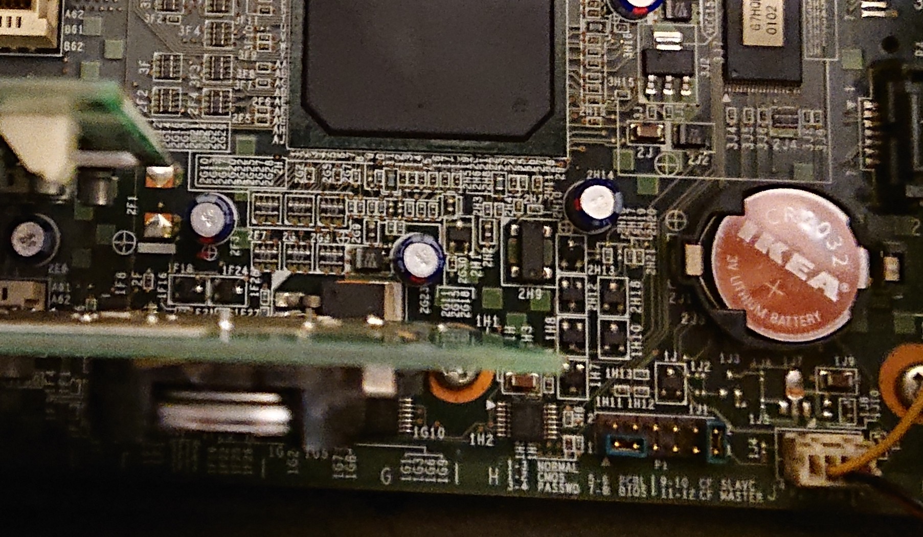

I've just replaced both batteries but I receive still the same error screen unfortunately.
Where are those jumpers CoolFox has suggested to tamper with?

Ok, understood.
Should I remove the green jumpers and start the machine to clear the cmos?

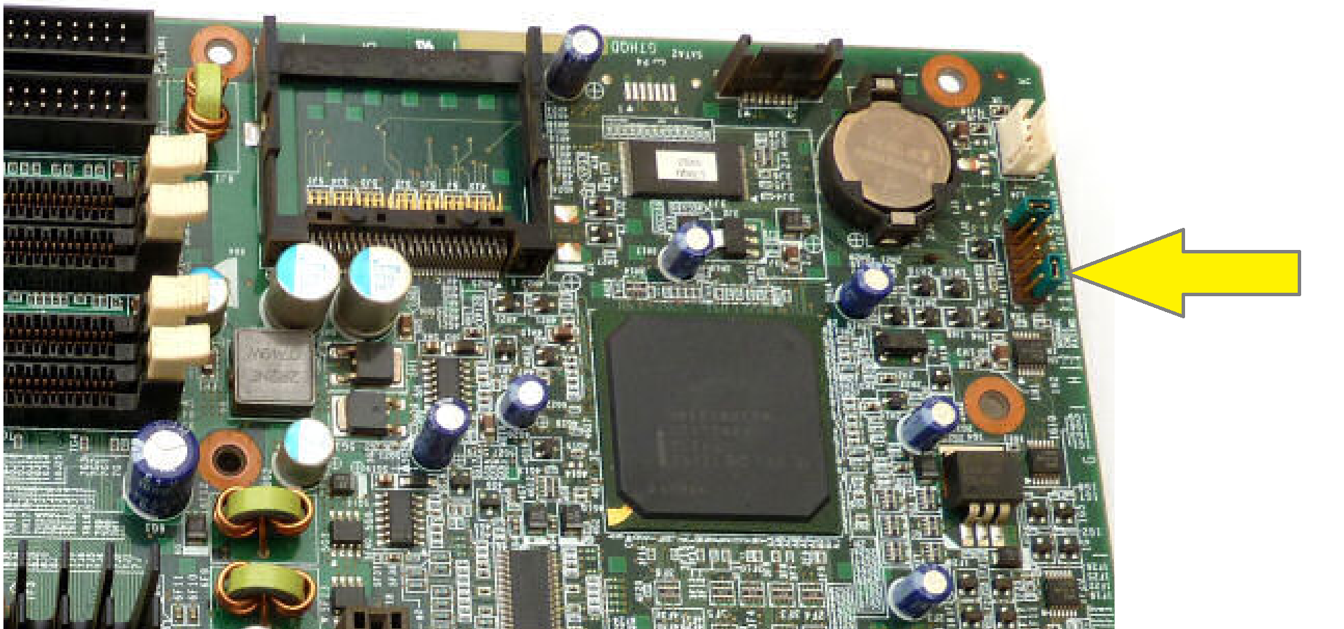

Not remove. the one that I have pointed, should be horizontal like the other one but making contact on the two lowe pins. It's like if you turn it 90 degrees anti-clockwise.
OK, so I will put both horizontal and then switch the machine on?
you only need to touch the one that is vertical, but yes, basically that.
