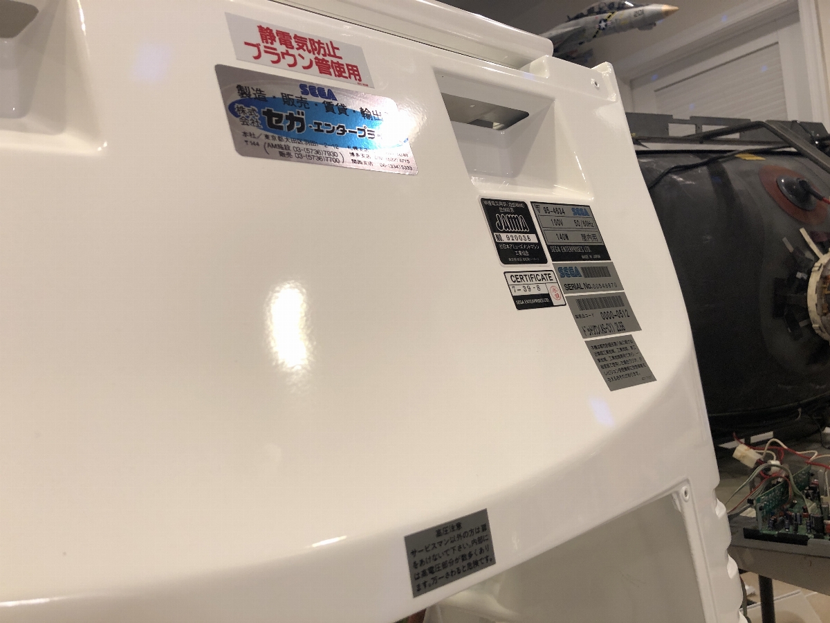

2. All doors and exterior pieces have been striped, sanded both inside and outside (this almost killed me), scrapes/gouges filled, primed, professional automotive paint sprayed then gel coated inside and out. (all parts color matched to original)
3. All bolts/nuts rust removed and polished (careful to keep the zinc coating) if need be - they have been replaced with NOS screws/bolts.

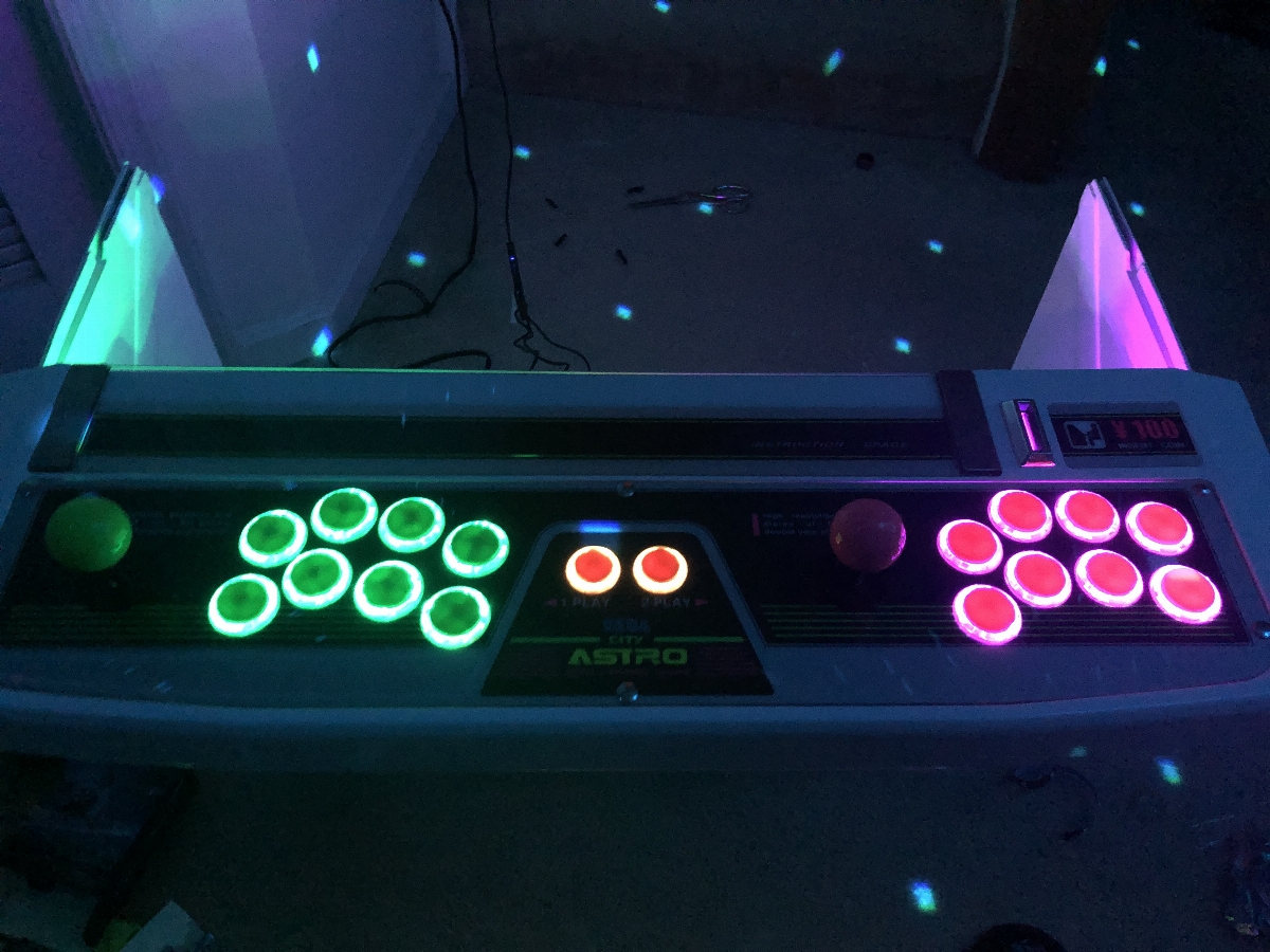

4. New Alberto Panel, 8 buttons on each side, new sanwa sticks and buttons with clear rims for back lighting and bubble tops - all matching original colors.

13. All exterior and interior foil stickers replaced with correct serial numbers

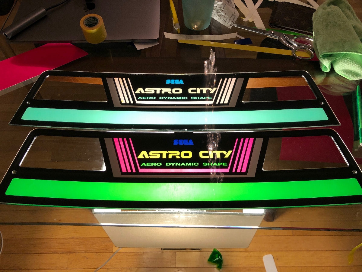

So to start the off what reminded to to post this was I completed the top marquee color restorations last night which im pretty proud of and was nerve-racking to complete as you get 1 shot doing this perfectly or it fucks up the original vinyl shapes and there is no fixing it: (excuse the overhead reflections).
I used a custom arcylic mixture of silver and black paint to match the metallic original vinyl in spots that had been scratched and used professional exterior sign transparent vinyl, hand cut for each section - the tolerances in some spots were a few millimeters!
Old/original on the top - restored on the bottom.

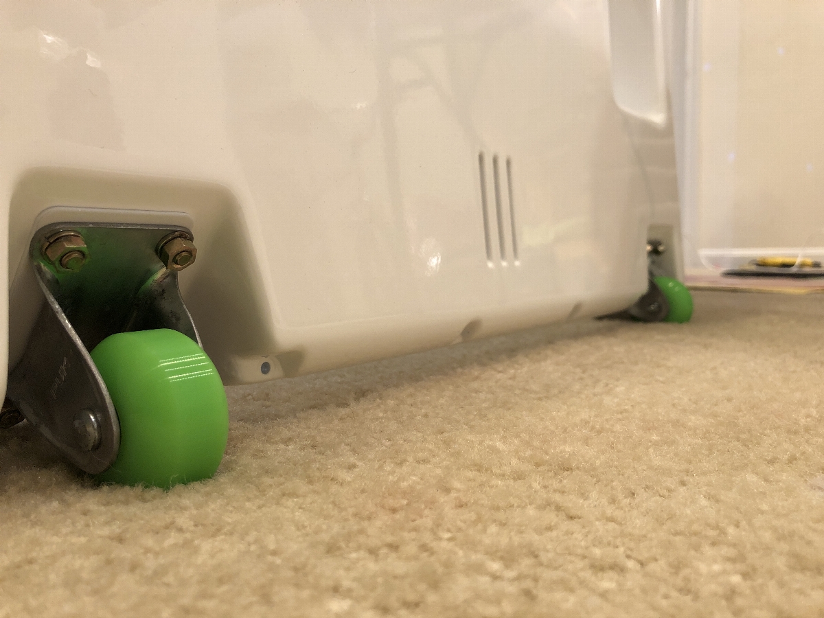

So yeah about the wheels, pretty cool right? Got tired of looking at those ratted out black stock wheels - so those green wheels are blank skateboard wheels. The size you need to do this is 50mm. But be aware, like almost everything with these cabinets - it's not a standard 1:1 match - stock 50mm skateboard wheels are just a hair to "fat" for the opening of the castors so I ended up sanding down one side of the wheels slightly so they would freely spin, you will also need bearings - which thankfully stock skateboard bearings fit the axles. You may get lucky and find a different wheel thats more skinny - but it seems no one advertises this measurement.

I'm curious why you decided to go aftermarket with the control panel with 8 buttons. What games are you planning on running that need that setup?
Everything else is looking really clean, nice work.
So the original was done, lots of rust, play wear - it was original and it seems Alberto makes the best replacements. I went with 8 buttons on each side so I can do different 4 button layouts for neo geo games depending how I'm feeling then have the right buttons for street fighter as well. I figured throw it all in there and at least i have it if needed. I plan to have a hyperspin setup but also accept PCB's if need be.
