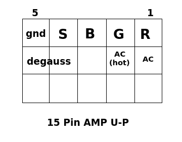

Two new problems have surfaced. First, I seem to have lost certain colors, most likely red. Second, my image has flipped and is now upside down. Any advice would be greatly appreciated.

As for the lack of red, double-check the RGB inputs to the monitor chassis.

Where do I find the RGB input?
