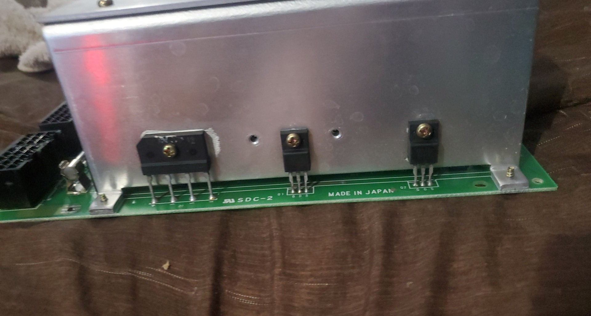

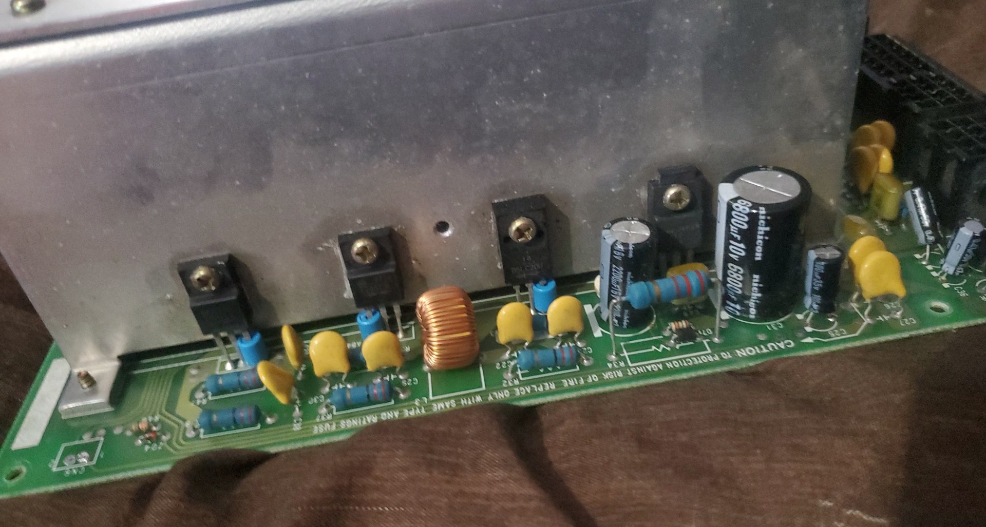

ok i know theres a caps list for the psu but would anyone have a list or links or the 7 hots all the way around it?
these are what I meat
The transistor type is written on the front. I would be surprised if anyone had that information on hand.
Blast City PSU SJ25-0302-04
Chips attached to outside edges of heatsink.
@D1 = D3SB60 (73) https://www.mouser.com/ProductDetail/Shindengen/D3SB60-7000?qs=mr/YtQLfk94RSAnmMYwSDQ==
@Q1 = K2236 (7F) https://www.transistormosfet.com/transistor?search=K2236
@Q2 = K2236 (7F) same as above
@D5 = NEC 24A12 (9713H) https://www.jotrin.com/product/parts/24A12
@D6 = D5LC20U https://www.mouser.com/ProductDetail/Shindengen/D5LC20U?qs=MAKYsf4oimn6FQQxXEk7zQ==
@D8 = F20SC3L (51) https://www.transistor-mosfet.com/transistor?search=F20SC3L
@D9 = F30SC4 (76) https://www.alldatasheet.com/view.jsp?Searchword=F30SC4
D6,D8,D9 have a blue filter of some sort attached to a leg of the component, labeled AB3, AB4, AB5. I'm unsure what those, do honestly, but assume they are separate from the actual chip itself.
Not all links are sales site links, there are some that are datasheets, or sales sites, with no stock, but data sheets....it will get you a far bit further, than where you were.
Best of luck.
