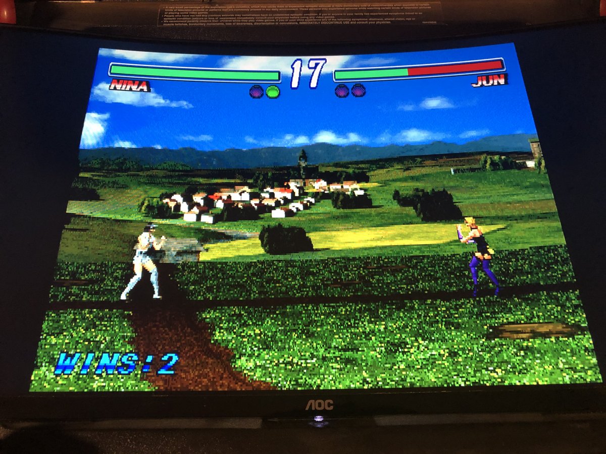

Yes, I tested the Namco System 23 and other arcade boards with the ossc and it was much better than the GBS-8200. The colors were much better and the image was much sharper. The only issue is incompatibility with certain displays and certain video capture devices and the ossc has little to no frame buffer for interlaced video.Still a nice choice over other more cheaper or super expensive alternatives.
Here is a picture of my tekken 2 pcb using the OSSC.
Edit: the ossc works fine with the Elgato Camlink 4K for video capture. Looks amazing! I have a still from a video I made. Have a 👀
