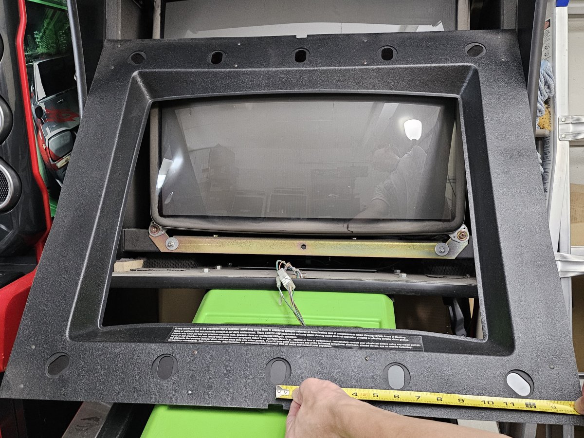

Does anybody have access to a Ghost Squad cabinet. I am trying to find the dimensions for the LED BD modules that surround the outside of the screen. I just need the four corners which make a square.
It should be something like 1000mm x1000mm square, I am guessing. Please from the center of the modules (so inbetween the two led lights on each board)
If somebody could please help me out, much appreciated.
Hey, thanks.
Sorry, I wasn't clear. There are 10 led modules arrayed around the screen. So there are four modules in each corner of the screen. I need the dimensions from the centers of the four modules. I am trying to set up the 10 leds on a custom screen. But I want the leds to be spread out the same as the original screen size. So I need two dimensions horizontal and vertical. Something like 1000mm x 1000mm
It's hard to measure from the led boards so I measured from the bezel led holes.
- Horizontal, from middle led hole to edge led hole: 11.75 inches/29.845 cm. From left edge led hole to right edge led hole 23.375 inches/59.372cm
- Vertical, from top middle led hole bottom middle led hole: 21.5 inches/54.61 cm
My bezel size is 28.812 inch x 25.125 inch/73.184 cm x 63.817 cm.
The positioning of the leds are like this.
I don't think you need to be exact. The positioning I think it's more important. It'll be different for 29 inches monitor (upright version) vs 50 inches monitor (deluxe).

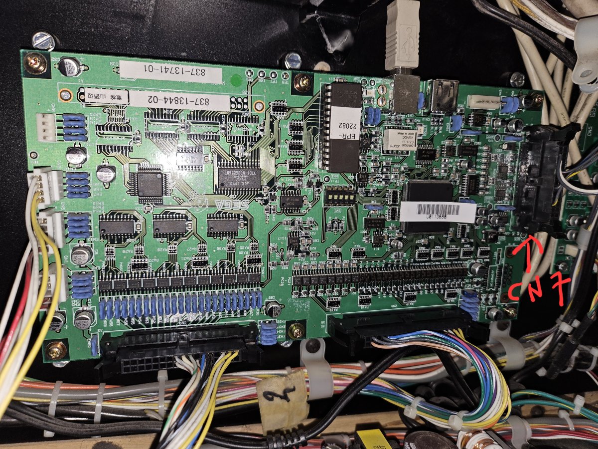

I see that you have what looks like an earth wire attached to the bezel. Can you please tell me where this wire goes. Some photos would be good.

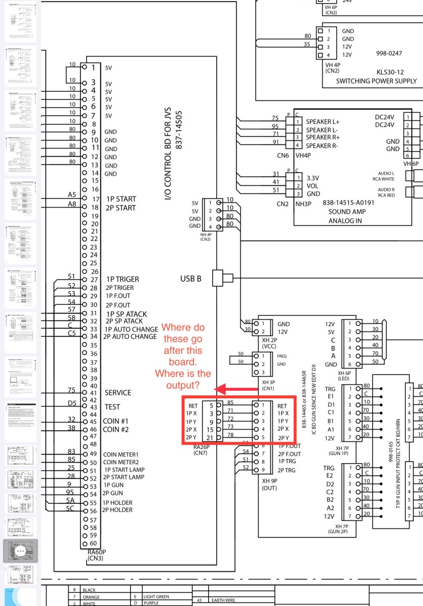

Could you also please tell me. Where does the LED sensor wires go after then exit the gun I/O board. I wonder if I need to add another board before the UHID. I was thinking about going out of gun sense board and into I/O control JVS. But I dont know where to go after that. And I don't have the I/O board, I would need to buy. Please advise if you think this is a good idea. I am just trying everything.

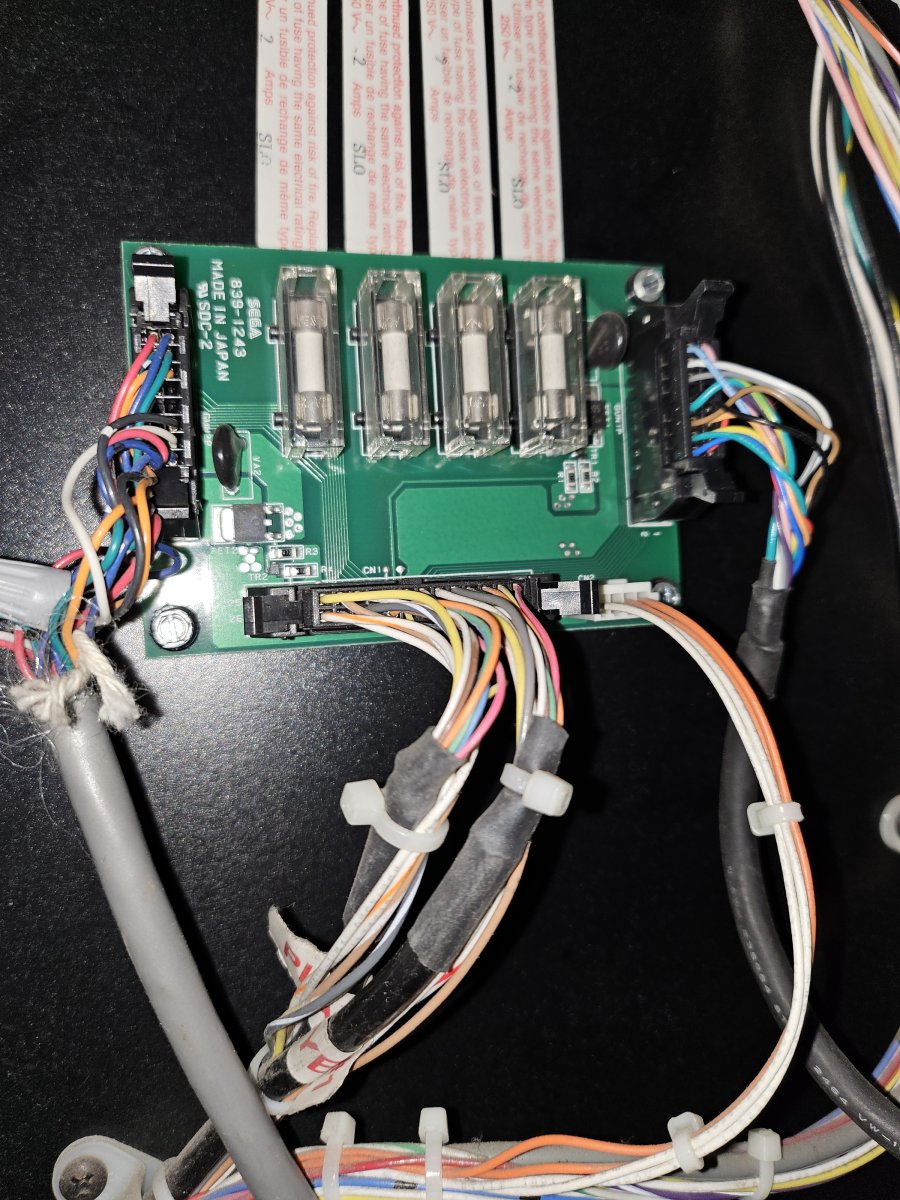

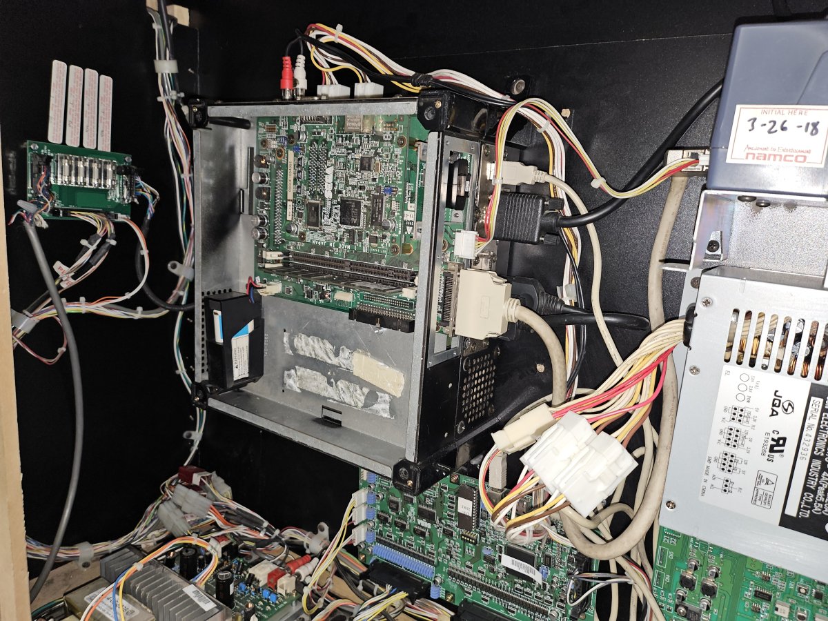

The big green wire goes to ground so it's not connected to anything. The other connector goes to connector CN1 on picture I attached.

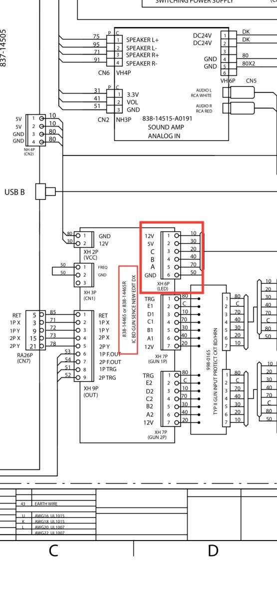

Thanks very much for this. What is “The other connector goes to connector CN1 (I think you mean CN7) on picture I attached.”? Is this the LED cable. I have plugged my LED cable into XH 6P on the gun sense board (see schematic drawing above). But I assume you plug your LED cable into the I/O Control Board for JVS, part number 837-14505 on schematic (although I note your board has a different part number). Can you please trace you LED cable and confirm which board that plugs into. I think it should plug into the gun sense board XH 6P (part 838-14465) Thanks again
Sorry, I might be wrong. It's hard to trace it without cut all related zip ties. It's better to follow the wiring diagram.
I can not see CN1 on the diagram
I have mine plugged into XH 6P on the gun sense board. I think this is correct. See diagram
So the leds go into the gun sense board then to the I/O board. Do you know where they go after this. My leds go out of the gun sense board straight to uhid then pc
