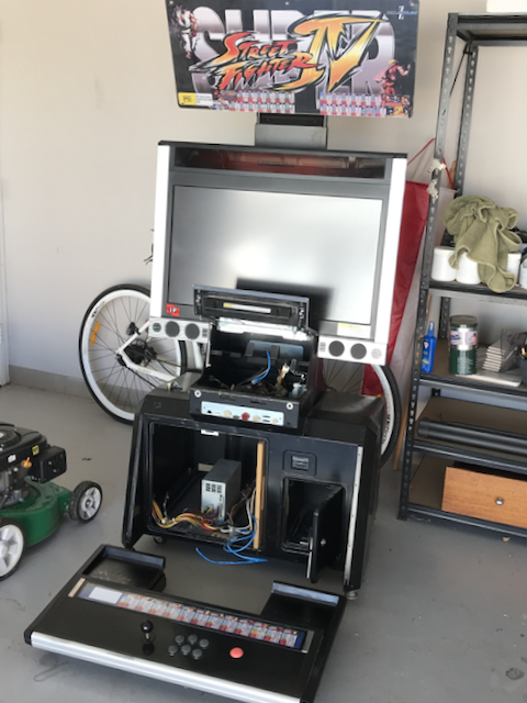

First up, here's the cab minus any hardware, but with all the IO, boards and wiring intact. It has a Noir replica billboard and control panel.

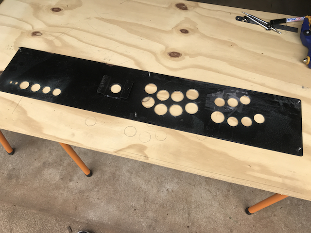

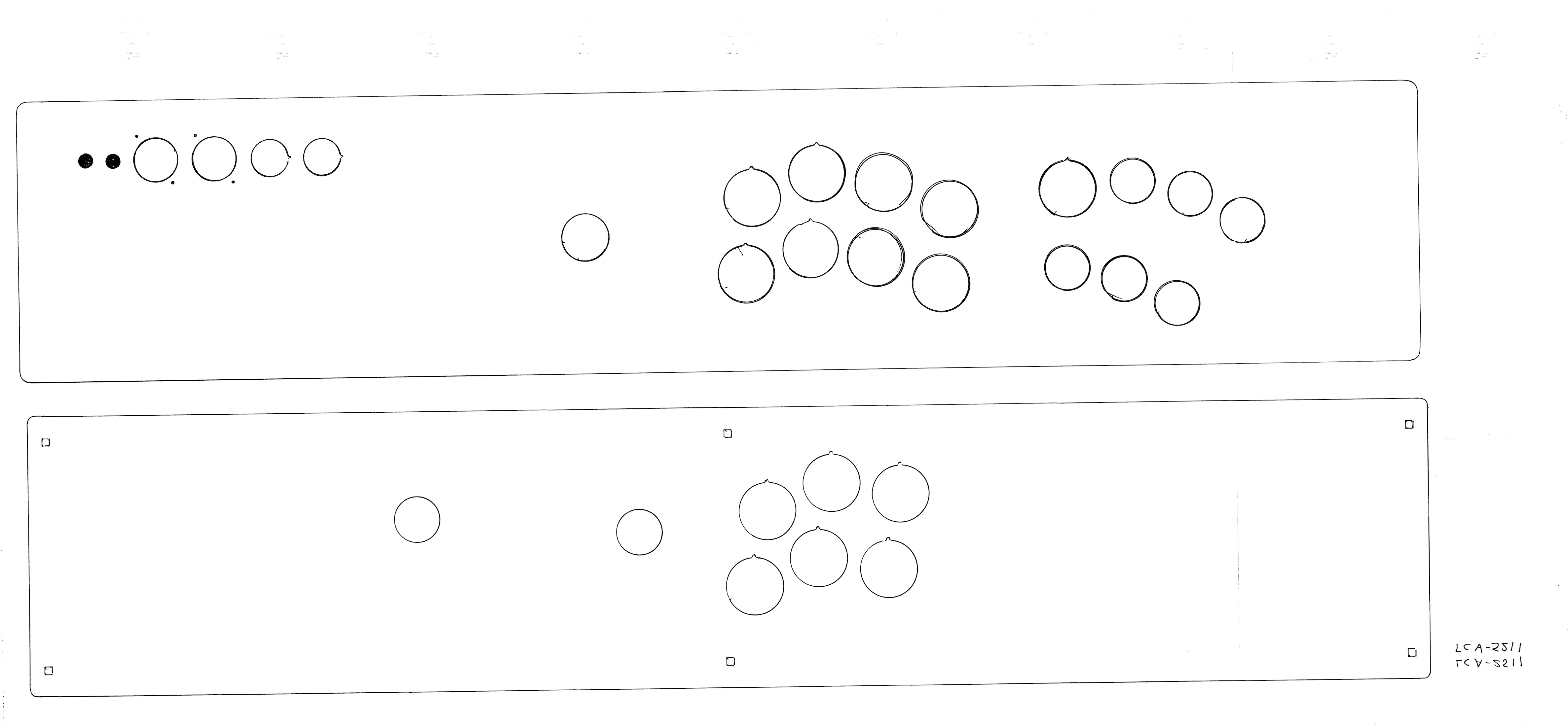

I'm new to arcades and am more interested in converting this for console use for maximum gameplay. The first step was to visualise how I wanted to modify the CP. I have original 1P panels and a Jasen's Customs 2P panel so was happy to cut this one up. Coins came in handy and an old school compass.

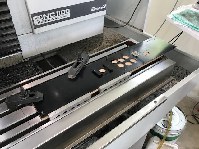

For once I know someone who has the machinery and cad skills to help me cut out the button and aux button holes I wanted. Once the holes were cut I removed all the old paint and rust and prepared the panel for powder coating. The panel is based on what buttons a Brook UFB will support. On top of that I've added 2 x USB, a volume knob and a headphone jack.

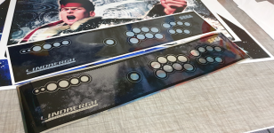

After searching like many others before me, I found a komorebi image I was happy to send to the graphic designer to make my custom panel artwork in the spirit of the original. The final image used on the CP was the central portion of the attached picture turned upside down and in greyscale. It took a bit of back and forth to get the art just how I wanted it. The size of the white rings and two shades of transparent surrounds are very specific on the original panels. The final printout is beautiful and printed on chrome. I had another standard one done. Granted the original is more like a brushed foil, but this is awesome all the same. I also had a Virtua Fighter marquee done from a scan I found online. This was all done by Carson at Noodleshirt in Aust.

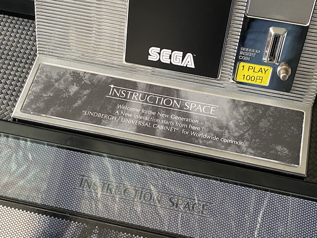

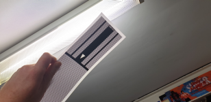

I purchased what I'm told (by River Service JP) was the last instruction space from Sega. I had it scanned in two halves and then reproduced on translite paper/plastic by Noodleshirt. It doesn't have the same rear blockout as the original but I'm very happy with the outcome.

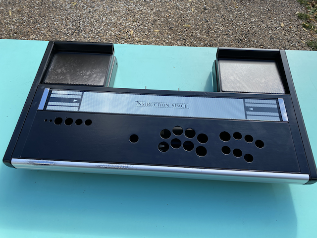

After sticking down the overlay, I carefully cut out the holes and put in some buttons for a test. The dual headphones was a brain fart, and later I put a volume knob in there.
Everything lined up beautifully. In order to get the artwork done, I turned the CP over and traced to out on paper. I then scanned that paper and sent image to Noodleshirt.

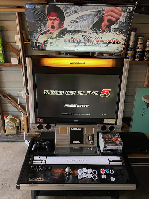

The billboard was a bit tricky to simulate the real ones that have a black border on the perspex. The fixing points cut through some of the logo, but it will do until I can get an original. These Noir billboards are too tall for the Lindbergh and the previous arcade owner drilled new holes to fix this to the cabinet. I was able to lower it and it now sits nearly in the right spot.

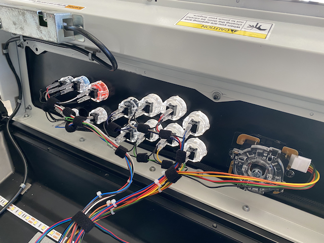

Connecting all the buttons and audio stuff was a process that involved a lot of experimentation until I was happy. I can't remember the exact order but the post below shows the finished product.

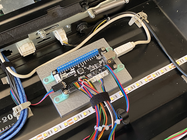

This is how it mostly ended up. I had to source some cables with Dupont connectors as well as some pre-made Brook harnesses to get this just how I wanted. I powered the 5V LED strip from the Brook board.

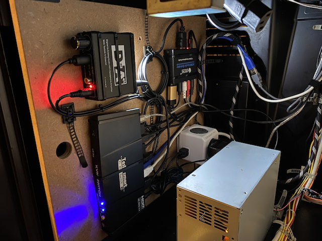

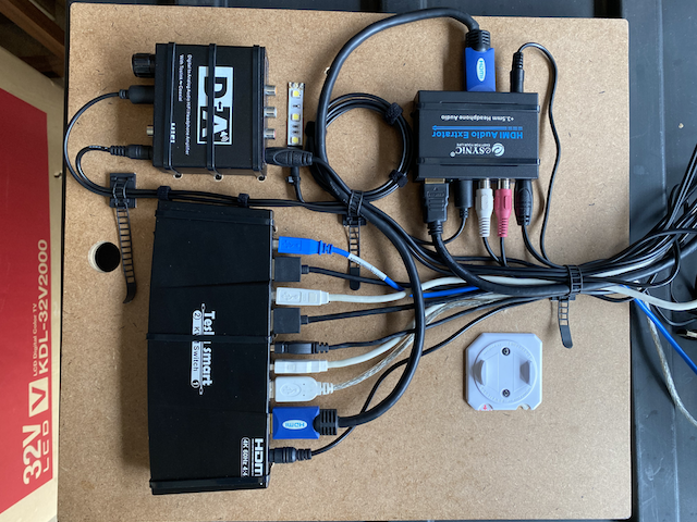

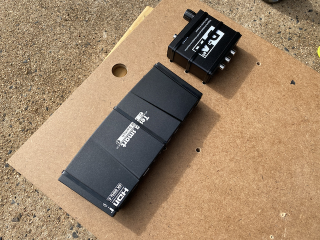

The next big phase was to build a board of components that controlled the switching of two consoles/PC and the audio setup. In the Youtube series I linked to in the first post you can see that whole process I went through. Basically I have a USB/HDMI KVM switch that allows me to have two consoles connected to the cabinet. I can't exactly switch between them live, but you can easily play games on one console and then switch it off and switch on the second console and play that. The audio worked out that I have a volume knob on the CP that controls the volume of the Lindbergh speakers, and I have a headphone amp inside the cab that controls the volume of the headphone out. The USB plugs are connected to one of the consoles of your choice and the other to a USB power supply for your phone. As mentioned, there's heaps more explanation in the Youtube videos.

I spent hours getting the cables right so I can unplug stuff in the CP and at the back for CP removal and easy transport. Those RCA cables allow me to connect a sub or external powered speakers.

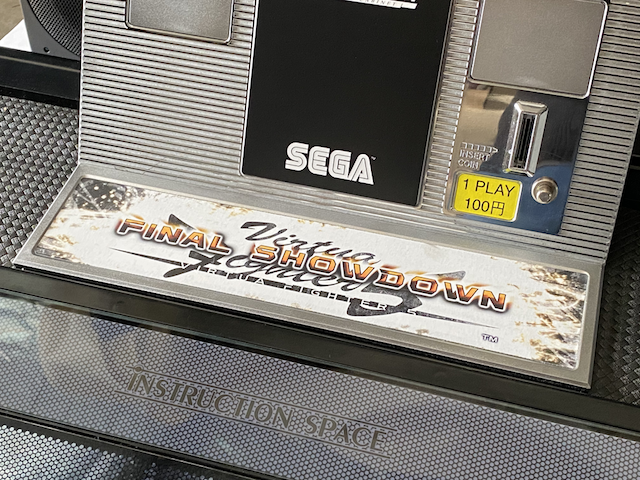

This has been a real joy for me. Over 12 months from purchase to completion with weeks and weeks in between of no activity or waiting for parts. Some finishing touches included getting a couple of mini instruction space artwork panels. I'm no artist but made a similar one to the original Lindbergh one, and also a Final Showdown one. These were printed on Ezytack and can be peeled off. The Dariusburst decal is for my Game Wizard (Vewlix Replica) cabinet.

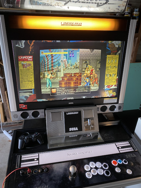

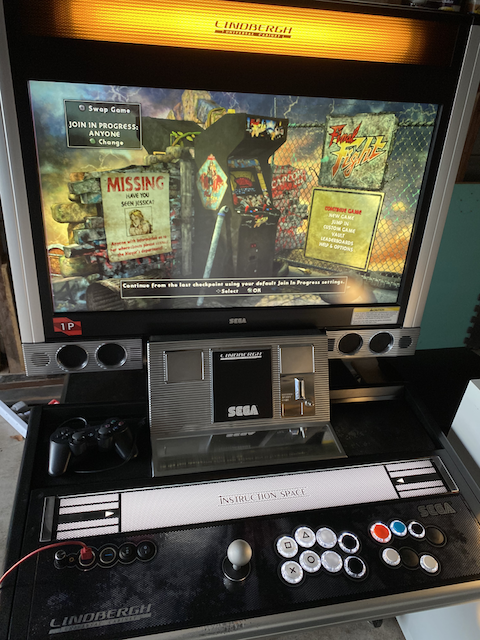

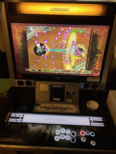

So there it is folks. These cabs are perfect for those who want to convert to console use and don't know much about the world of CRT candy cabs. Hopefully you get inspired from what I've done, and get in touch if I can help you out in any way with your Lindbergh project.
