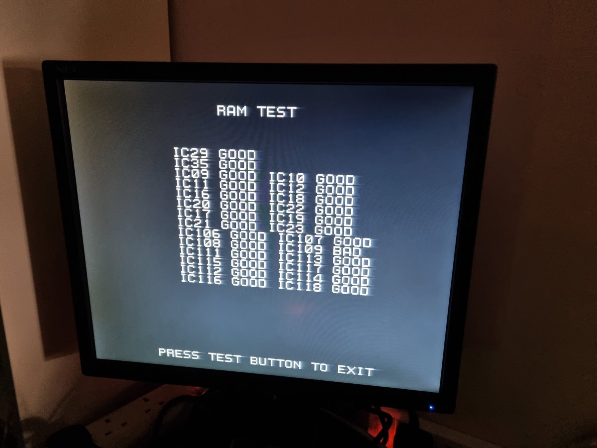

Sometimes the RAM test completes fine with everything 'good', other times I get an error on IC107 and IC109 or just IC109.

I can only think it's somehow those 2 RAM ICs - but is there any other tests I can possibly do before swapping them out?
I did a lot of load testing yesterday - none marked as bad. But I had 2 lockups on VF4.
Machine came on again both times without too much trouble. Am I possibly fighting a power supply problem? This is an ATX Corsair power supply.

It looks like common bad ram chips. If one fails they show up bad in pairs.
Try reflow them (107/109) and if no luck then replace them.

Thanks - what throws me is the RAM test doesn't always say its bad. Is this your experience too?
My experience was a hang at the ram test on a completely different ram too. Failed ram is extremely common in these.
Thanks @MickyMac - the new power supply at least gives me the confidence my voltages are good. Error seems to happen much more consistently on those ICs now. I'll try a re-flow first, fingers crossed!
