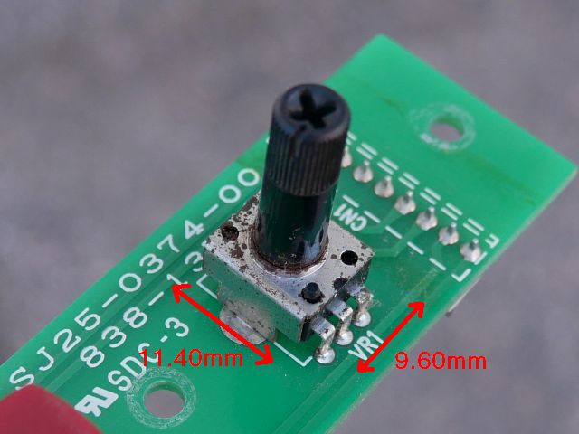

V Velyks Student Joined Jul 31, 2019 Messages 67 Reaction score 12 Location London Jul 23, 2021 #1 Hi, does anyone know what the value of the volume pot on the little button board of Naomi Universals/NNCs are supposed to be? Or does anyone know of a modern equivalent I can buy to replace it?
nem Immortal Joined May 29, 2016 Messages 7,701 Reaction score 8,412 Location Finland Jul 30, 2021 #2 It's a Matsushita brand 5 kohm pot. Pitch between the legs is 2.4mm. I haven't looked for a replacement, but I'm sure there is one out there.
tiff_lee Grand Master Joined May 21, 2017 Messages 1,018 Reaction score 804 Location Western Australia Jul 30, 2021 #3 This one here perhaps RS UK should have it or something similar, dimensions in the data sheet are slightly different but no more than 0.4mm. https://au.rs-online.com/web/p/potentiometers/7293619/ that has a linear pot though. not sure if the stock one is linear or logarithmic
V Velyks Student Joined Jul 31, 2019 Messages 67 Reaction score 12 Location London Aug 3, 2021 #4 Lovely! Exactly what I was after. Thank you!
