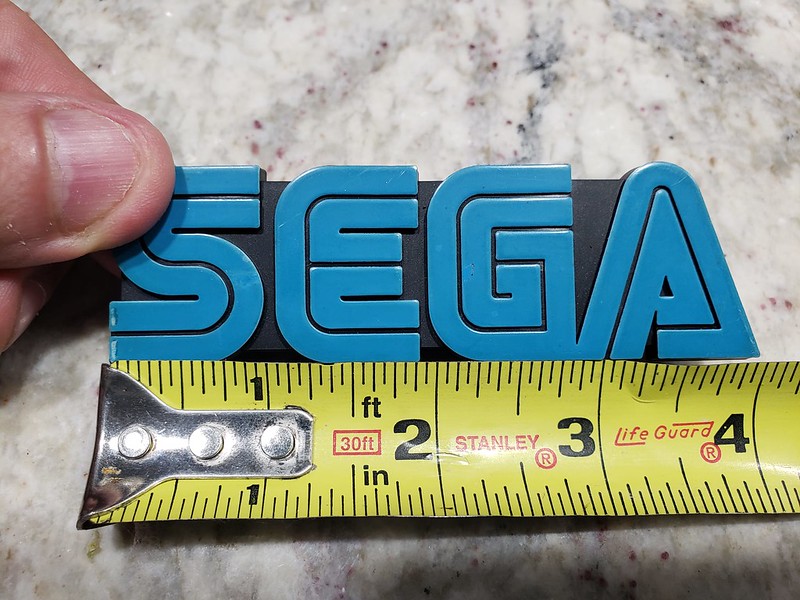

He's got a Sega Prologue 21 system but his speakers were missing the badges. I was sent a couple of photos of an original part with some rough dimensions:

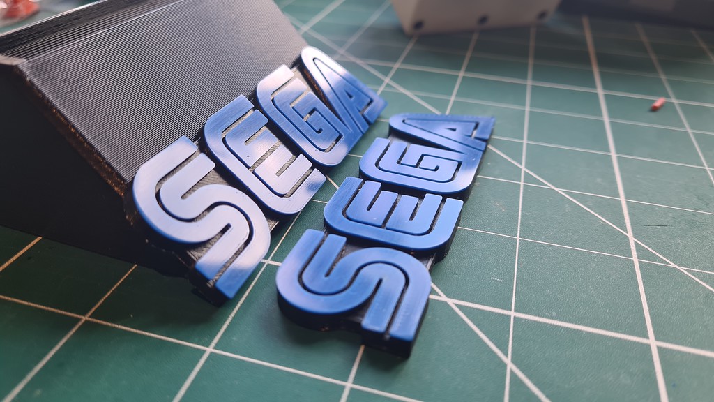

Moddeled them up from scratch and they didn't turn out too bad:

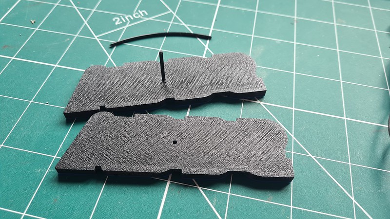

I modelled a hole in the back so that a piece of 1.75mm filament is a press fit and can be used as a pin.
I figured out that you can polish PLA to quite a decent finish. Much better than the raw print anyway. Here's a bit of video of before and after polishing:
