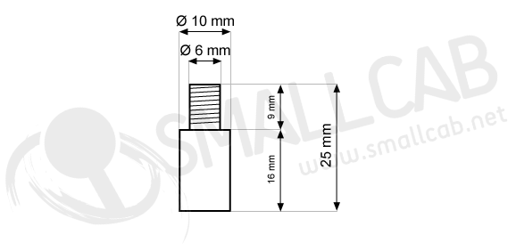

Here's the Sanwa JLF shaft diameter (8.85mm):
And here's the Seimitsu LS-32 diameter (10mm):
The JLF shaft is 1.15mm smaller in diameter than the LS-32, so any dust washer that would fit the JLF snugly will not fit on the LS-32.

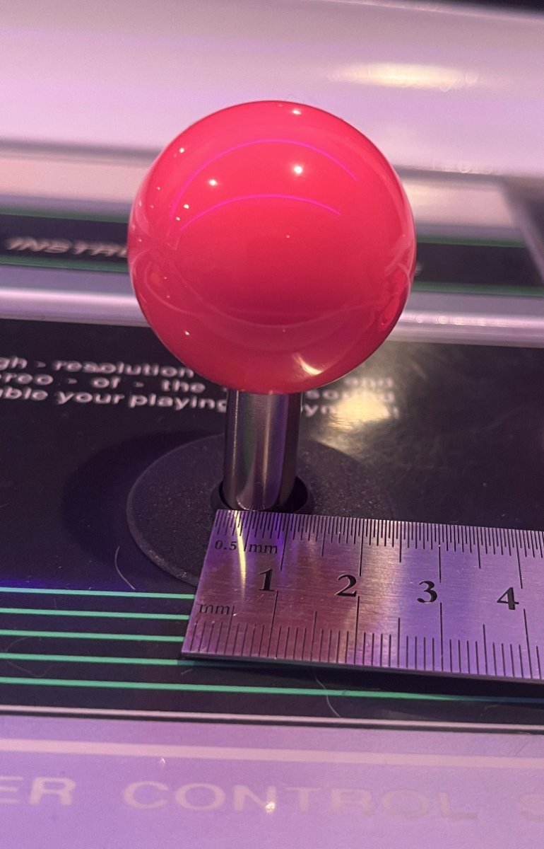

I'm so confused! Major conflicting reports here. Thank you for coming back with this photo. Is the 2017 revision of the LS-32 shaft also 10mm in diameter? And same with the center hole of the JLF dust washer? Did you have to force them through at all?
In the past I just used a drill bit to widen the hole on the dust cover for my Seimitsu shafts. No problem.
Smart!
It's about 3/8".
Damn, which is basically 10mm. Thanks, my friend!
@nem you mentioned these wouldn't fit. Just wanted to double check here and see where the disconnect was coming from.
Maybe the JLF washers are just a touch big for the JLF shafts but end up fitting snug on the LS-32s? Were you going solely on shaft diameter?

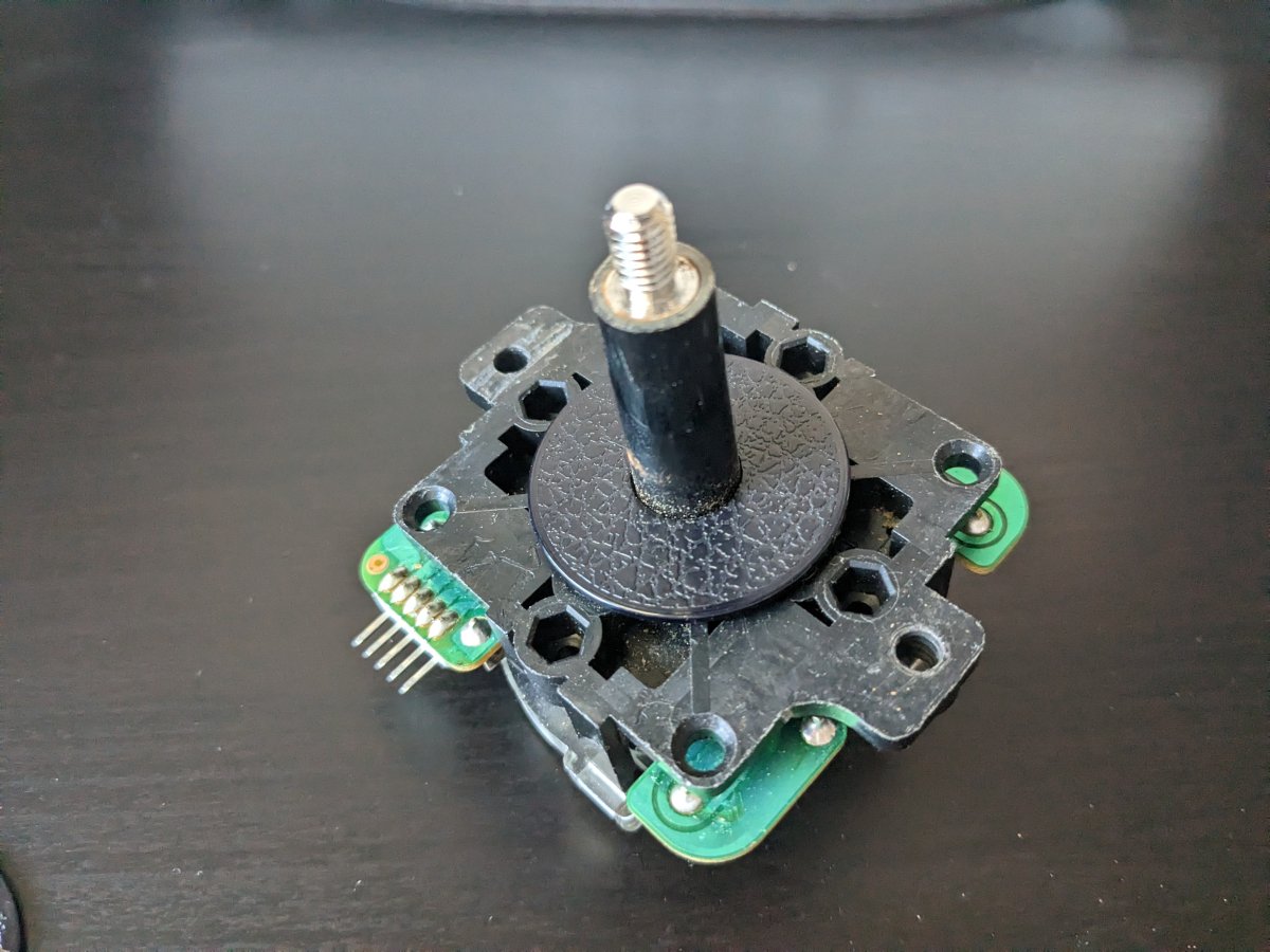

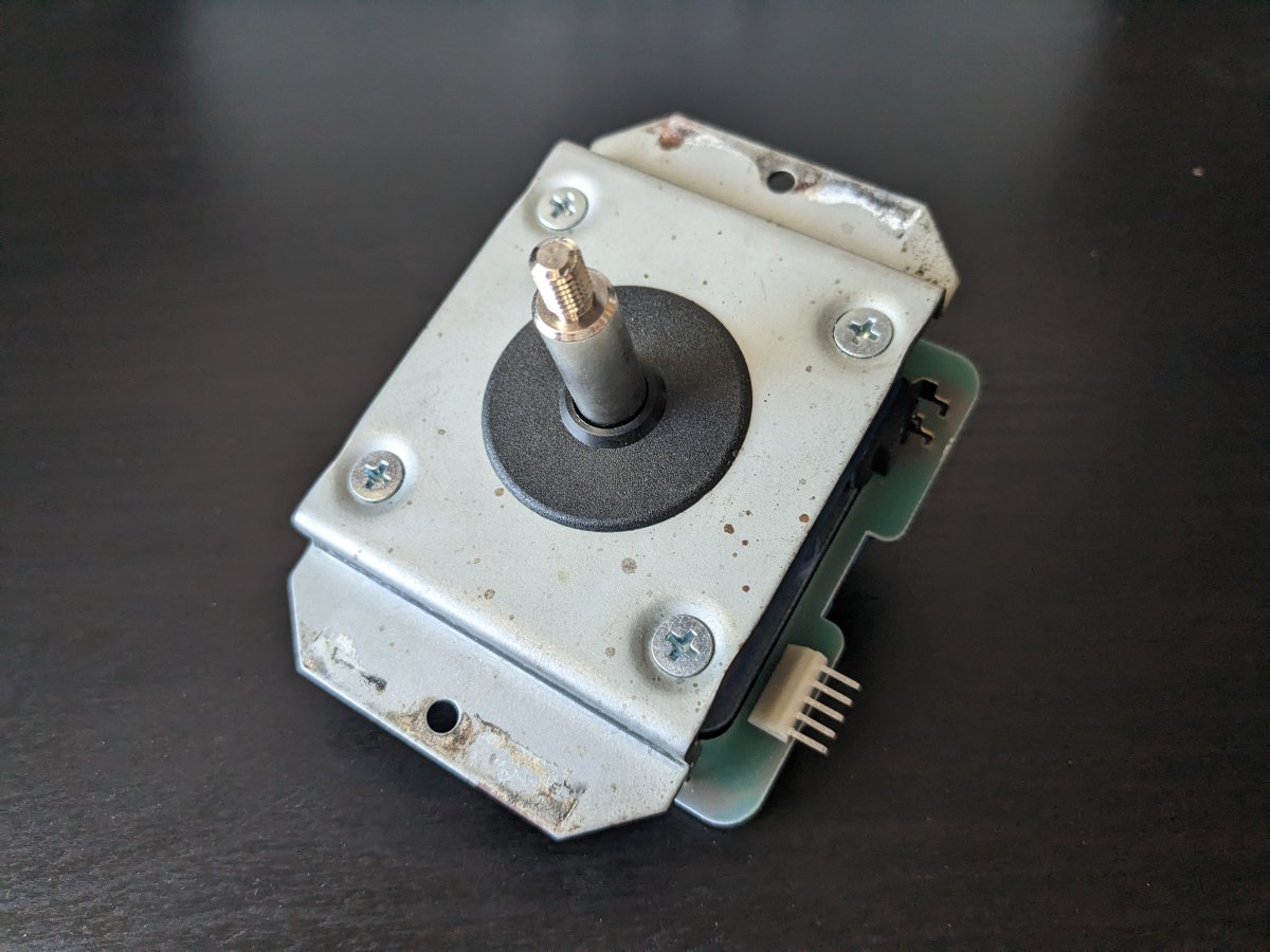

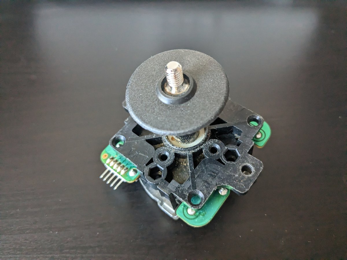

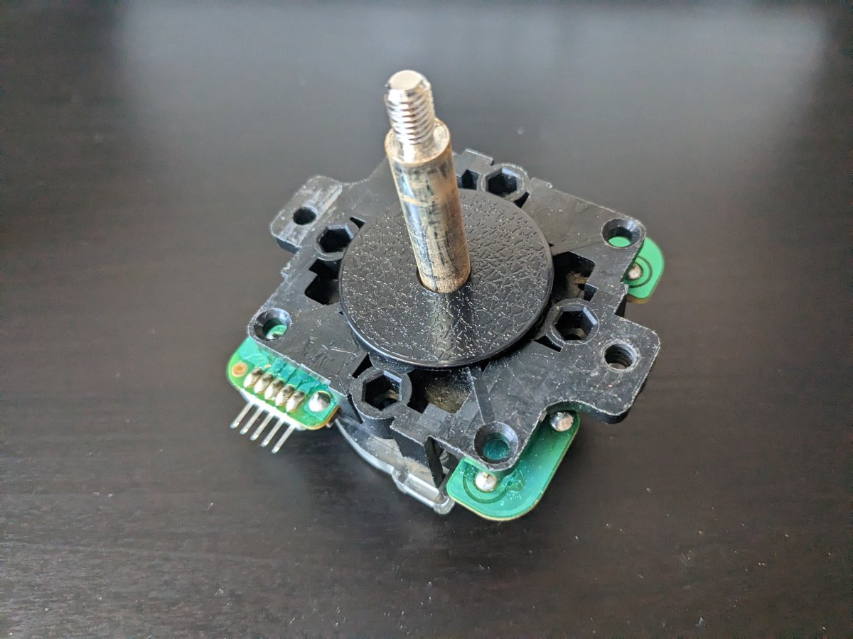

Ca. 2014 LS-32-02 w/ LS-32 Dust Washer
Ca. 1997 LS-32 w/ LS-32 Dust Washer
Ca. 2014 LS-32-02 w/ JLF Dust Washer
Ca. 2014 LS-32-02 w/ JLF Shaft Cover Dust Washer
JLF w/ Normal JLF Dust Washer
JLF w/ Shaft Cover + Normal JLF Dust Washer
JLF w/ Shaft Cover + JLF Shaft Cover Washer
JLF w/ LS-32 Dust Washer
JLF w/Shaft Cover + LS-32 Dust Washer

This is super comprehensive. Thanks for putting this together! Really helpful to see just how the various sizes fit with each other. Looks like the JLF is too small for the newer LS-32-02.
Were you able to try the Older LS-32 w/ JLF Dust Washer?
Older LS-32 has the same shaft. Apart from the switches, the joystick hasn't really changed in 35 years.
Standard JLF dust washers will fit the thinner Seimitsu shafts, like the ones in LS-56 and 58.
