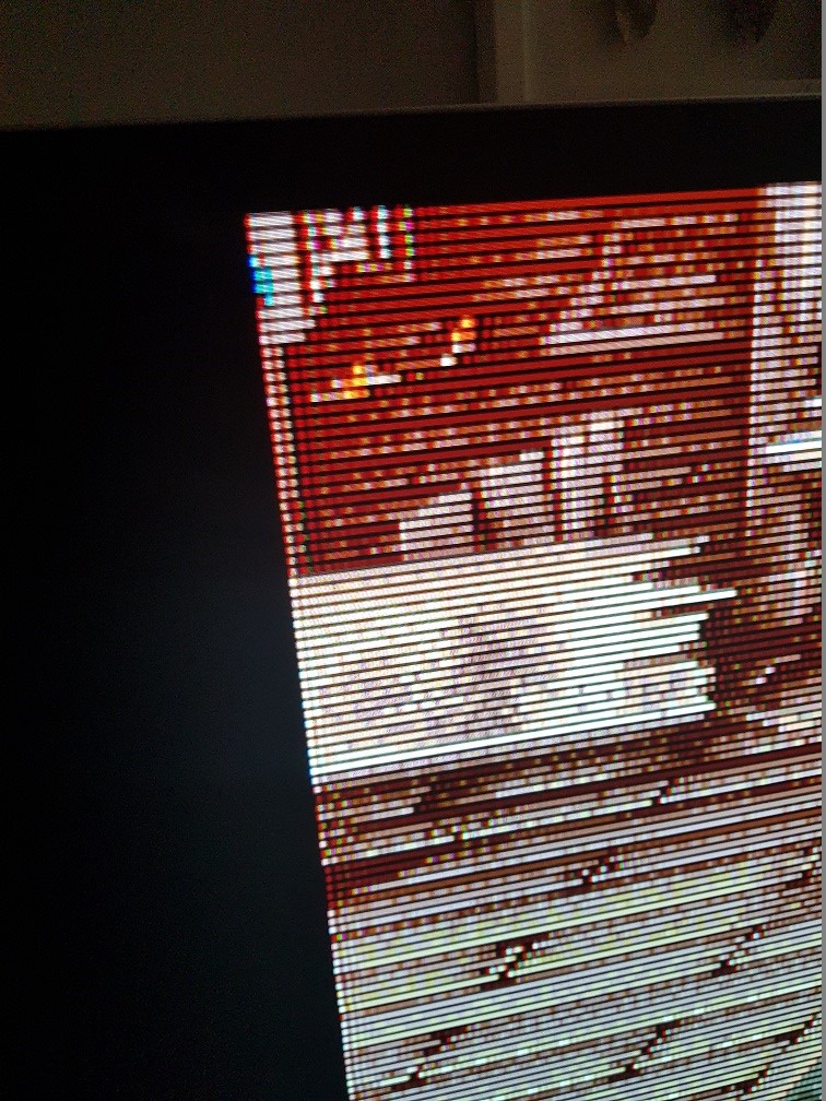

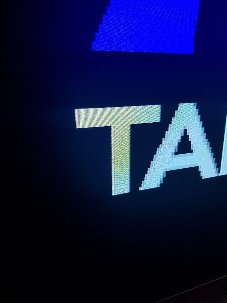

Recently I've been picking up some TAITO F2 PCBs from YAJ but have noticed that the RGB output is some of the worst I've seen.
I currently have both the short and long F2 motherboards and a bunch of games. Ended up with two copies of Runark/Growl which both show severe ghosting and is the same regardless of motherboards.
Liquid Kids still has a little ghosting but not as much as Runark. It has another issue in which the blacks are appearing as grey which is the same issue I have with a Tengai PCB.
Just wanted to see if anyone out there has the same setup and can test to see if it's normal behavior.

Tried both Liquid Kids and Tengai on multiple setups including ASTRO, HAS, Sentinel and KICS 91 through an OSSC and a CRT, all exhibit the same washed out grey backgrounds which leads to a fault in the boards themselves.

The pictures are taken from my OSSC/TV. Haven't had a chance to test Runark on the ASTRO but I will soon. It's strange though, the ghosting is slightly less severe on one Runark PCB than the other which leads me to believe it could be a worn component.

Bumping this old thread because I recently acquired both a Liquid Kids and TMNT boards with similar issues-ghosting and a “faded” look because black doesn’t display a true black. It’s definitely a board issue-only these two boards have these issues and it’s the same behavior across both my SuperGuns and my cabs.
