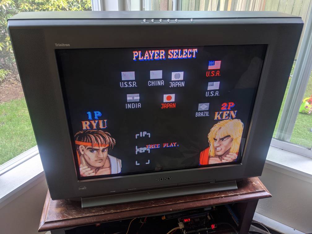

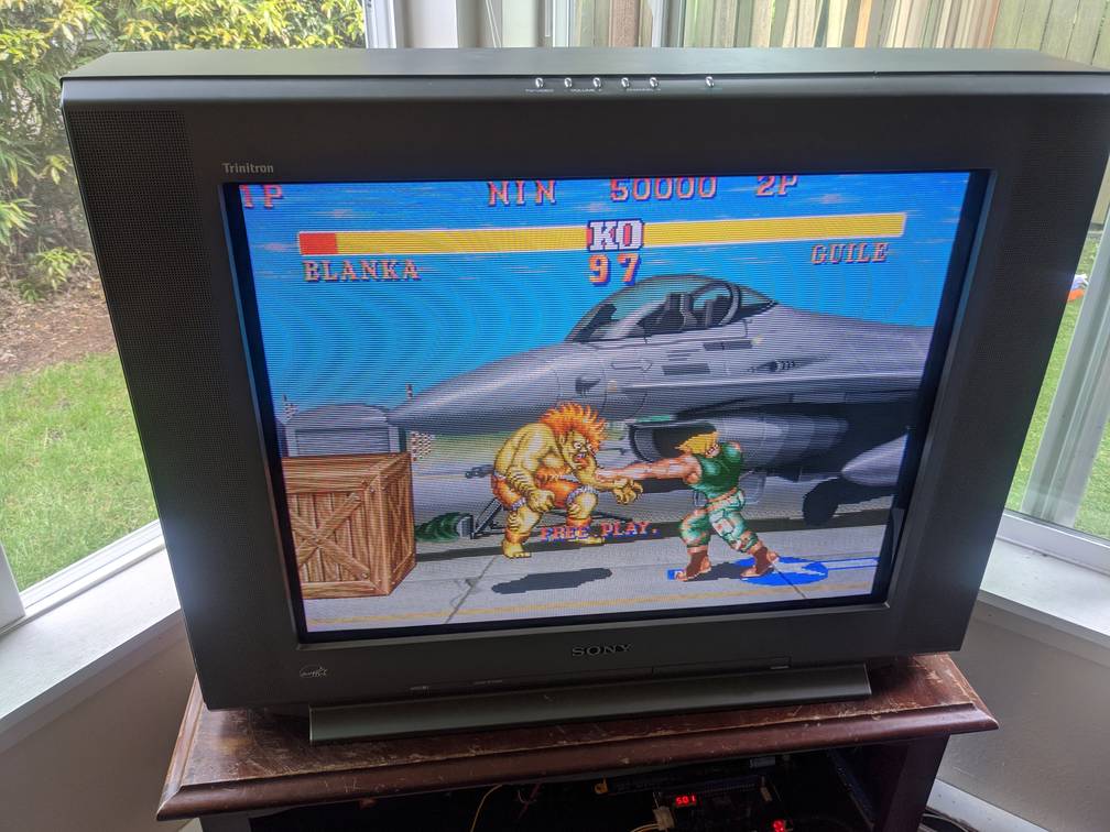

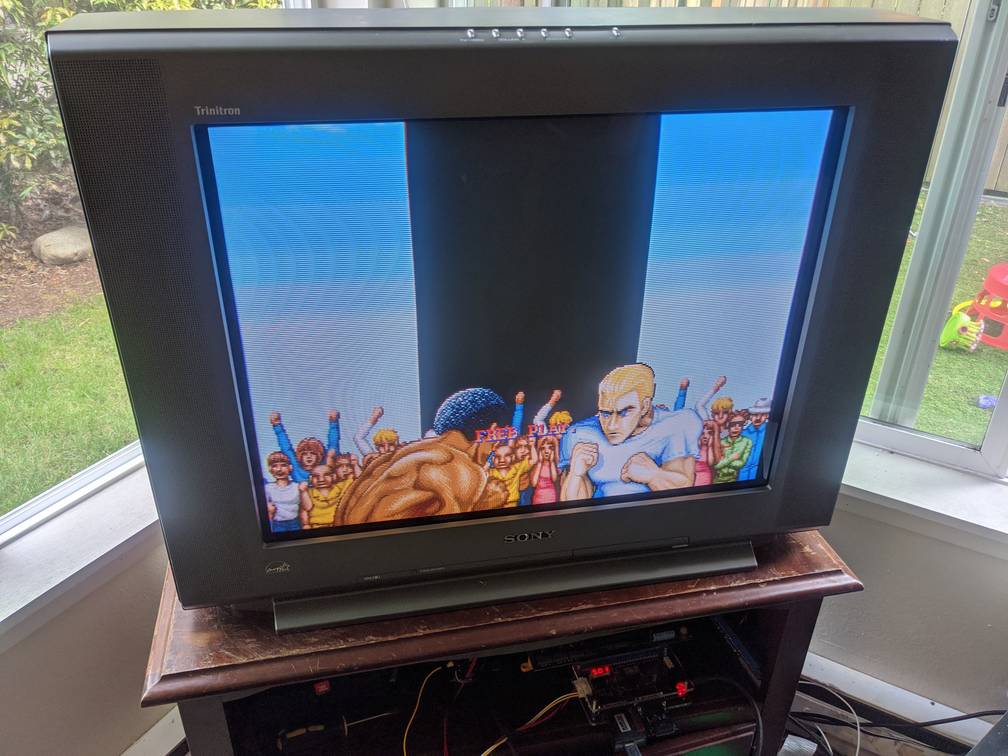

F FakeNoose Enthusiast Joined Dec 15, 2018 Messages 185 Reaction score 59 Location USA May 10, 2020 #1 As the title states I was playing just fine yesterday but woke up to this today. I imagine something just needs a reseat but I don't know where to start. Attachments rsz_sfii_missing_stage.jpg 156.8 KB · Views: 143 rsz_sfii_missing_map.jpg 134.5 KB · Views: 140 rsz_sfii_missing_intro.jpg 144.4 KB · Views: 144
djsheep Multi Boyz Overlord Immortal Multi Boyz Joined May 20, 2016 Messages 8,513 Reaction score 15,878 Location Brisbane, Australia May 10, 2020 #2 Try pushing the connectors of the A and B board together gently while the games is running and see if that fixes anything.
F FakeNoose Enthusiast Joined Dec 15, 2018 Messages 185 Reaction score 59 Location USA May 10, 2020 #3 no change unfortunately. I reseated the boards and then resecured the screws
-Ace- Professional Joined Mar 1, 2018 Messages 528 Reaction score 376 Location USA May 10, 2020 #4 Probably the dreaded "A" board issues. . .
F FakeNoose Enthusiast Joined Dec 15, 2018 Messages 185 Reaction score 59 Location USA May 10, 2020 #5 could I have the HAS setup wrong? causing something to burn out? HAS>retroaccess scart>rgb2comp adapter>TV HAS is set to Csync, 75ohms, audio jamma out and LPF off.
YesAffinity Enthusiast Joined May 20, 2016 Messages 242 Reaction score 150 Location Escondido, CA, USA May 10, 2020 #6 what is 5v measuring at, at the program roms?
