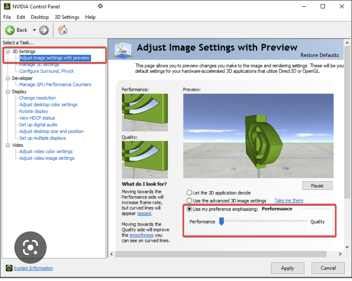

Hi all, I have two PCs set up with the Artax 4.1 Multi - one is a Dell SFF with an Nvidia GT1030 and the other is a Dell Mini Tower with an Nvidia GTX1650. Both are 10th Gen i5, 16GB RAM, with the multi on brand new Crucial 1TB SSD drives.
Everything working beautifully, but the SFV Benchmark is stuck at 30fps on both builds. I feel like this is something I'm missing, a graphics card setting, performance setting or similar. The GTX 1650 in particular should be able to run at 60fps as it's a more capable card than the original GTX660 in my actual Taito TTX3 unit.
Any suggestions?
Have you went into the Nvidia control panel to change the refresh rate to 60hz? If it’s still stuck at 30hz, you may need to do a custom resolution.
Thanks for the suggestion, it was already at 60hz but I found the problem - it was this setting:
Moved the slider across to the left, to "Performance" (it is was defaulting to "Quality") and has been a massive improvement. SFV Benchmark now running at a steady 57-60 fps. Fan noise from the card is a little more noticeable but still not bad.
