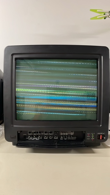

I bought a CZ-612D from Japan few months ago, it was working fine even if the picture was shaking sometimes.

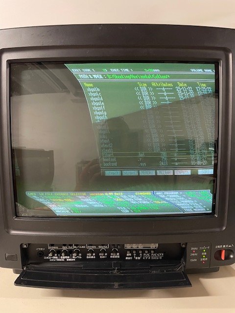

After few weeks the picture started to be upside down, like in the picture below.
I already replaced almost all the caps as well as the TDA without success.
There is no schematics available for this monitor so any help/idea will be much appreciated.
Thanks
Jon

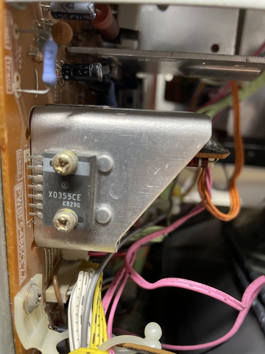

I already identified the vertical deflection transistor which I will test today
