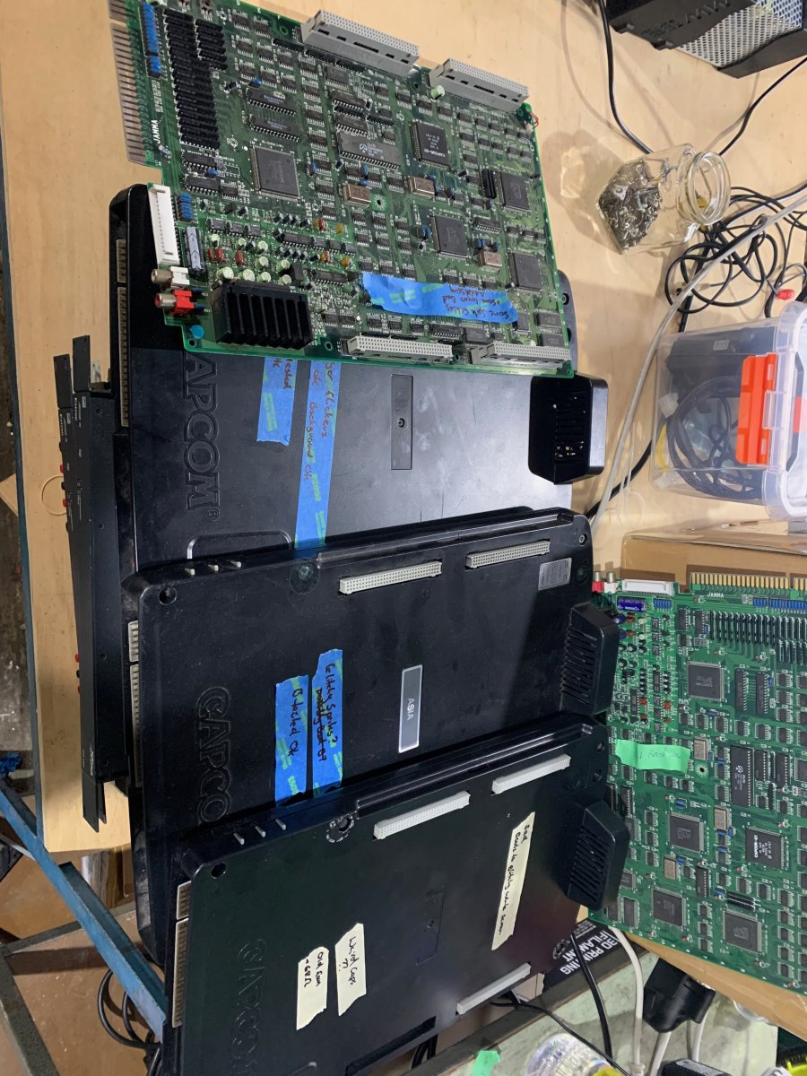

Anyhoo - now I am the proud(?) owner of a massive pile of "Assume broken" CPS2-A boards in various states of disrepair.
USA with shell
USA with shell
USA bare board
EURO sealed shell
EURO with shell
ASIA sealed shell
ASIA in shell
ASIA in shell
ASIA bare board
Next step is to test them and see if any of them actually work - I think this thread may be about to turn into another CPS2 A board repair thread

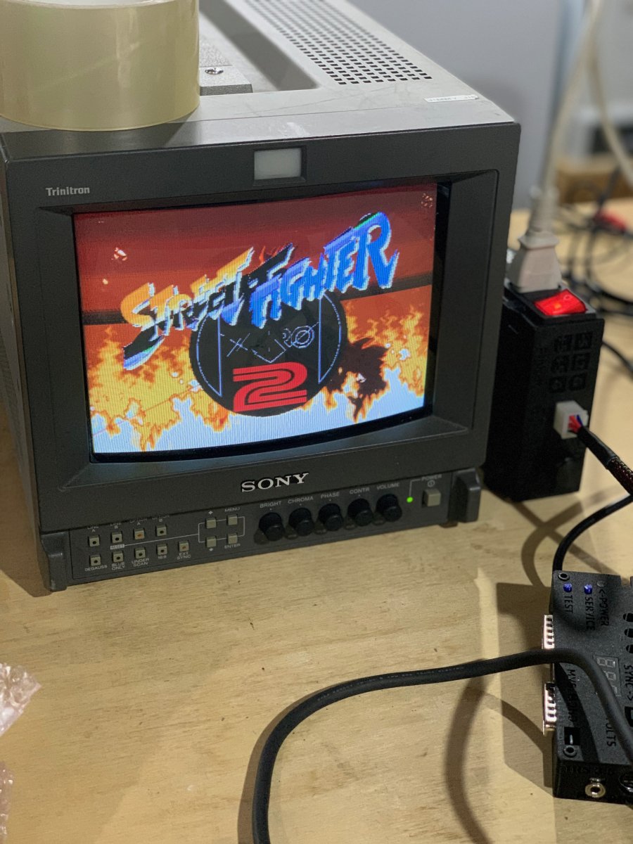

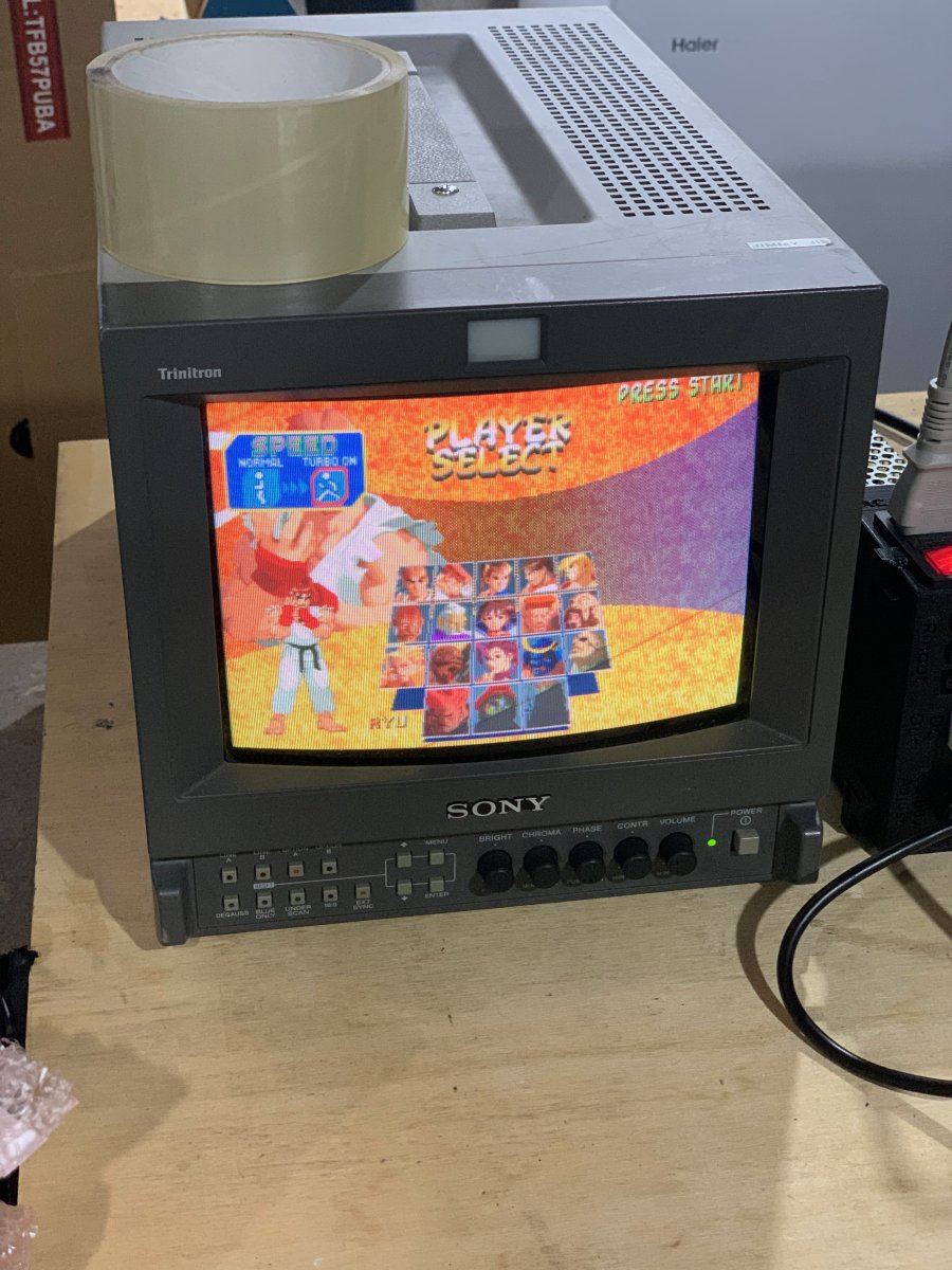

This actually went better than expected
USA with shell = Good
USA bare board = Good

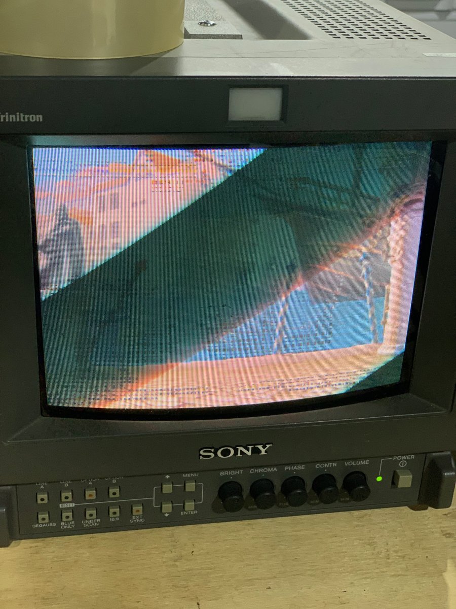

EURO sealed shell = Boots to glitches then solid screen (dead for now)
EURO with shell = Boots to glitches then a solid screen (dead for now)

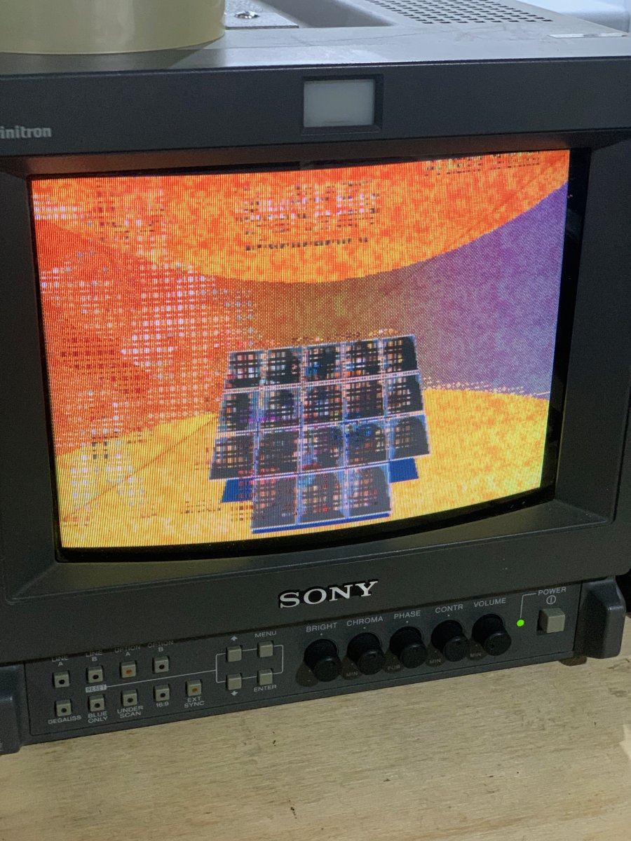

ASIA sealed shell = Works, sprites do not draw correctly, background and sound fine
ASIA in shell = Works, sprite later flickers in a very interesting way, background and sound fine
ASIA in shell = Works, does not draw some
ASIA bare board = Boots to glitches then a solid screen (dead for now)
So the ones that boot to glitches then a solid screen are probably beyond my ability for now - might come back to those later.
But the ones that have graphical glitches do show some promise

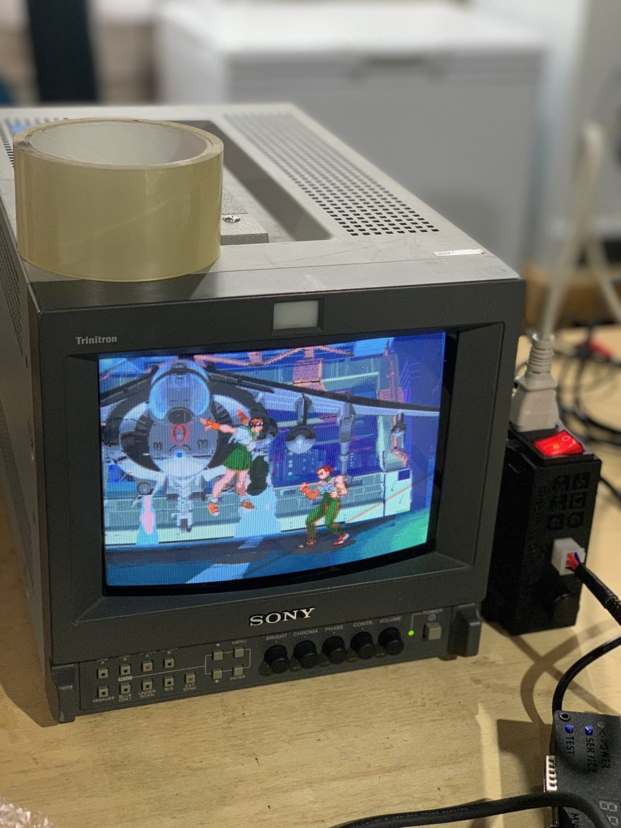

This one has Bad sprites, otherwise fine
Some laters missing/badly drawn, sound dim but OK. In the first pic you can see the word "Alpha" is not being drawn, in the next one some of the detail in the sprites and background is not being drawn
I thought this one had flickering sprites until I took the photo, on the camera screen and in the photo the sprites are crystal clear. Suspect it is not drawing the sprites every frame, maybe every 2/3 frames
