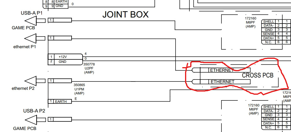

I'm trying to connect two 256 for TC4 co-op. Does anyone have the "cross pcb" ?

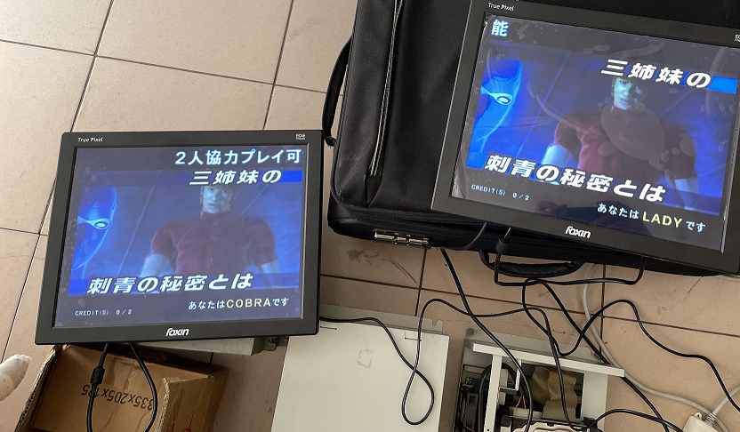

Cobra the Arcade is quiet simple, one network cable is enough.Why cross pcb?

are you sure it's not just a small PCB that converts 2 Ethernet cables into a crossover cable?

The network cable I used to connect Cobra the Arcade is a crossover one with 568B crossover . Time Crisis 4 give me the "LINK MALFUNCTION 1 2" error by using the same cable.
PS: 568A crossover cable has been tested, "LINK MALFUNCTION 1 2" error.
Or is there a special way for TC4 to crossover? I can't find any switch for link in TC4 test menu, the cross pcb have one?
