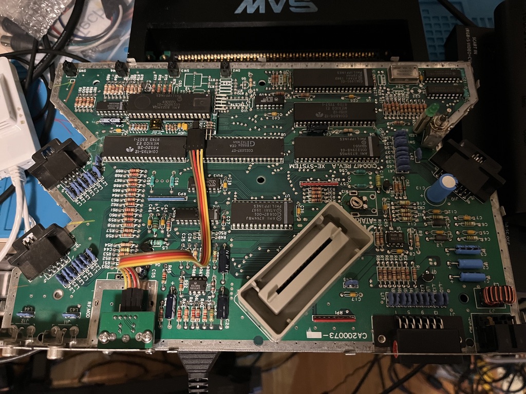

So tried an Atari XE system I recently modified with a S-Video connection and it works great. So the issue is clearly the source... will try to dig out some more RGB systems to test with.
