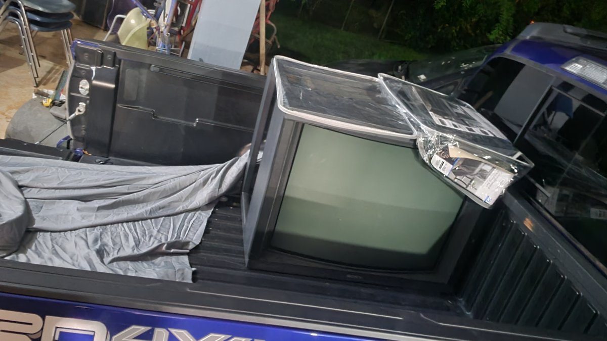

Just bought this PVM for a 100. Got the flyback hissing but looks good when turned on. Any advice would be appreciated.

My advice is: don't make assumptions. The flyback is so rarely a culprit in most monitors for just about anything.
Have you opened it up yet?

Normally hissing noises are coming from the anode cap where it connects to the tube, replacing the dialetric grease can help. or from vibration of the big power conditioning caps on the power supply - many power supplies suppress the vibrations by gluing them

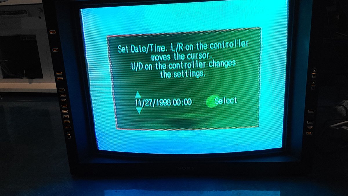

Added a foto turned on. Hissing gone down bit. Will probably buy a atv Jack to put this on a work beach. Very heavy.

That image has a lotta wobble, and looks like the degauss didn't trigger. All in though, shouldn't be a hard repair, these were made early enough in the PVM line that they're easy to work on still. I'd start with recapping the power board in its entirety and see where you're at then (make sure and use low ESR caps).
