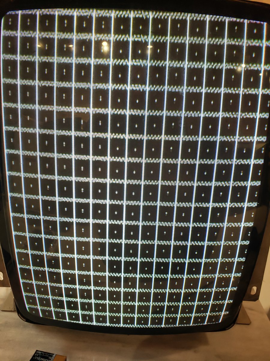

zero238 Grand Master Joined Nov 3, 2015 Messages 1,118 Reaction score 657 Location Raleigh, NC Oct 5, 2021 #1 Don't know the actual term but the vertical lines are constantly moving. Didn't check before hand how it was before changing the caps unfortunately. Its on a k7000 chassis that I was planning to put on the mini cute Attachments 20211004_195157.jpg 301.1 KB · Views: 102

Plymelk Student Joined Oct 15, 2018 Messages 91 Reaction score 87 Location Kathleen, Georgia Oct 15, 2021 #2 Looks similar to what I had on a K7000 tube swap for the mini cute. https://www.arcade-projects.com/threads/building-arcade-cabinet-technical-thread.17718/page-3 FG jumper to logic ground on the PSU worked for me.

ItsBobDudes Grand Master Joined Dec 21, 2019 Messages 410 Reaction score 714 Location Andover, MA USA Oct 15, 2021 #3 Your dag wire is connected to chassis ground, yes ?
