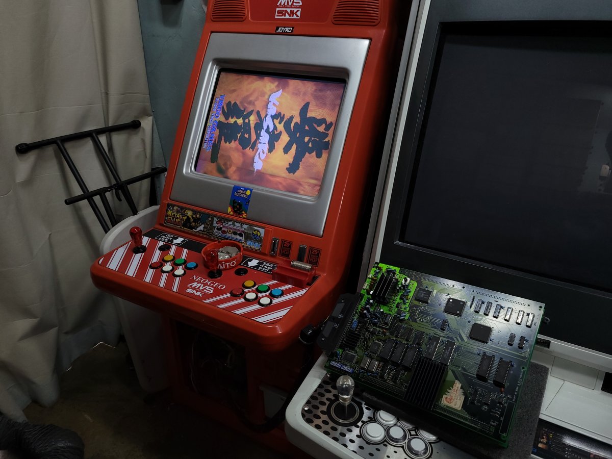

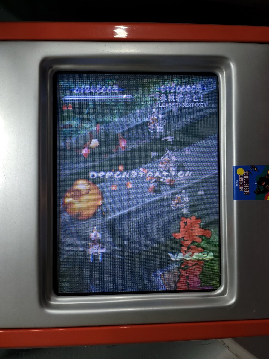

I converted VASARA / VASARA 2 with VISCO-JJ1 Rom board.
If you can get VISCO-JJ1 Rom board, you can make it to VASARA or VASARA 2

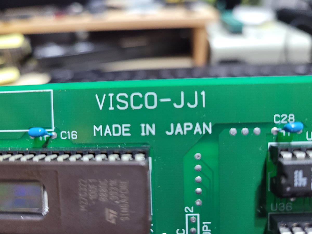

You can get VISCO-JJ1 Rom board from
-Gourmet Battle Quiz Ryohrioh CooKing
-Koi Koi Shimashyo 2: Super Real Hanafuda
-Lovely Pop Mahjong Jan Jan Shimasho
-Lovely Pop Mahjong Jan Jan Shimasho 2
You need EPROMS and Gal16v8
M27C322 - 8EA
M27C160 - 3EA
M27C4001 - 2EA
GAL16v8 - 2EA
*M27C322
a0 → u13
a1 → u14
b0 → u16
b1 → u17
c0 → u21
c1 → u22
d0 → u34
d1 → u35
*M27C160
Data → u28
s0 → u29
s1 → u30
*M27C4001
prg-h → u27
prg-l → u26
*Gal16V8
u25
u36
