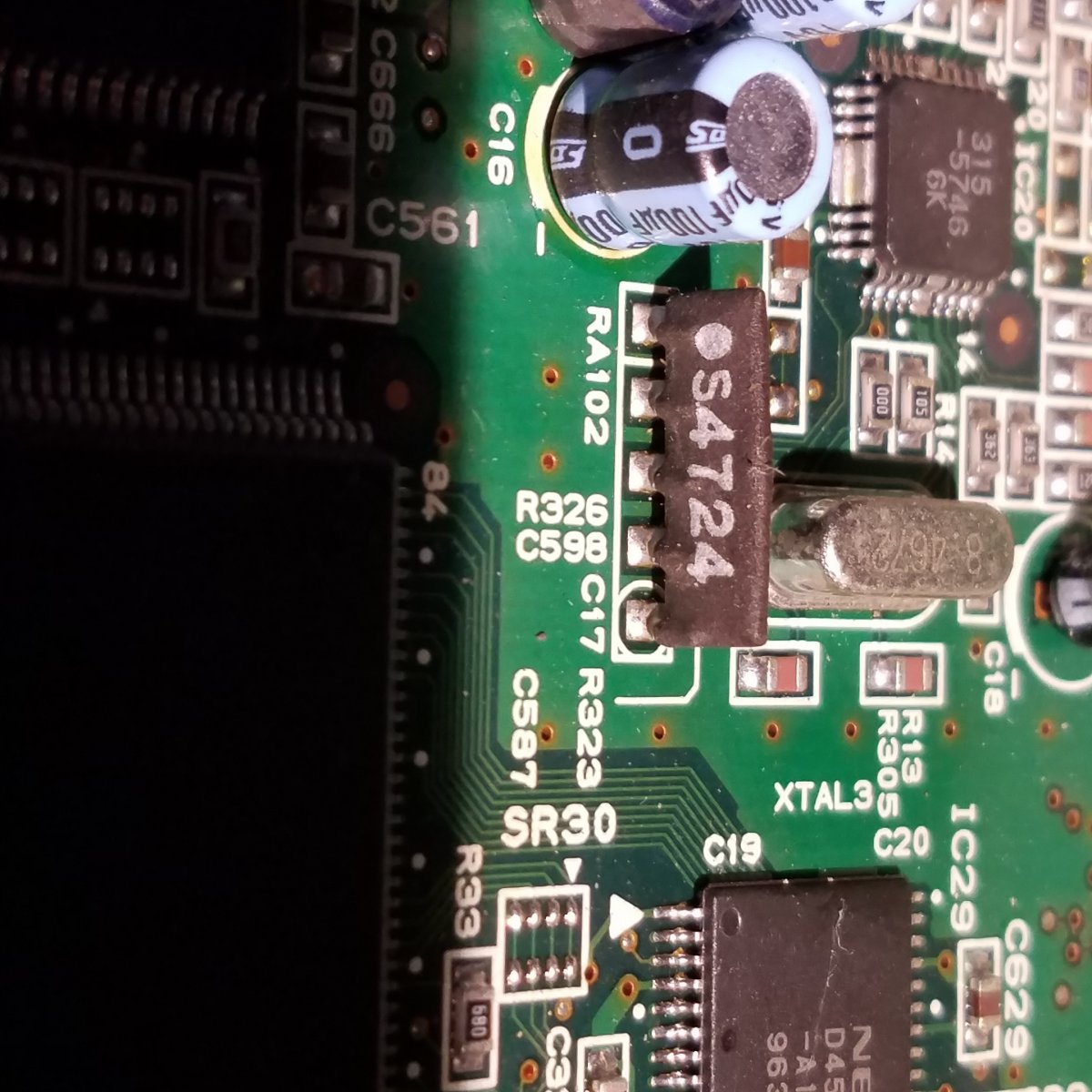

Could you please tell me what array this is? I need to find a replacement. I had one break off. I also have that diode where r100 is. Why would someone do that? Also my HD6417095 SH-2 has 2 broken pins. Can i removed one from a donor Saturn? Thanks
I do not have Idea of what is the °S4724, I think that you should find a donor motherboard to pick it.
I suspect that the diode in r100 came in various board: in photos on the net I saw the same thing. "Why would someone do that?" is also my wonder.
