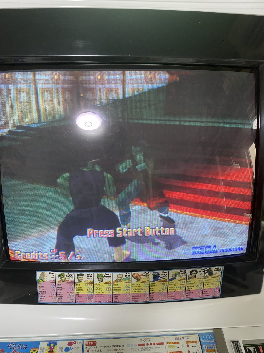

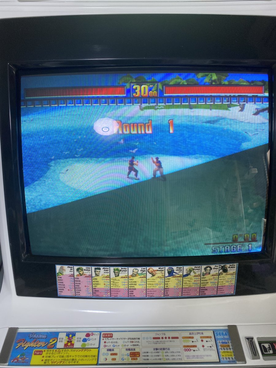

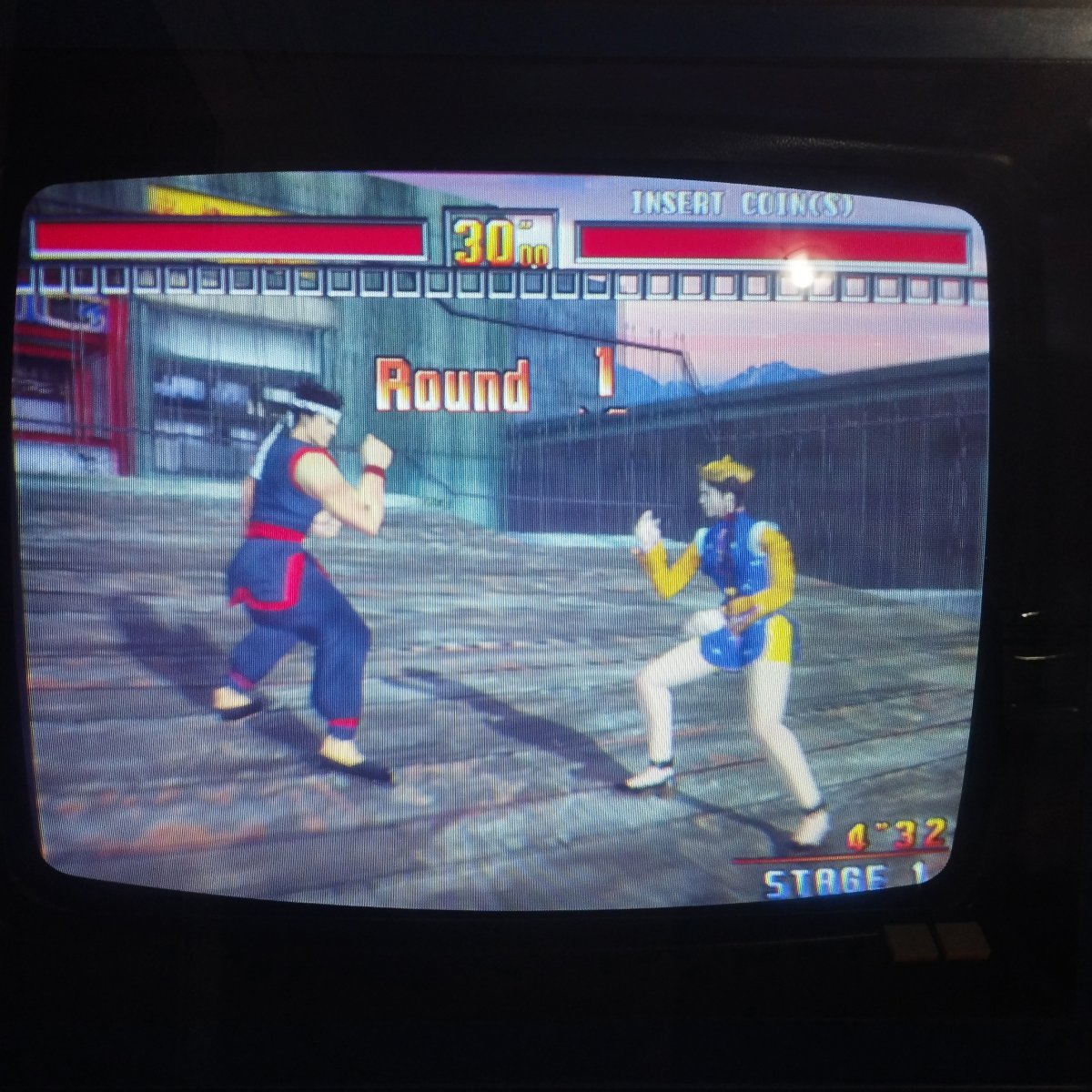

The game accepts credit but does not enter the service menu, not even through the PCB buttons.
The number of rounds is infinite, the fighters' life bar is zero, one hit and you lose, after starting the game he stays in the same fight infinitely, you can see that for a few moments the game is in slow motion.

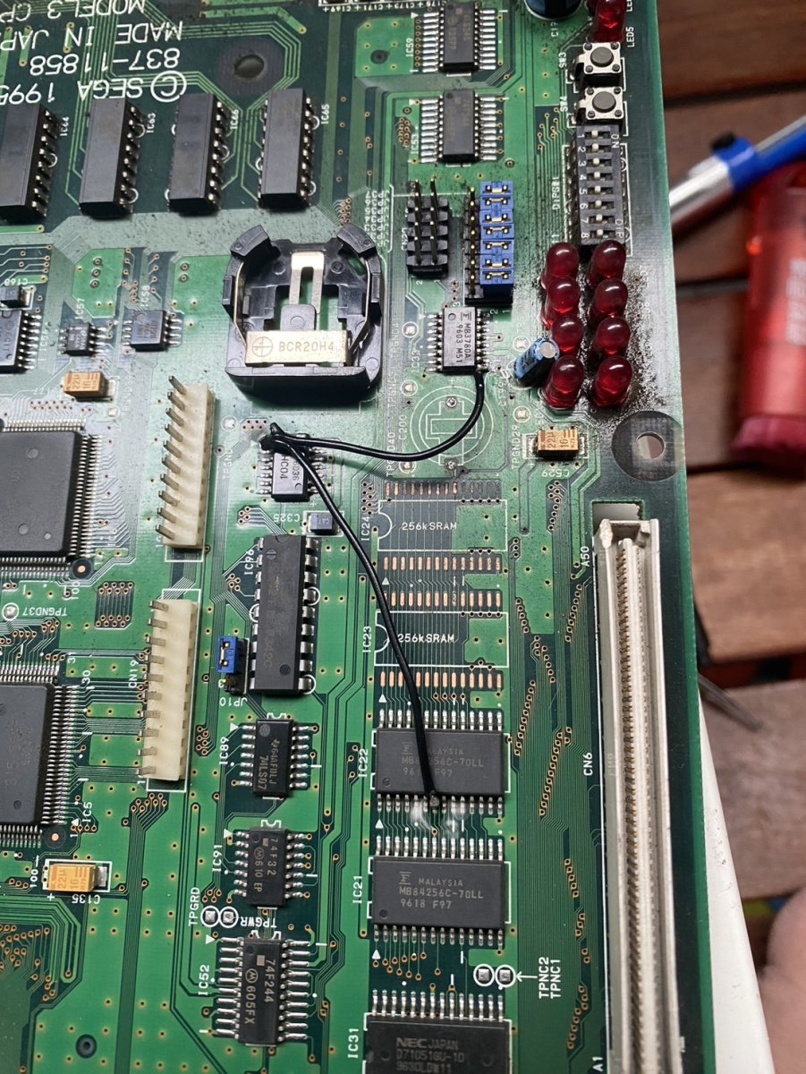

The cause of this problem is corrosion caused by liquid leaking from the 'c200' supercap.
'PIN22' of IC22 - 'PIN9' of IC33 - 'PIN1' of IC84 All three points must be electrically connected, but if any one of them is disconnected, it will fail with the symptoms mentioned.
If you check the short circuits of the three points I mentioned and connect them all with wires, the problem will be resolved.
Fixed the 3 CPU Boards, two just a good cleaning with alcohol, one had to make bridges.

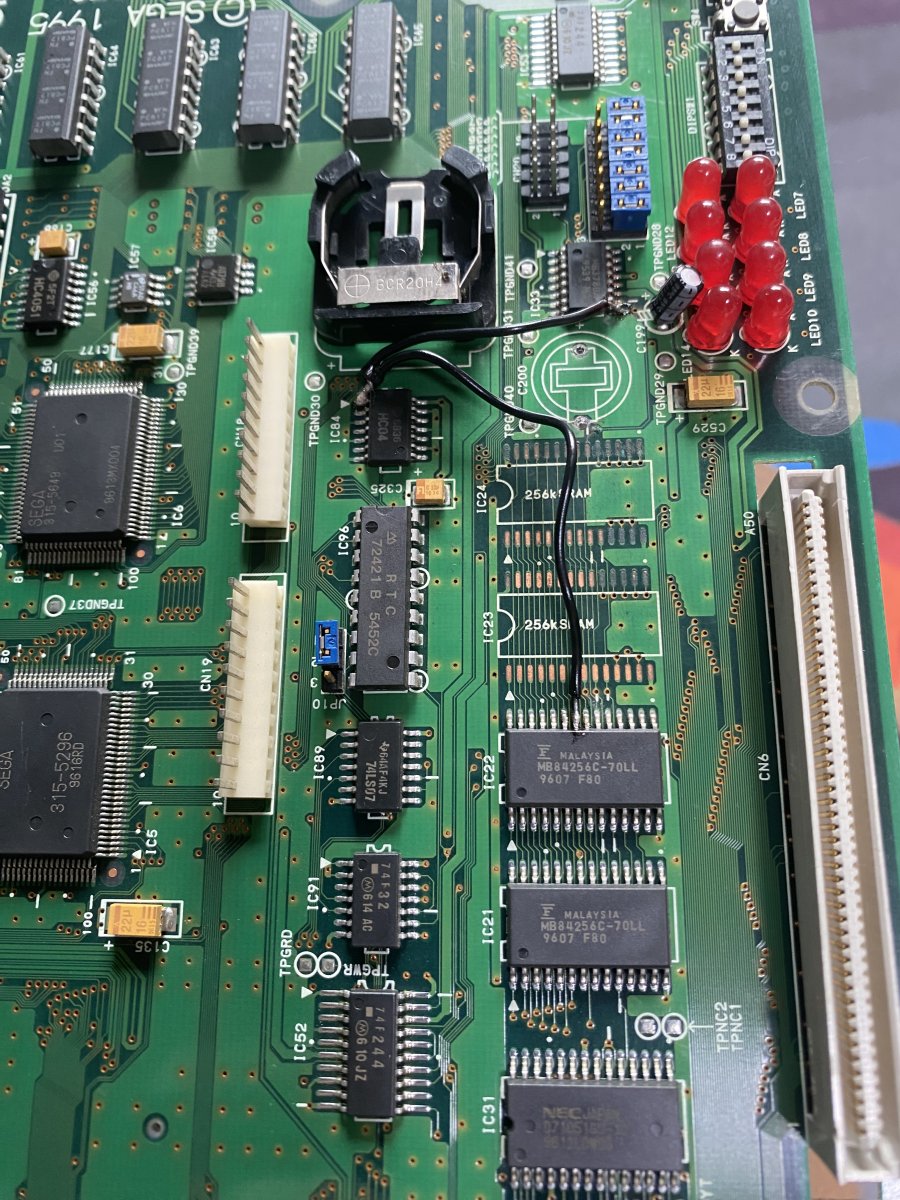

Hi Waiji,
My 2 cpu boards have the same issue and I have followed your instruction and connected the 3 points with wire (please see the attached picture).
I had bad luck. it doesn't work. Have I missed anything?

Hi man1aco, could you please share what pings you made connection to fix the issue? it seems you connected IC33 Ping 9 with IC24 Ping 20. Not sure what you have wired on the back side of the PCB. Thank you!

Please check ic22 again. You now connected to 7pin instead of 22pin.
The wire in the back is to fix the broken trace near the right side of the super cap solder hole.
If yours pcb trace is ok you dont need it.
Yours pcb trace seems a bit rot, you should test continuity.
Got it. Thank you for your suggestion. Let me test the trace as well.
I just reconnected the wires and used a meter to check and make sure the 3 points are connected. Still having bad luck. The issue is still there :\
Try removing your wires and just link IC33 to IC24 pad , as I did.
It works! I saved 3 cpu boards. Thanks man.
