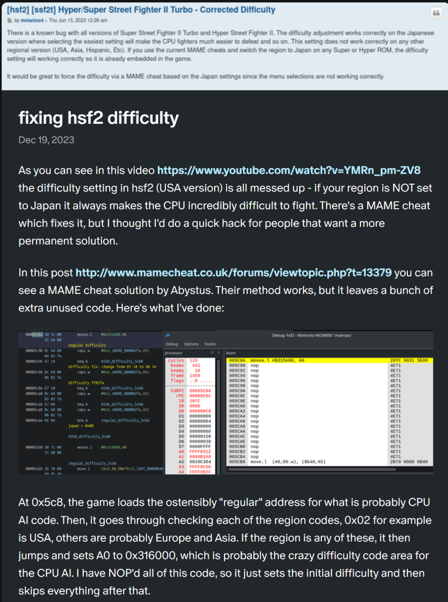

I am sure everyone knows that SFII AE has a "bug" that is present if you use any region other than Japan where the AI doesn't care what difficult setting you use. It will always be EXTREMELY difficult.
There is a person who has been working on a "patch" to correct this over on patreon.
https://patreon.com/bankbank?utm_me...mpaign=creatorshare_fan&utm_content=join_link
I have been talking with him and he has created a Darksoft compatible version of the patch. I tested it and it appears to be working.
In this first link you can see how quickly my official beta tester loses. My dad has very little experience with SFII.
View: https://youtu.be/BDoE02HbEhs
Here it is after the patch is applied. He actually wins.
View: https://youtu.be/ffQiGbJAwyM
