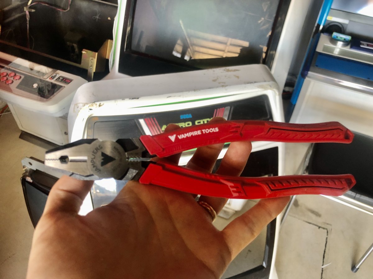

I have the solution for you, and it's cheaper than a Dremel and something you really should have in your kit for these kinds of problems, arcade or otherwise. Vampire Tools Vampliers, they'll grab the screw head from the side and let you twist it out with all the force necessary.

that looks just like a Klein lineman pliers...what's "special" about these?
Don't get me wrong, I don't need an excuse for more hand tools...
They're not like lineman pliers, they have teeth meant for gripping the heads of screws at the end of the jaws. Click the link to their site for photos and illustrations that show what I mean. I realize my photo isn't the clearest, just grabbed the pair off my work bench and took a quick shot.
The PZ-55 doesn't actually have the exact same style of teeth either, though it looks closer.
Regardless, I'm sure there are multiple tools that work fine, I'm only recommending what I have personally. Never seen the Engineer ones and can't comment on their efficacy. The important thing is realizing that there's a class of tool out there for solving this problem in the first place, because it's something most of us run into eventually.
