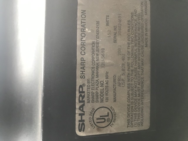

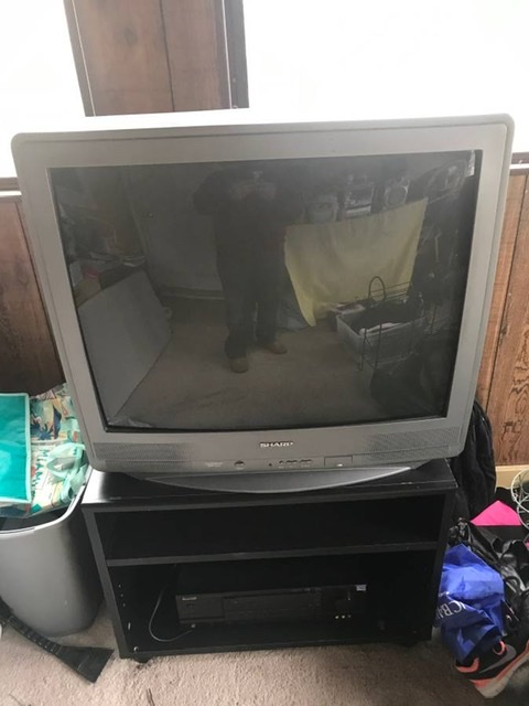

Excellent job, I may have to do this myself soon. I’m eagerly waiting on my chassis to be repaired before I know if my tube is dead. You mentioned that you’re able to tell from a pic if the curvature is correct. What do you think about this Sharp from 2003?
The curve of that TV looks about right, however, that looks to be a 32" TV rather than a 27".
